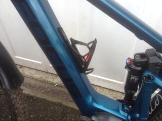

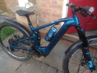

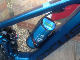

I have a a couple of requests for pictures of the e-BooZ fitted to my Focus so here they are.
The first is just show the bottle cage attached directly to the bike. I didn't use the adaptor plate that came with the TEC pack.
I did modify the bottle cage (plastic) to allow the battery canister to sit flush and more securely. I also used a re-usable zip tie to hold the battery canister firmly in place.

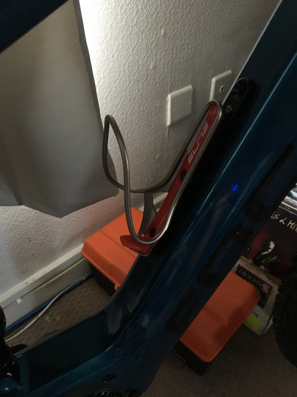

How much 250 wh eBooz pack weights? I'm thinking about getting one and a good bottle cage that is strong enough to withstand impacts. Focus bottle cage mount should endure a lot of beating so that's not worrying.
Jam2rider68
Sep 24, 2019
47
56
Tewkesbury
According to e Booz they recommend elite metal cages as they found these very tough. Got mine on ready for battery arrival ??
