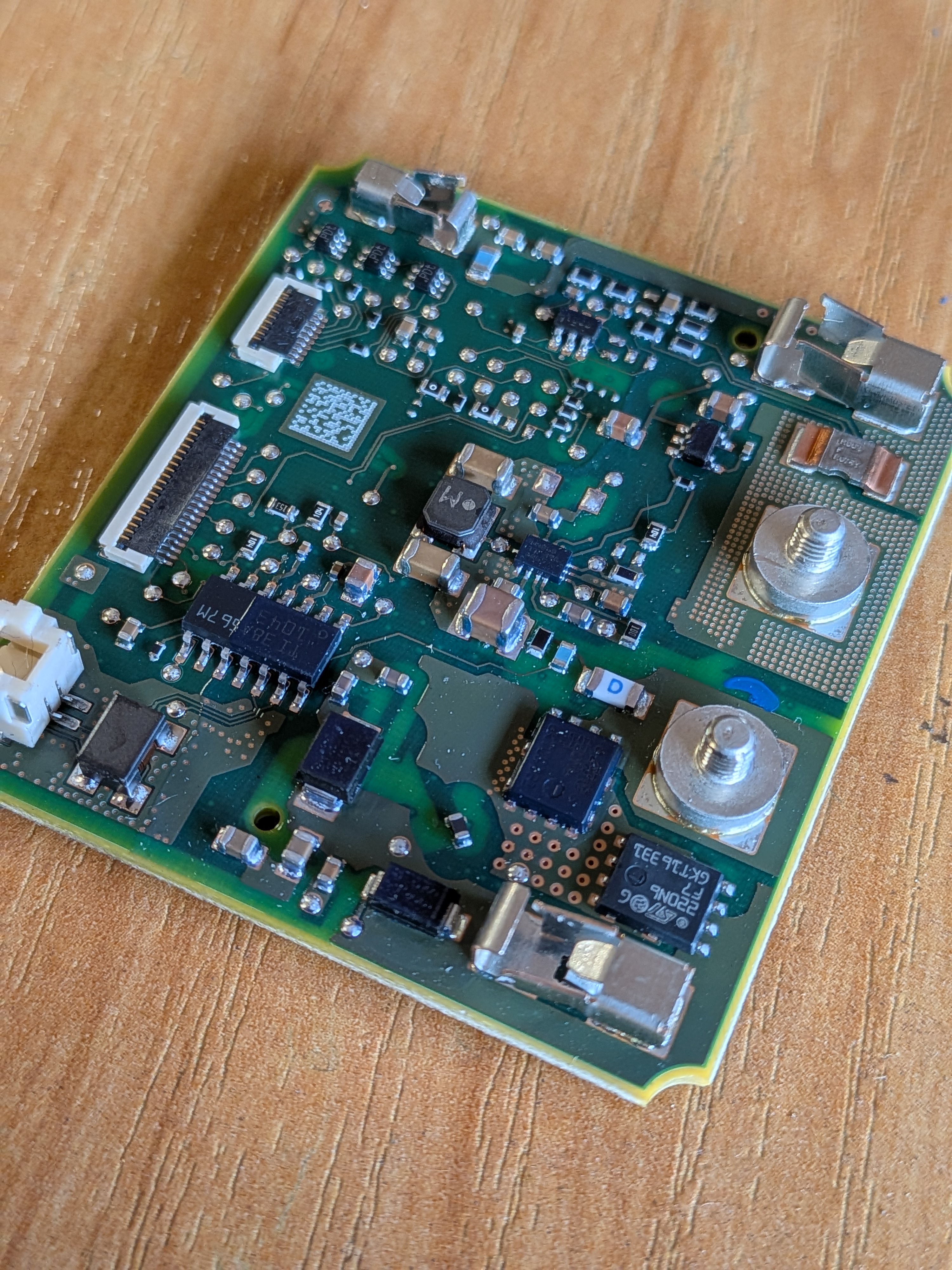

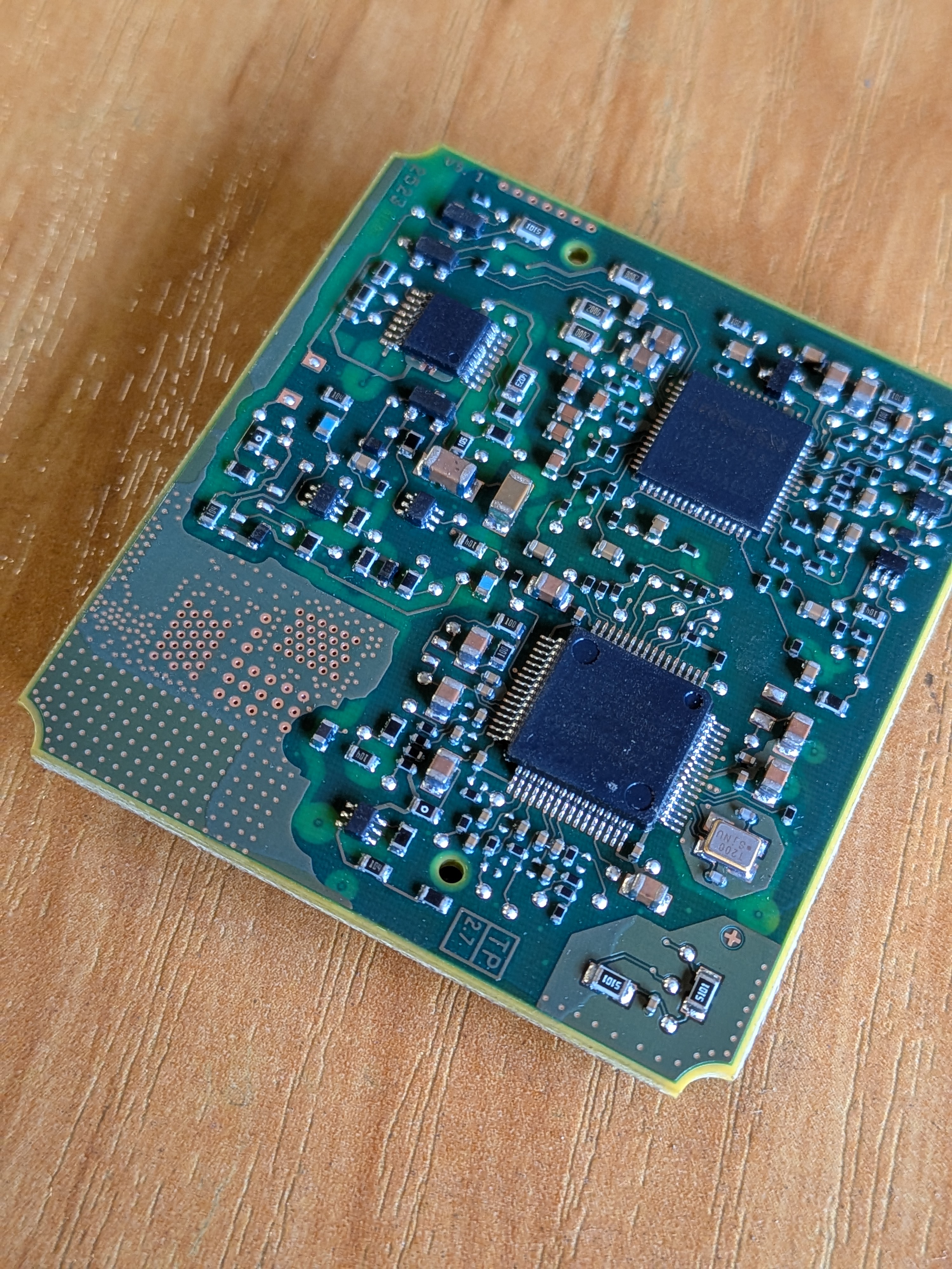

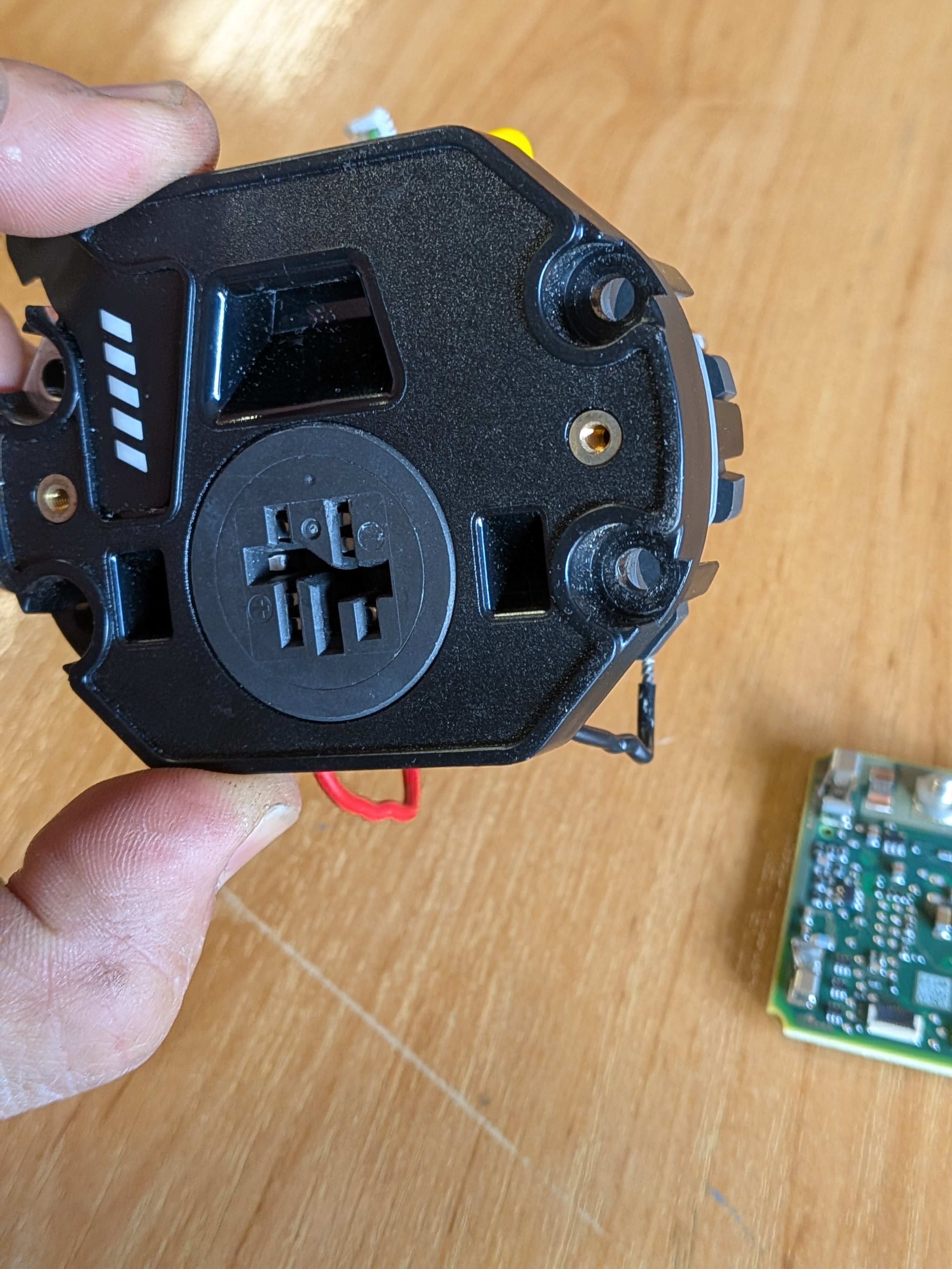

We now have the 750 powertube battery ready to be disassembled; the first challenges lie ahead.
Thank you for the update on this interesting project.
What is that circuit board in the last two photos? Does it come from the battery? Wouldn't the BMS also be stored on it? I understood from the previous posts that the BMS must always be supplied with power. That doesn't seem to be the case here. Isn't that necessary anymore?

That's not a requirement for Bosch BMS. But on other manufacturers, the firmware on the BMS can lock, preventing further use. But even so, there are ways to prevent locking when disconnecting the BMS board from the battery pack.

Hello, I'm currently very busy with work and have little time to dedicate to the battery. At the moment, I have the BMS disassembled. The next step is to disassemble the cell pack to extract the temperature and voltage sensors. Once I have all the components, I need to disassemble the bike to measure the battery mounting points. With all this information, the complete battery design will be created. I will keep you updated on the progress.
