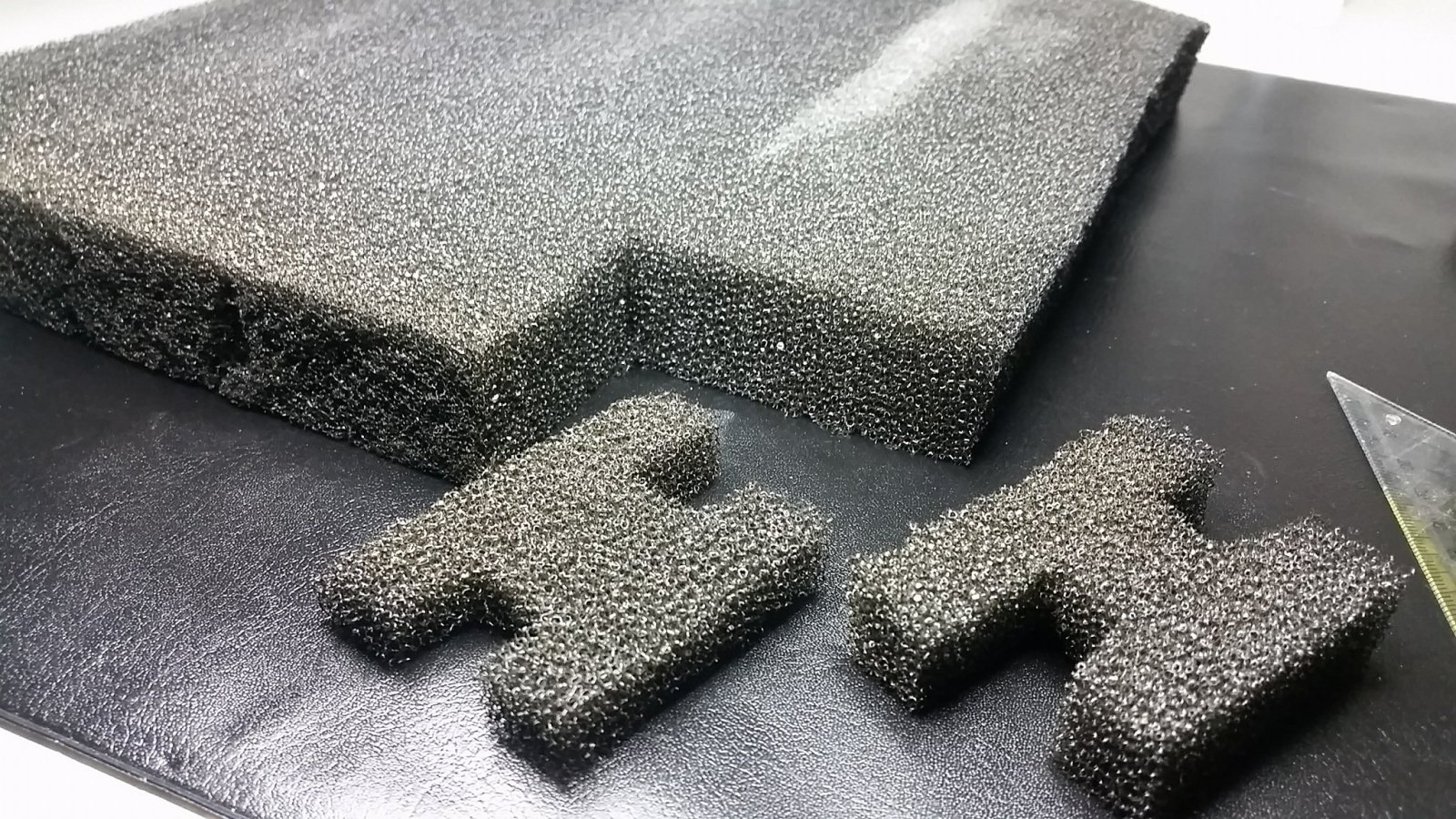

It is really not that hard to find this foam and buy it for a few $.
I found this big piece and my friend confirmed it, that Specialized use identical material.
So, why wait for something, that you can do it your self and you can learn in the process, how you would maintain this in the future. ;)

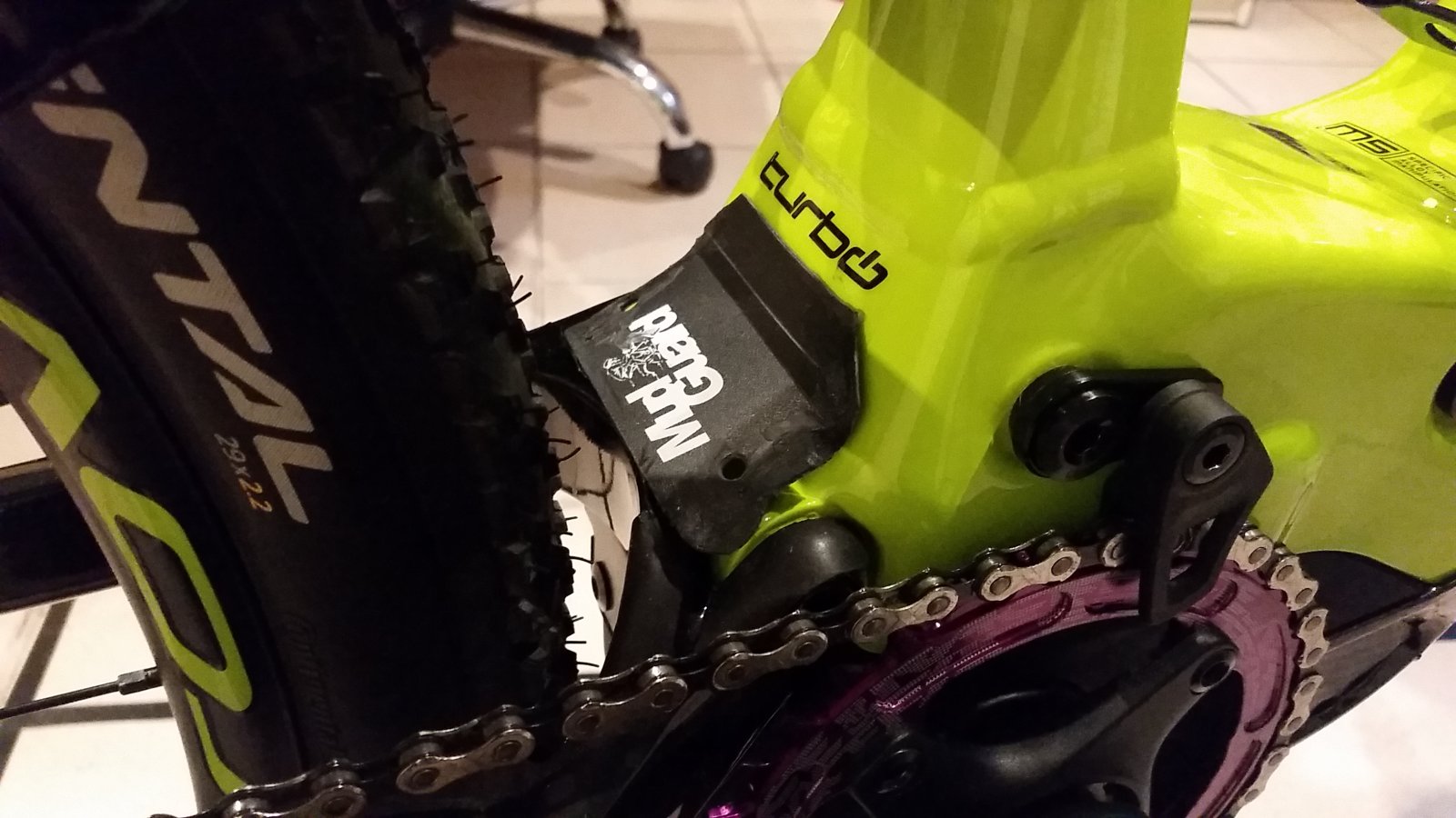

Regarding extra protection back there, there are lots of clever solutions from users.
This is mine, even though the bike will not see mud anytime soon. :ROFLMAO:

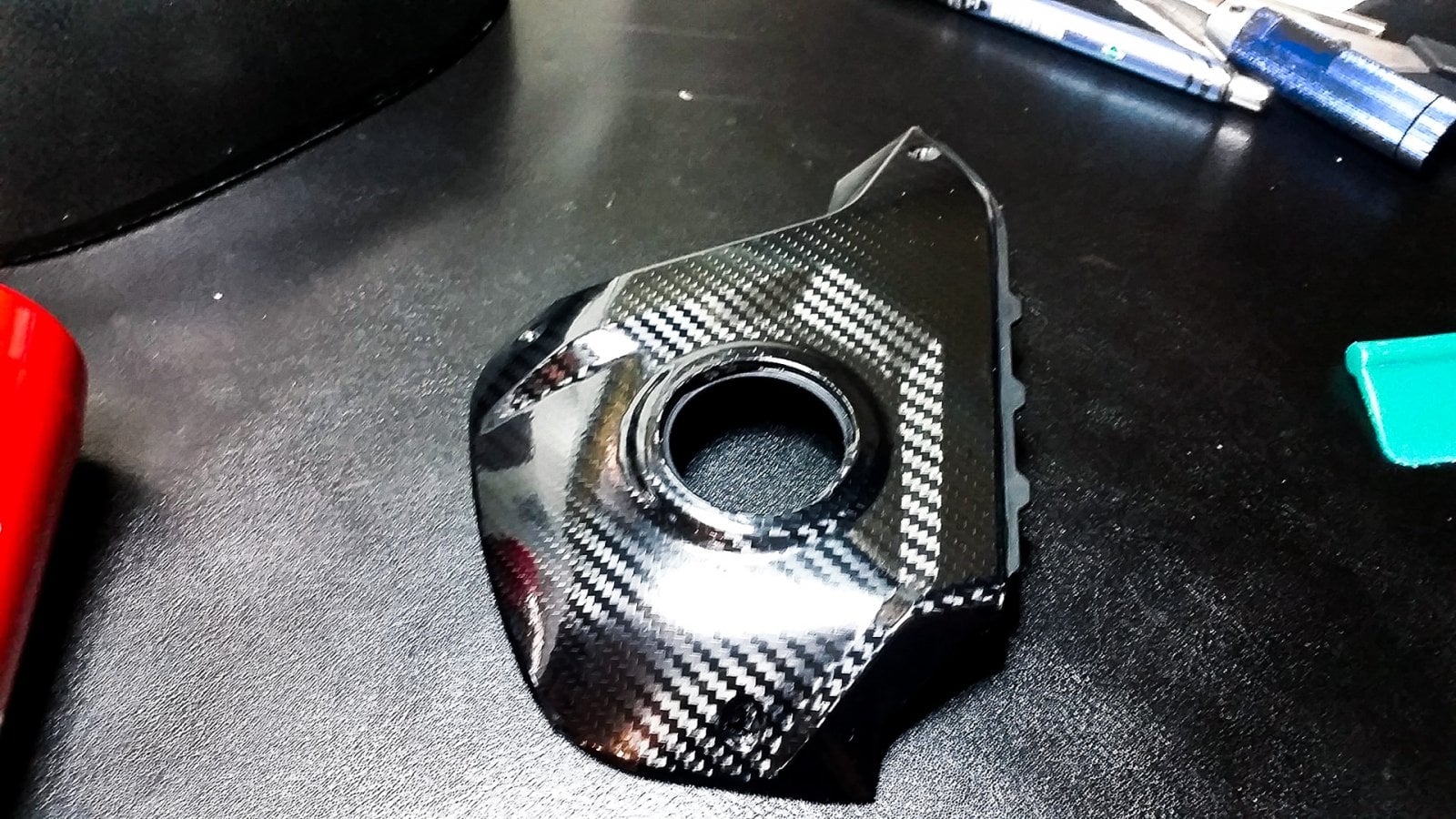

Well If you have some basic skills, I suggest that you do that. Why?
Because this has nothing to do with opening the motor as you think. First you have to remove non drive crank arm with allen key. Than you just remove the left side cover, which is attached with 3 bolts.
It cannot be more straightforward than that.
You will now have the access, so you can fit the foam. More importantly, you will have to clean and check the compartment more regularly than you think, even with foam and mudguards. Some debris might get in during the year.
Better to be safe than sorry and checking this bottom motor compartment regularly. Why taking the bike to the shop for small job like that, if you can do it your self, especially because personally will check this regularly.

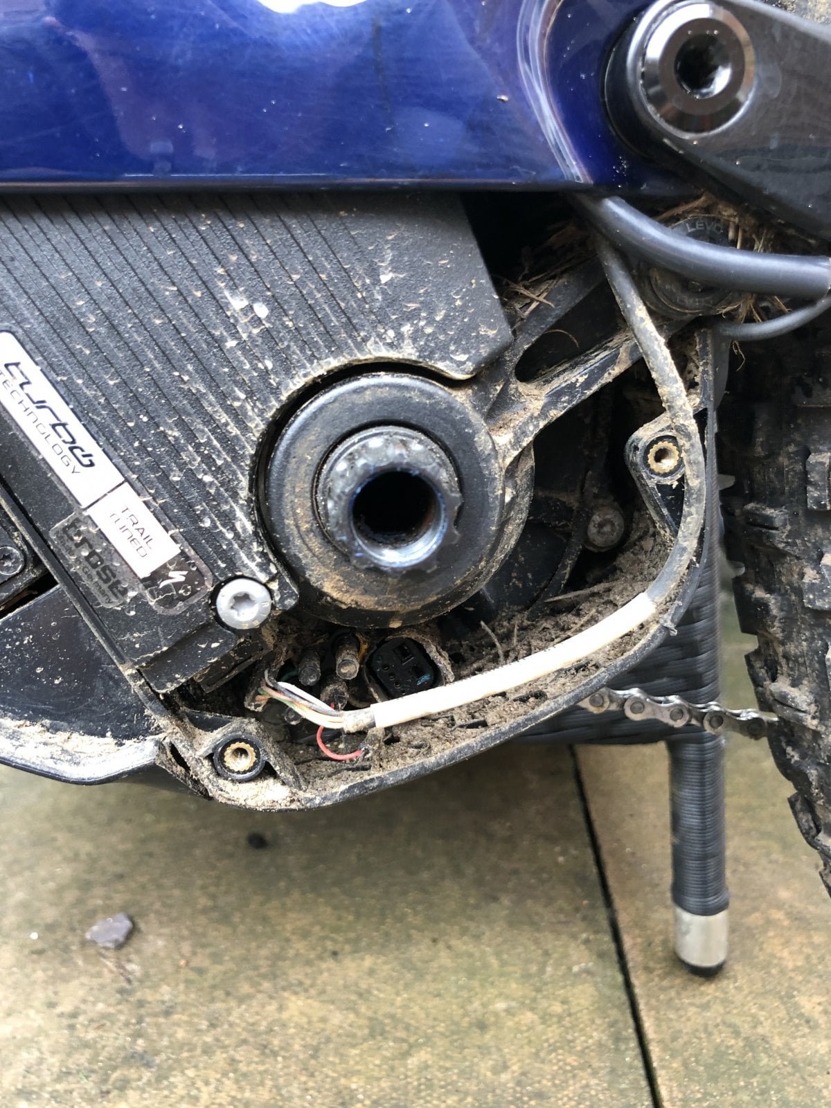

After 4 months of ownership I took my motor cover off for the first time.
No sponge by the way. Standard original 3 Bolt cover.
Not too bad considering what I’ve ridden the bike through.

My guy also told me that the motor have to be removed. But as you can see, with normal to small fingers and help with small screwdriver or something similar, you can easily put the sponge behind the motor into the position, not removing anything.

Looks to me like a log jam of debris at the entry point has prevented any inflow of debris into the motor housing. I hope you didn't clear the log jam (natures filter) ;)
I live in SoCal as well. My LBS has bee very good about taking care of any issues. Your LBS can order the foam pieces for the rear of the motor cover through their regular online specialized order system. The 4 bolt cover needs to be ordered through their local specialized rep. Here are the part numbers;
Foam Inserts part # S199 900 058
4 Bolt Motor Cover part . # S194 200 013
I was surprised to see how intricate the foam insert is, lots of angles.
Hope this helps...
