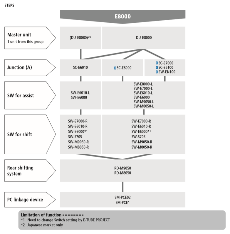

This is the latest compatibility chart if you have the E8000 motor if you're interested. DU-E8000 is the drive unit and SC-E7000 is the screen - you can see the bluetooth symbol next to it.
