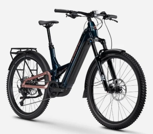

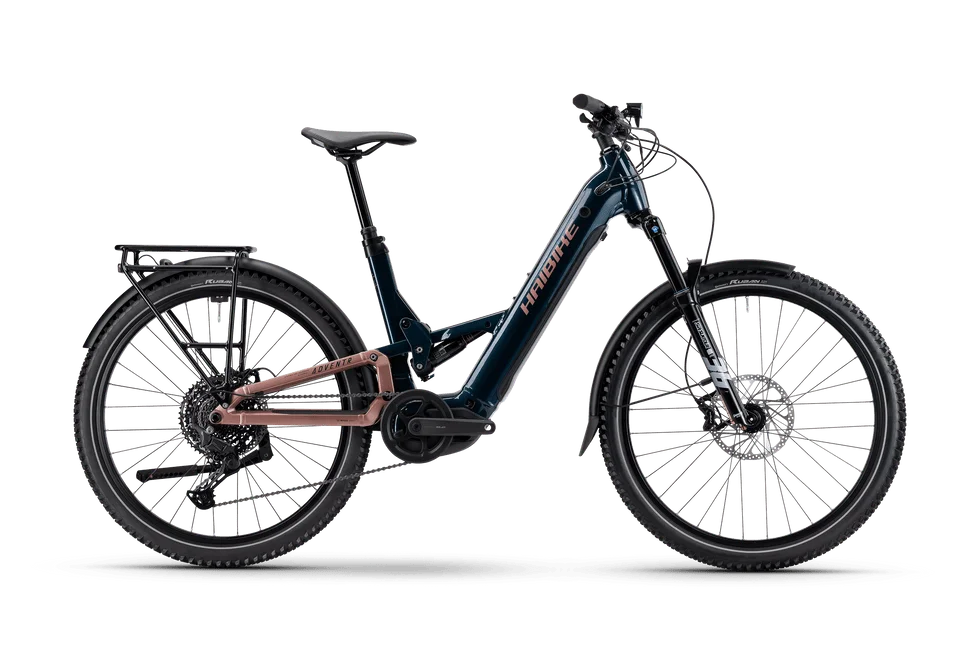

Haibike ADVENTR 8.5 Low 2026 - Electric Hybrid Bike​
Haibike looks like a great option. Are they sold in the USA? I see that some of their bikes come with a Bosch CX motor that is upgrade ready. With the upgrade what is the power increase?
I think it's 85Nm to 120Nm - but I could be wrong
ah - doesn't look like Haibike itself is in America - possibly some local dealers..
the dropper post will help, but you really do want a low top tube by the sounds of things
if you don't want to be really leaning over a heavy bike to mount it.
a lot more capable is something like a Mondraker Scree R - Mondraker are in the US
not 'step through' per se but with a low top tube
looks like you can demo as well!
might be worth looking for a cut price 2025 model.
with the Bosch CX I think you can now choose between 100 or 120Nm
edit - wheel size 29" or 27.5" could make a difference - it might be worth (if you are looking at any 29ers) checking compatibility with smaller 27.5" wheels to reduce the overall height - or just on the back - mullet style
