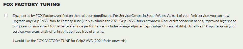

TF Tuned (UK) also offer a re tune which consists of removing some of the hardware on the damper. Last service by them on my 2021 Fox 38 they offered to do that but I opted to go for a change to a different oil instead.........that has improved the fork but will probably go for the re tune next time. TF did say they had been offering the mod for quite a while and that Fox had since a dopted the same tune!!
