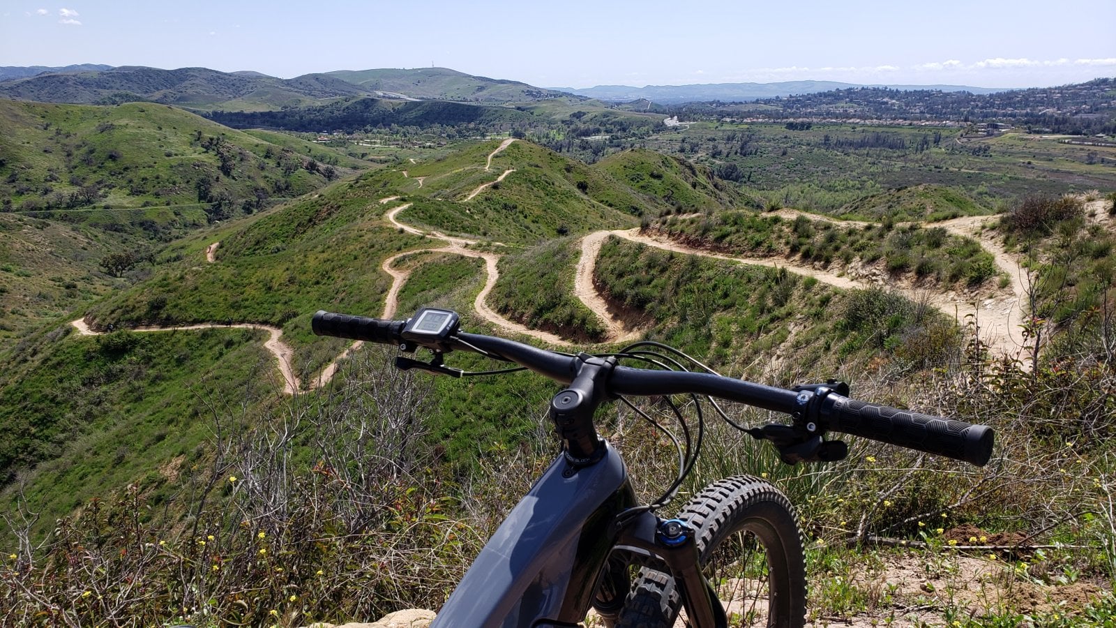

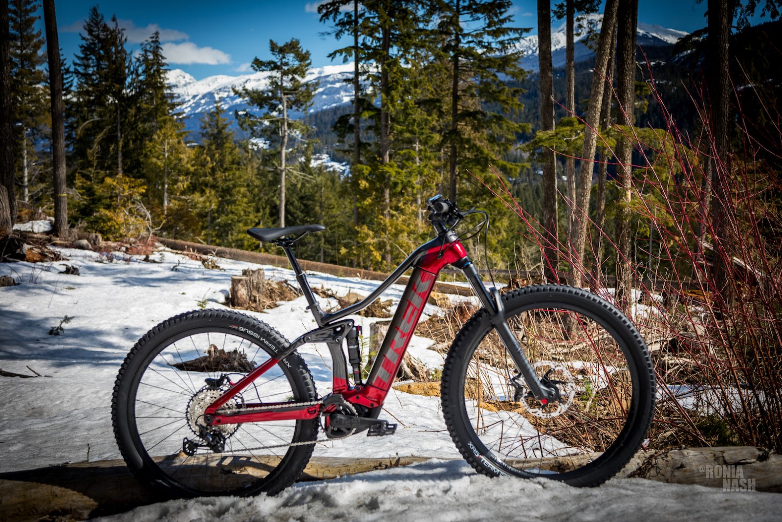

Santiago Oaks near Anaheim Hills, CA.

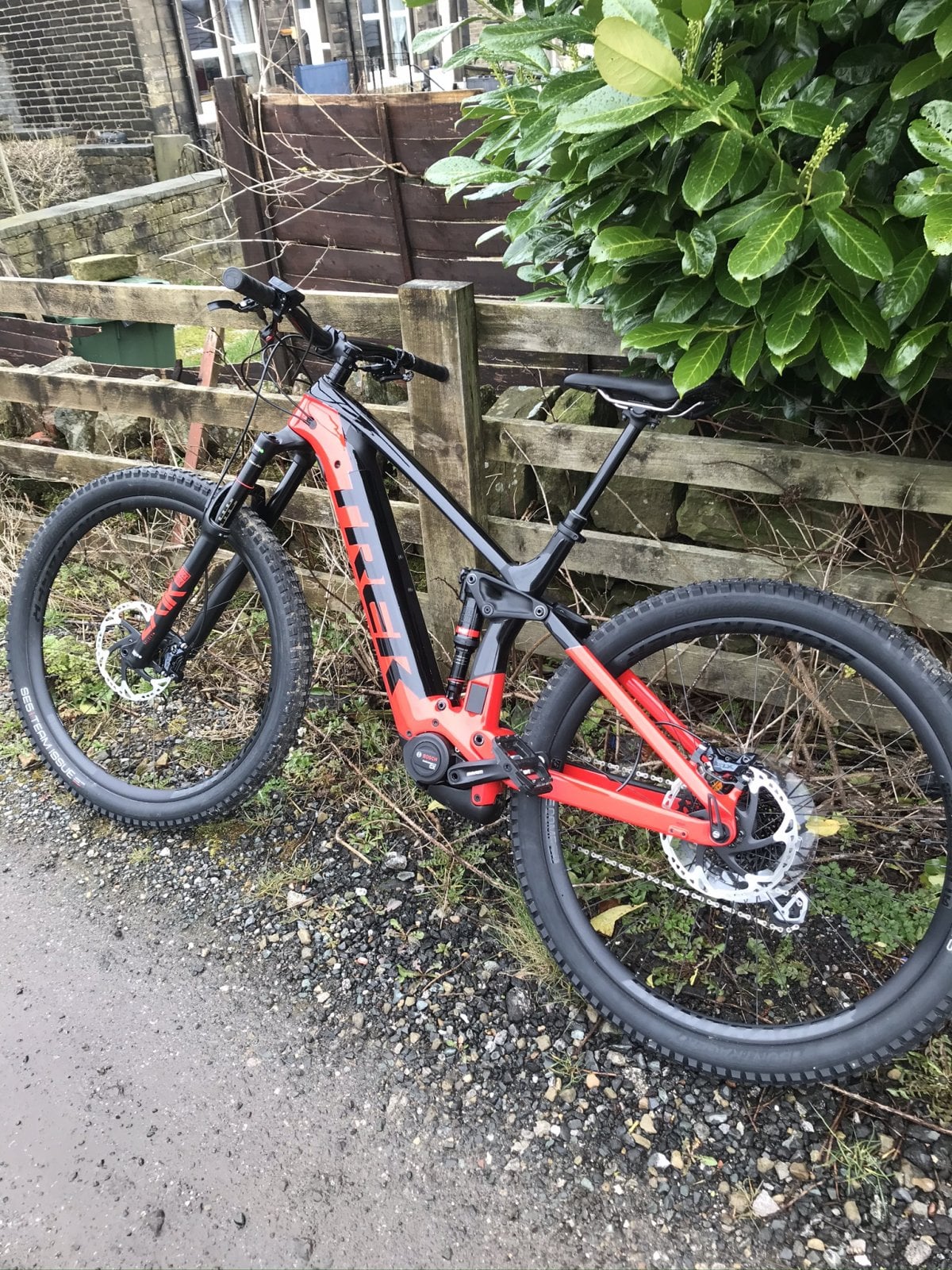

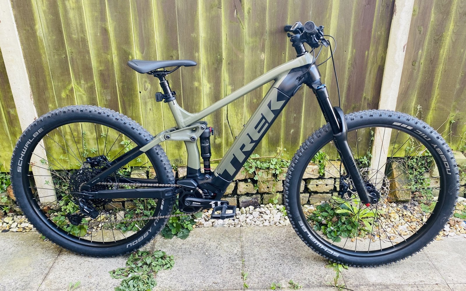

Hi @Bomble , looks amazing!
Did you go for the gloss finish Invisframe? There is Gloss, Gloss/Matte kit and Matte choices.
Yes I went for the full gloss. It does stand out a little on the matt parts, if you zoom in on the photo you can see what I mean around the seat post.
I had a Matt levo and put Matt invisi on it, I wasn’t keen and it seemed to show marks up more too.
Apparently you can t-cut the gloss stuff to keep it shiny too if you want.

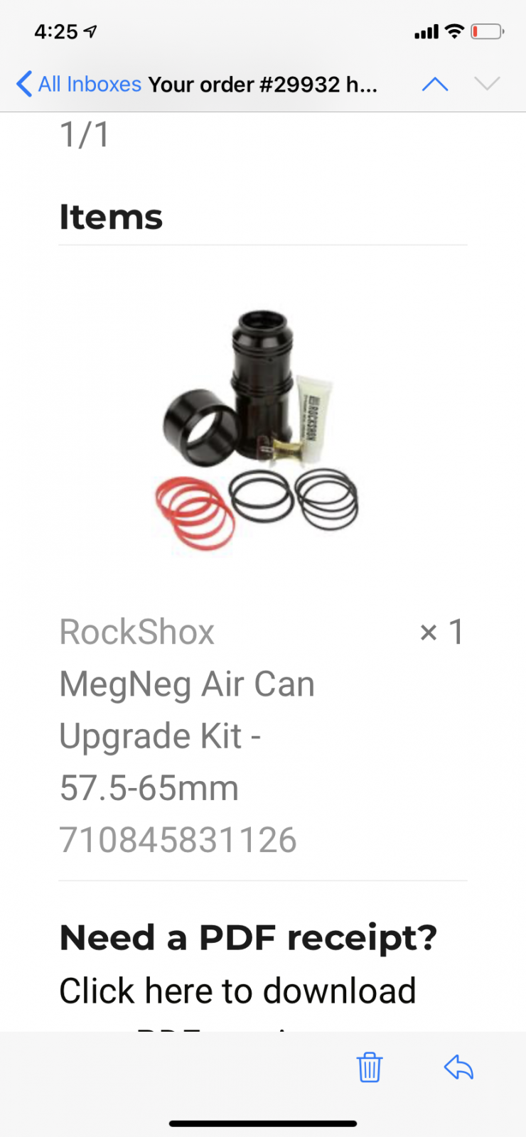

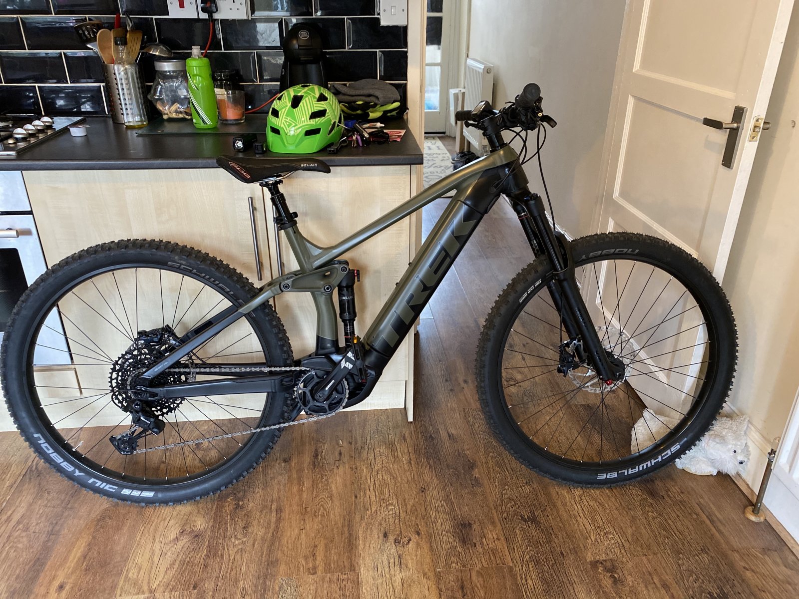

I liked the shock ,before I put on a super deluxe with meg neg. now I realize it’s shortcomings. Not only more plush , but loads more support. Less pedal strikes and skid plate whacks. Pedals better. Huge upgrade

Pardon in advance if I missed the answer, but is the Super Deluxe fit the M frame without touching the downtube?
No.

No, it won't fit. The Trek specific shock from the higher spec Rails have a smaller can, or the Ohlins shocks with the figure 8 reservoir will fit. According to TF Tuned.

Absolutely. 4 bands included. You will need 20% more pressure to get sag the same. That’s what stops bottoming. The more bands you add, the less progressive it becomes. I ended with all 4 in order to use all of my travel. If you take them all out you will never bottom it. Still very supple on top. Mid support is awesome. Bottom resistance is awesome. What more can you ask ?
Amazing mate, sound like what I need. Would be a pain if you forward me a link on the one you used? I hate to order the wrong one :unsure:(y)

This one. They have 3 sizes. The other two are sold out everywhere but the trek is an odd size. Should still be able to find
Little tip. When you take off lower oring to make your adjustments use a feeler gauge. You will thank me later

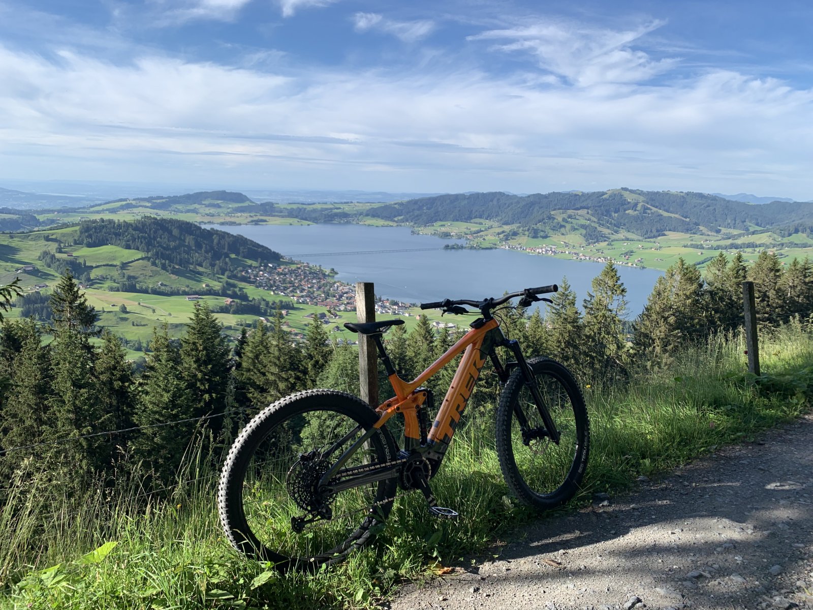

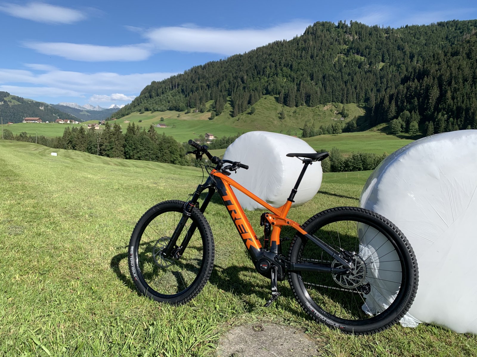

Here is my addition from this Rail 9 (2021) first ride.... 885m to 1357m over 22km, great intro to this one; did a testride the day before from 762m to 1348 which was excellent, thus just had to get it ;)
Resting on....... a bale of hay:

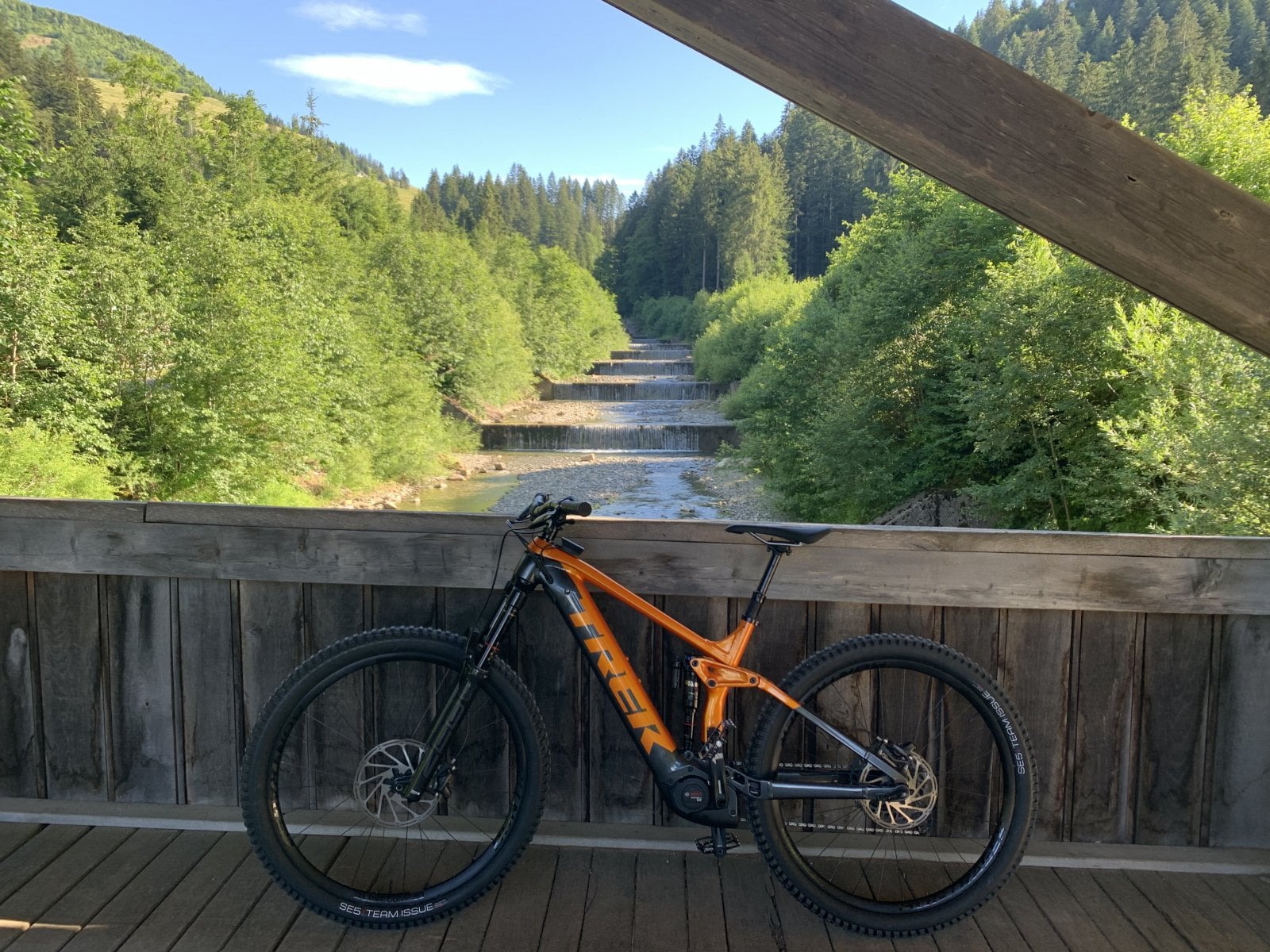

A crikey bridge:
A wooden bridge:

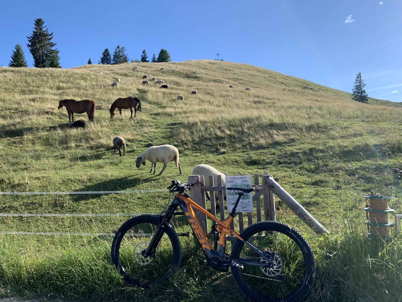

Fence while going up hill: (oh and yes, restarting a bike going uphill, that is updated to have 85Nm works great; then again that worked even better on the Haibike Flyon Allmtn 8.0, that one just ran out of juice too quickly); this section of the path was the easy bit:
Another Cow-fence:
A bench a wee bit further up:
Together with the sheep, horses and donkey (off screen to the right):
