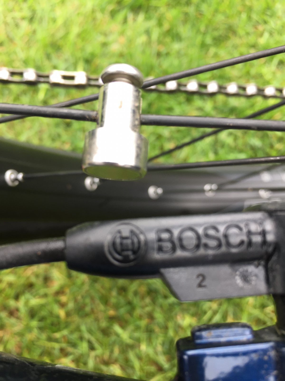

The Bosch gen 4 also uses a magnet on the spoke (well at least mine does), picture attached to show the alignment.
