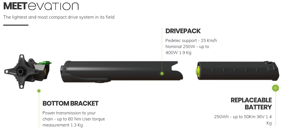

If we look at system weight, the E8000 DU is 2,8kg and the 504Wh external battery is 2,6kg (according to my kitchen scale) and add some for wires/display/assist switch/battery mounting hardware. Based on the info in the EMBN video, the complete Fazua system is 3,3kg which means more than 2kg difference between the systems.
Although according to this post (and agreement below it) the battery is extra to that 3.3kg giving a total of 4.61kg (vs 5.4kg as you measured for the E8000+battery)
Lapierre EZesty - EMTB Forums
So you are pretty much saying that it's a heavier system than Shimano E8000 @ 2,8kg + battery vs 3,3kg + battery. I would like to see it measured because it's just guessing and it's hard to believe...
Yep, those stats are correct according to the Fazua site... 1.3kg for BB, 1.9kg for motor and batt case, 1.4kg for battery giving a total of 4.6kg:
It does sound like a Shimano with a 252Wh battery would be a very similar weight :unsure:
Nice... then with the same battery it’s heavier than the Shimano. Kind of disappointing for the price.
I agree. Maybe a shimano e7000 or a 6000 if they do one with a smaller battery is the way to go. Still love the zesty though.
