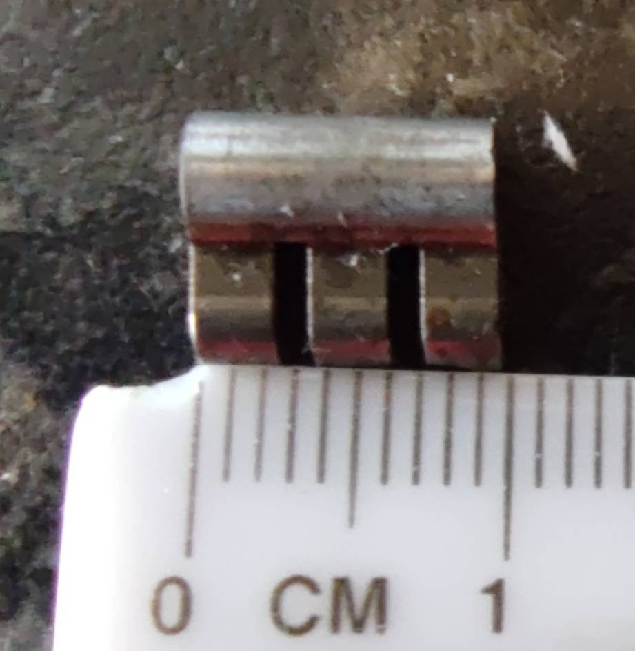

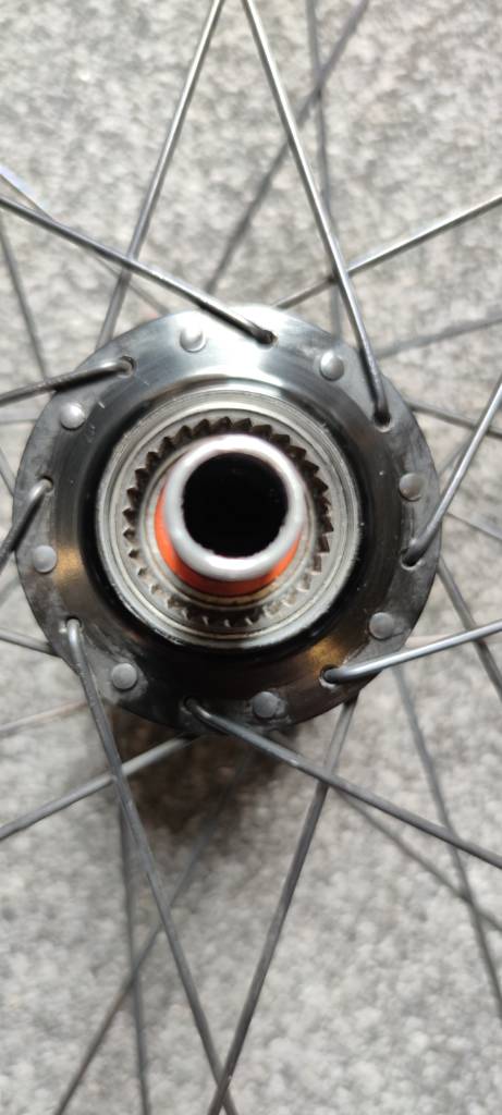

Are they 3 pawls with gaps or 9 individual ones?
they are gaps not individual
Am i over thinking things ?
So long as i get a 9 speed HG Freehub body does it really matter what style the pawls are ?
ive seen some DT Swiss 3 pawl freehub bodies that are available but have no clue if these can fit into this part..
Are there different sizing standards or can i just fit any HG body ?

it will fit but will depend if the pawls will engage with the teeth in the hub and not slip or destroy the both of them but if they look like the same shape it is worth a shot.

As a last ditch test i decided to get the grinder out and re-shape the pawls back to a point where they bite......
Definitely dont trust this for a hilly ride but might be able to flat local ride a bit until i get parts
Temporary Result

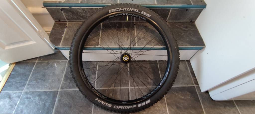

I've just opted for the Miche wheelset, The £40 saving over the nukeproof will hopefully cover the cost of the Haibike freehub body and then i have a spare set of wheels.

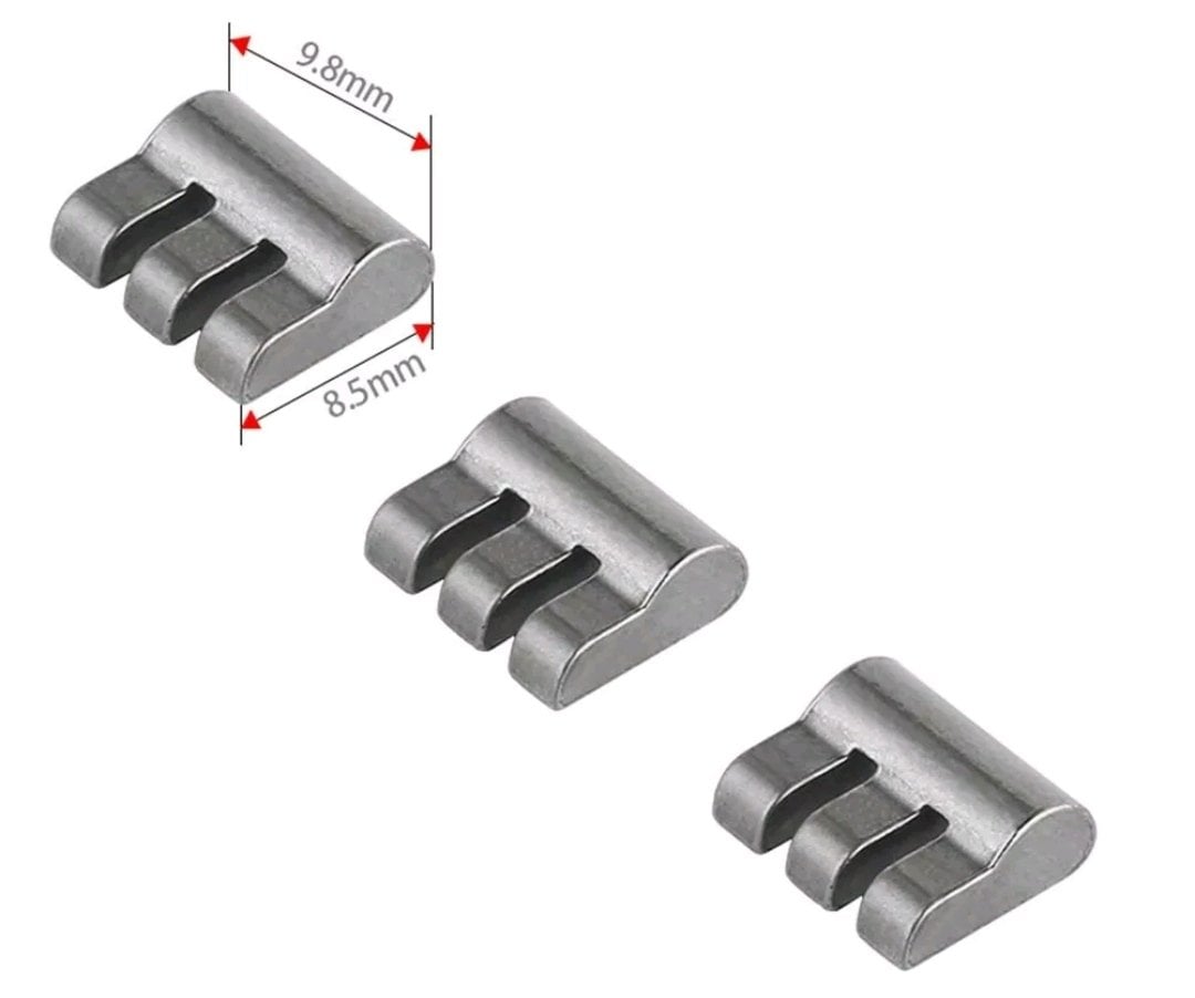

ordered some pawls
so i can repair the existing freehub body too as a back up in case Haibike or dealer fails to supply.

New wheelset en-route so should be fitted by this evening.
Wheels delivered and all fitted, quick test ride just up and down the street road..... all good atm.

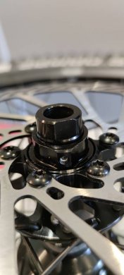

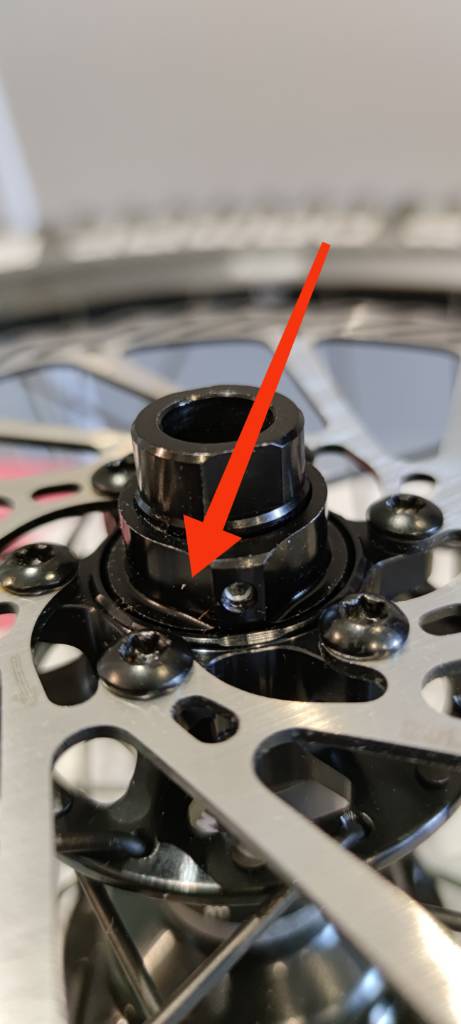

Noticed this on the rear hub, it spins around and has a grub that tightens onto the axle ! not seen one of these before, any advice on what it is / used for ?
