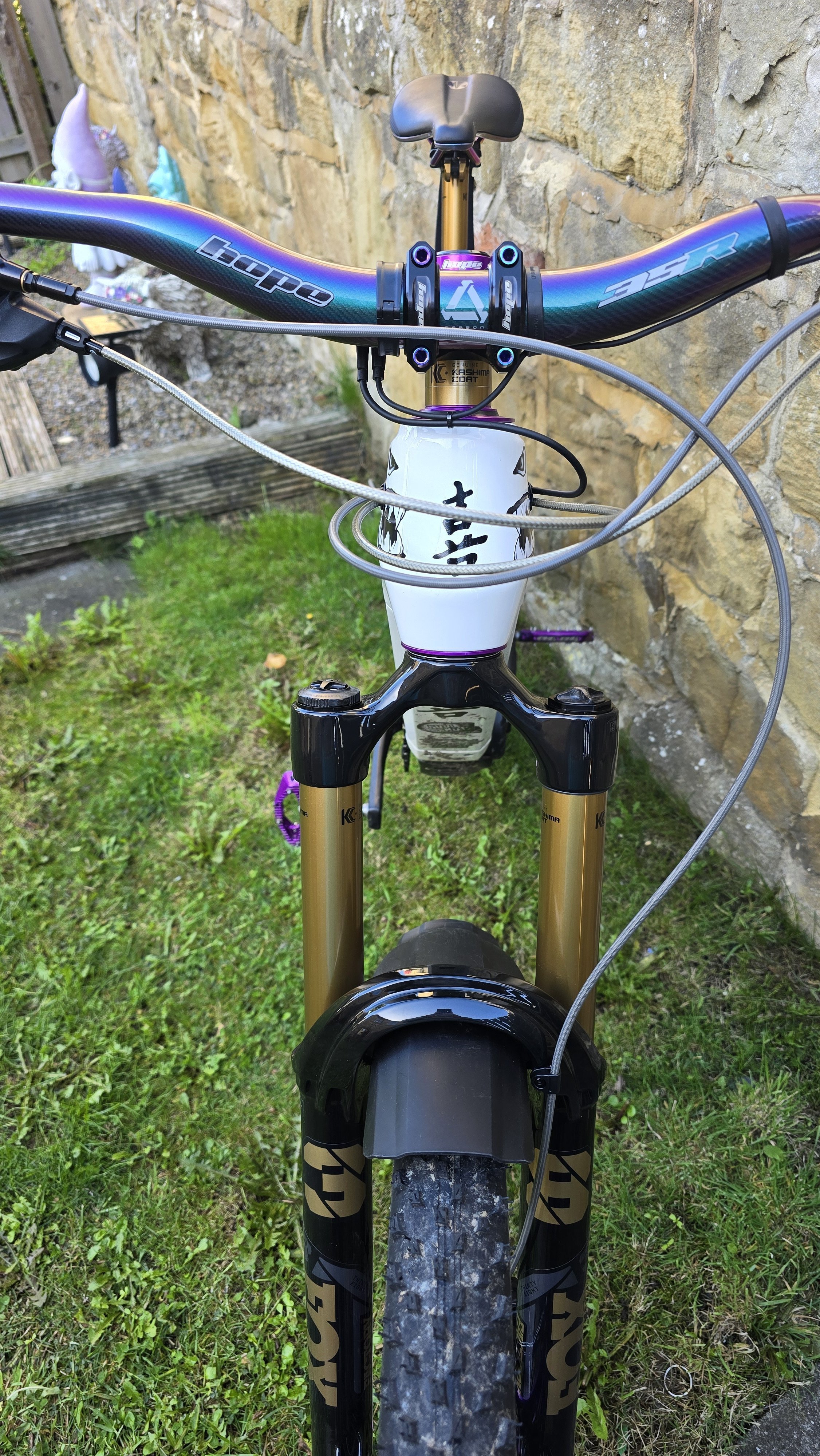

Thought i might aswell do a little build post of my Dengfu E82.
Ordered direct from the dengfu website and at a touch over £1600 i was a but dubious however Mia kept me updated the whole way through via email and 6 days after ordering it had all arrived.

The frame arrived well packaged and whilst it isn't supplied with any instructions it looks fairly straight forward.
All connectors are colour coded.
The only problem I came accross which is fairly minor is that the m3 bolt supplied to fit the speed sensor was too short so I ended up fitting an m3 x 8 rather than the supplied m3 x 6.
I'll try and take photos throughout the build but I some times get a bit carried away building so I apologise in advance.

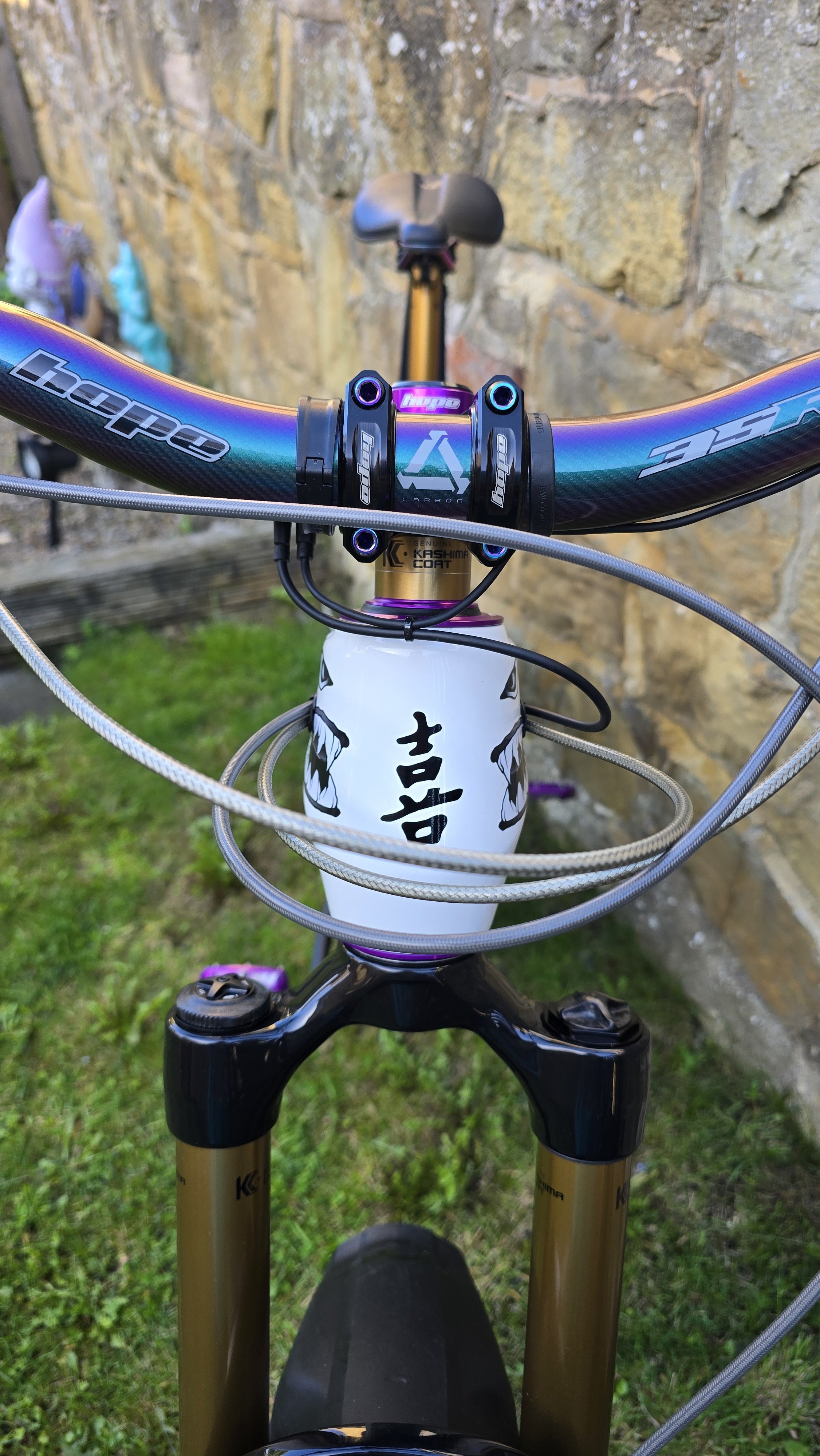

I wasn't sure whether the hope headset would fit, it looked like It was quite shallow in the headtube and seeing everybody fitting the dengfu supplied headset made me think aftermarket would be a problem.
Went in no problem 😊.

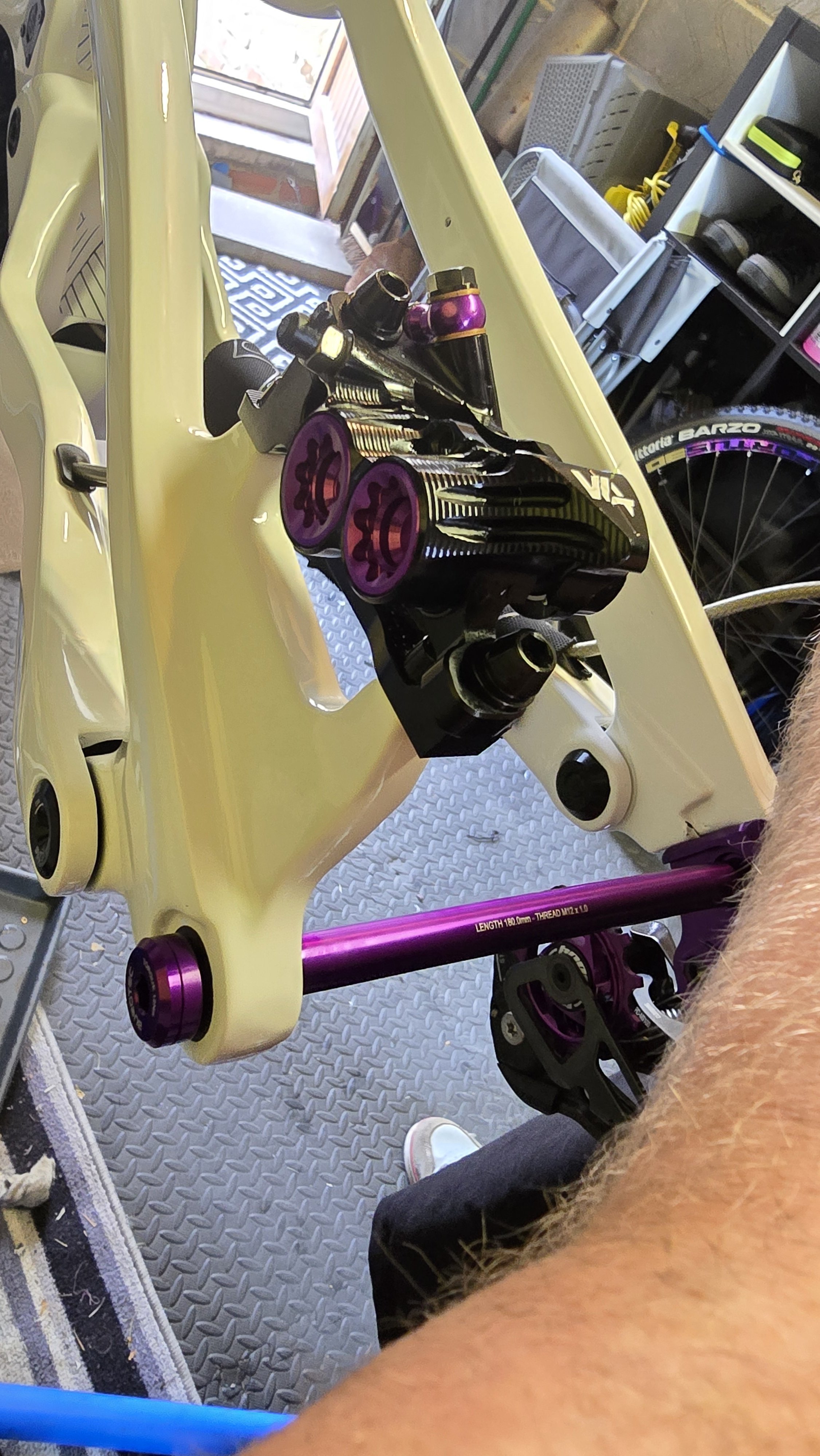

After reading about the poor quality of the rear axle that is supplied with dengfu frames I decided to give it a swerve and get a burgtec thru axle to match my front one, and because I like a bit of bling I added a burgtec UDH hanger to match it.
Just waiting for a couple more bits to arrive and hopefully get it built up this weekend.

Yes all fits and works perfectly 👌.
The e10 hope headset will look even neater with it having the tapered headtube.
Today I stripped down the fox 36's to fit the 170mm air shaft as I stole them from one of my hardtails. Alot of work for not much difference in travel but needed to match up with the rear better. Added my carbon fibre grip 2 knob and aircap.
I'm finally happy with the wiring so motor is now mounted.
Today I got most of the E82 built up. Still waiting for a few bits to arrive but managed to build it up enough to test the motor with a quick ride. It definitely made me smile.

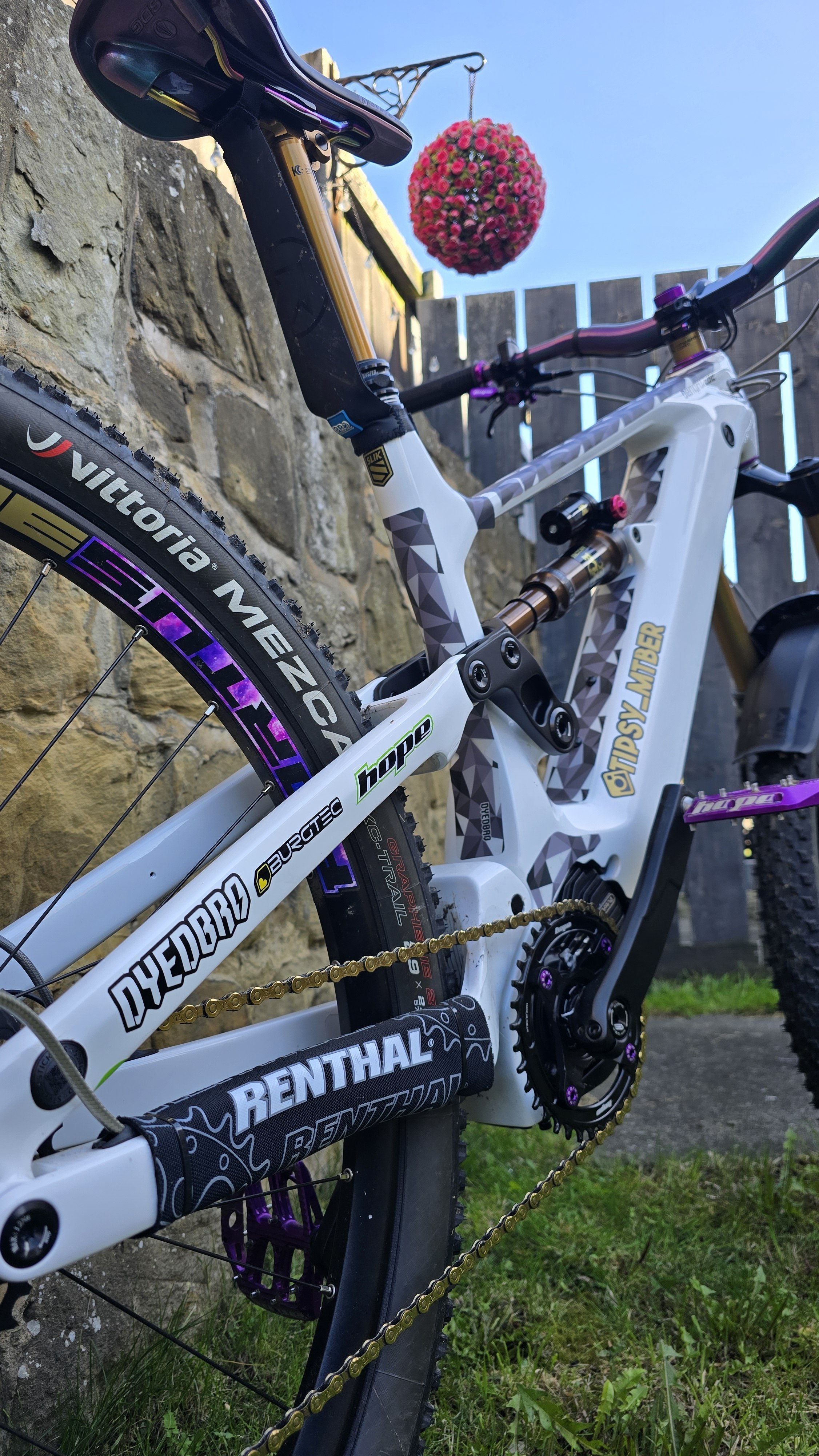

Anyway, started off re bleeding my rear v4, fitting Galfer E-bike purple pads along with a set of better bolts thicker pad pins to stop the slight movement you get on the V4. I would definitely recommend them.
Then on to fitting the Hope chainring and unite components chain guide, had to shorten the fitting bolts snd slightly ovalise one hole but fits well, I've dropped the guide down slightly now.
Standard bafang cranks fitted until my HPC cnc cranks arrive.
Next was fitting my carbon fibre tech 4 reservoir caps to match the adjustment knobs on my forks. As I said earlier in the thread, I like a bit of bling.
There's still a few bits to do buy I'm really happy so far.

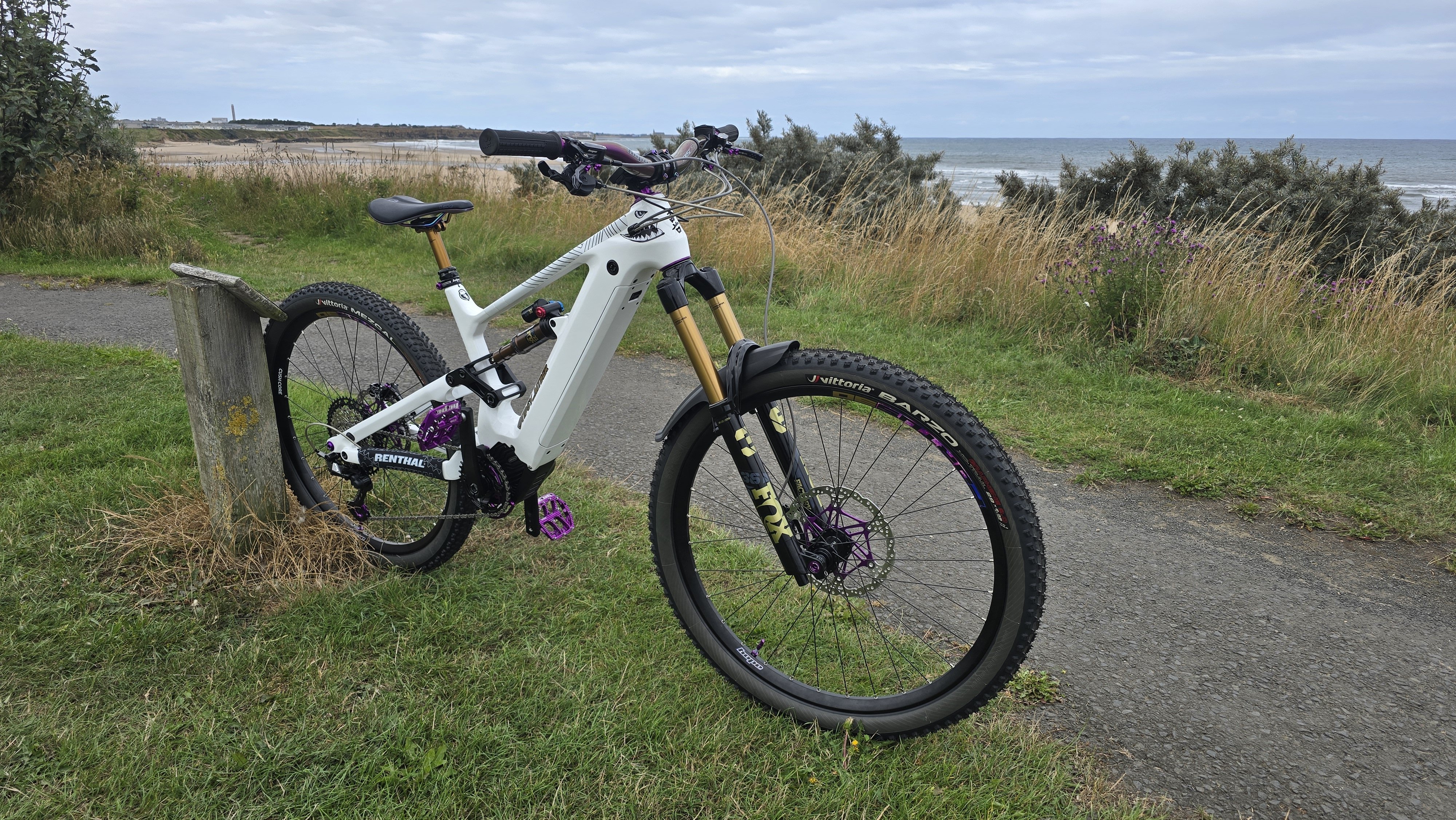

I've had the e82 built up for a week or so now and been out on a couple of shakedown rides.
What a bike, I'm well impressed.
No battery rattle like alot of people mention. All feels nice and solid, very little flex for a carbon frame.
Weighed it earlier and it comes in at just under 24.8kg which is a fair bit lighter than I expected to be honest considering I'm running cushcore inserts.

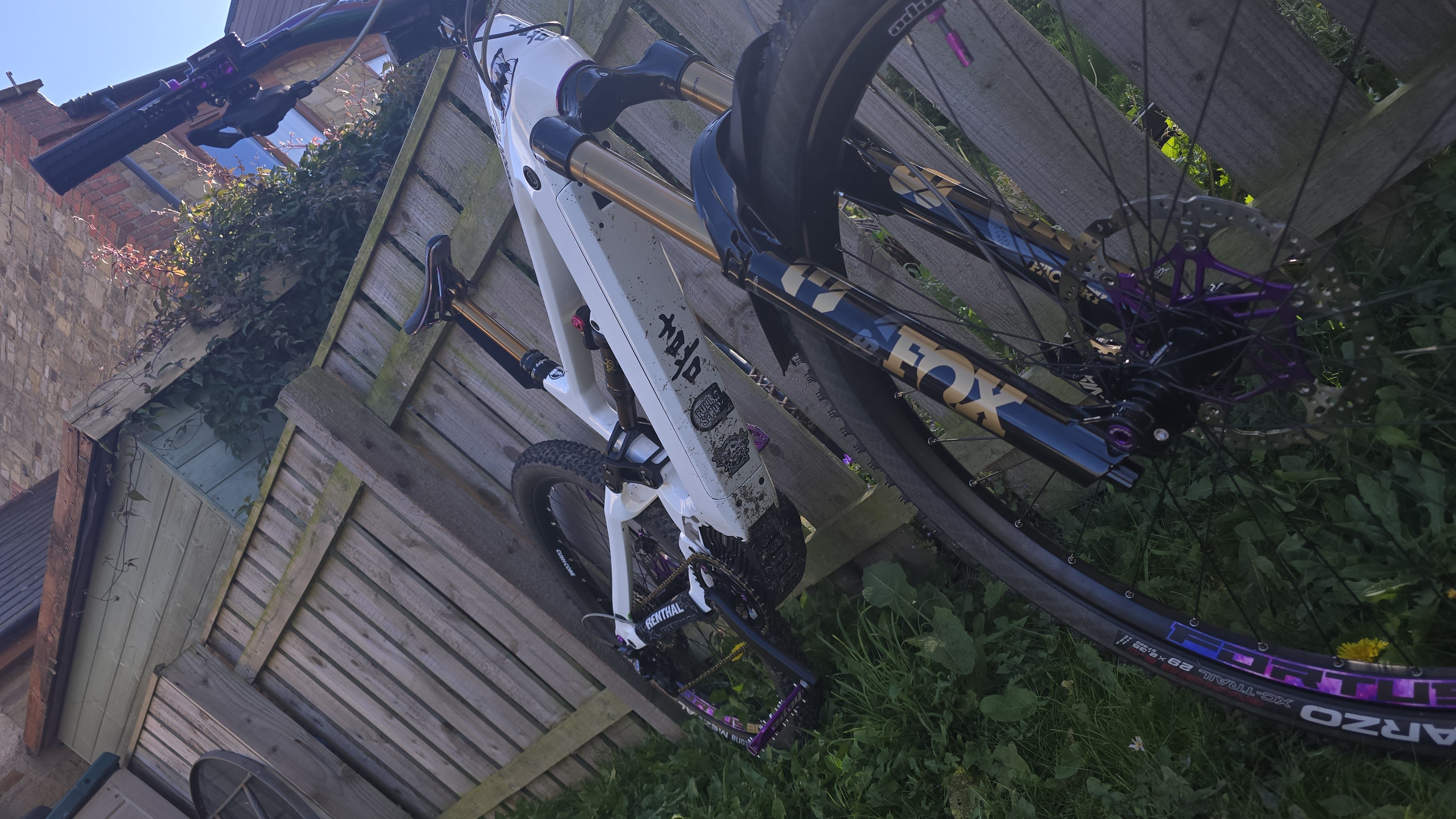

The change was swapping the fox 36 to fox 38 180mm forks. Also fitted a set of kashima headset spacers, a bit of bling I've wanted for ages and finally got some.
I've fitted new frame protection too but not 100% happy with it.
Done just over 1000 miles on the dengfu so far and still loving it.
