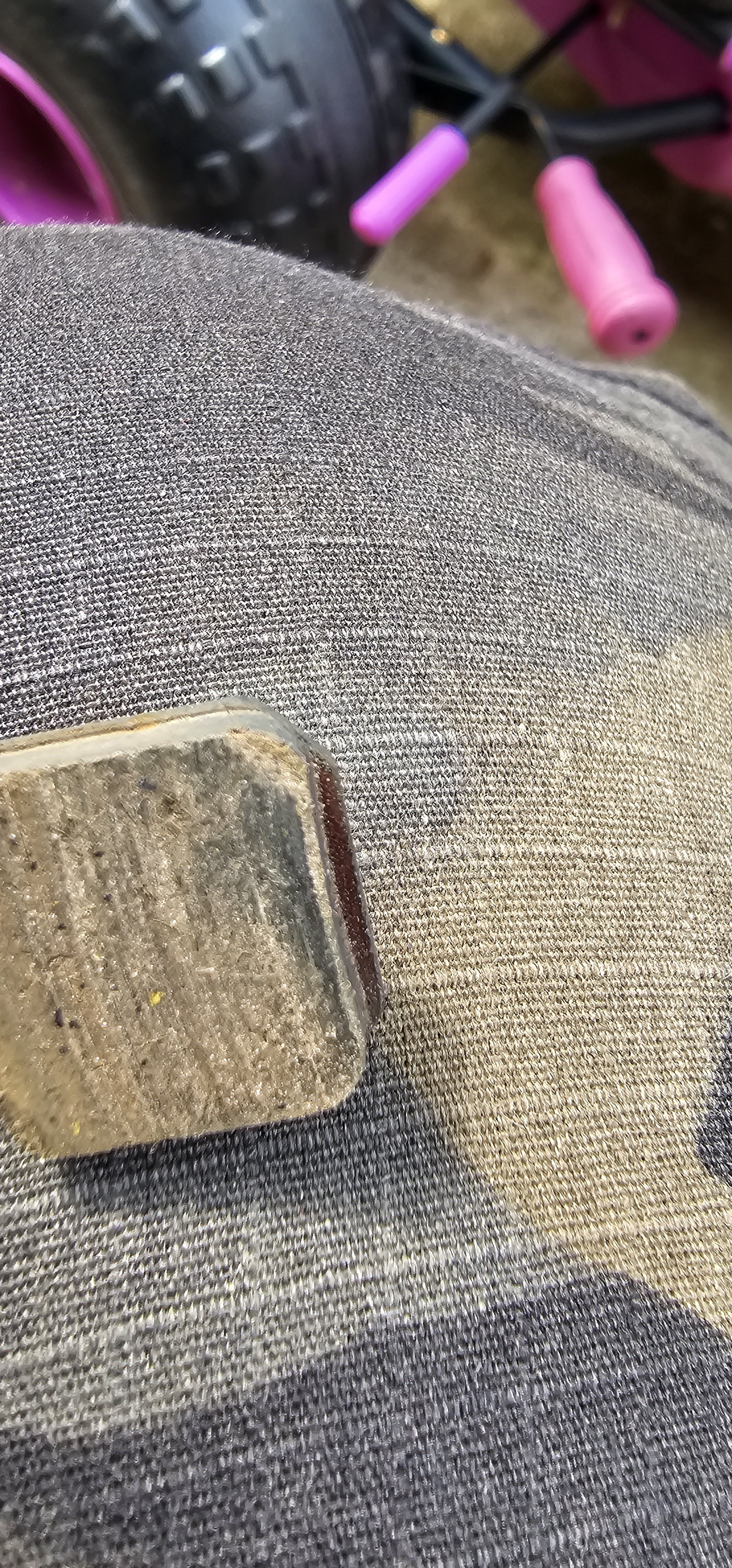

I did have the mt7 for last few months and they was makeing crazy grinding noise,
Finally problem sorted, change the brake pads for aztec organic, they got smaller pad area and therefor they won't go in to the rotors air vent holes.
Dead silent brakes finally...
You can see in the picture that original mt7 pad corner did rub in to the vent holes.

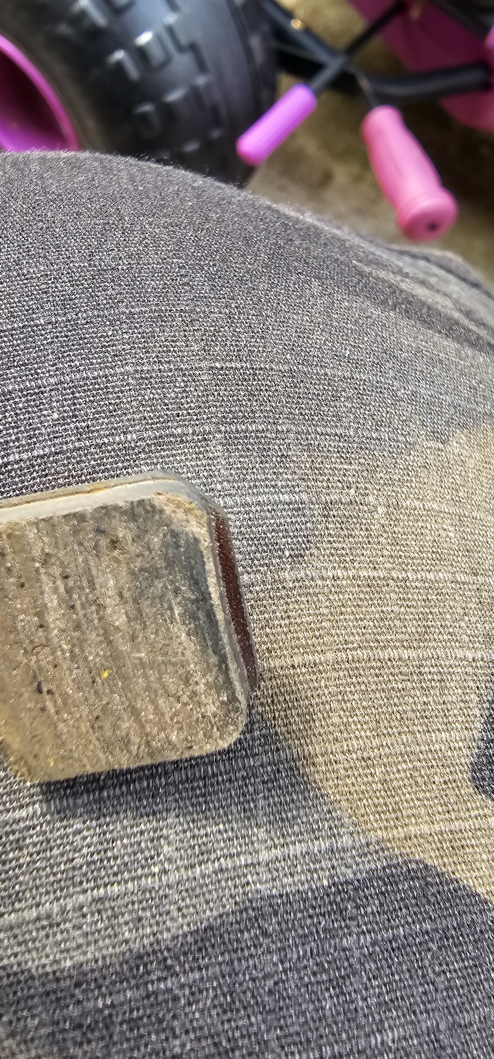

If i see the wear on the pad, i would say bad alignment.

Btw, checked by 3 shops says nothing to me, even then is misaligment possible, the wear on your pad is uneven.
What wear ? They are new, was on bike, made grinding noise, exchanged for azrecs , all good.
