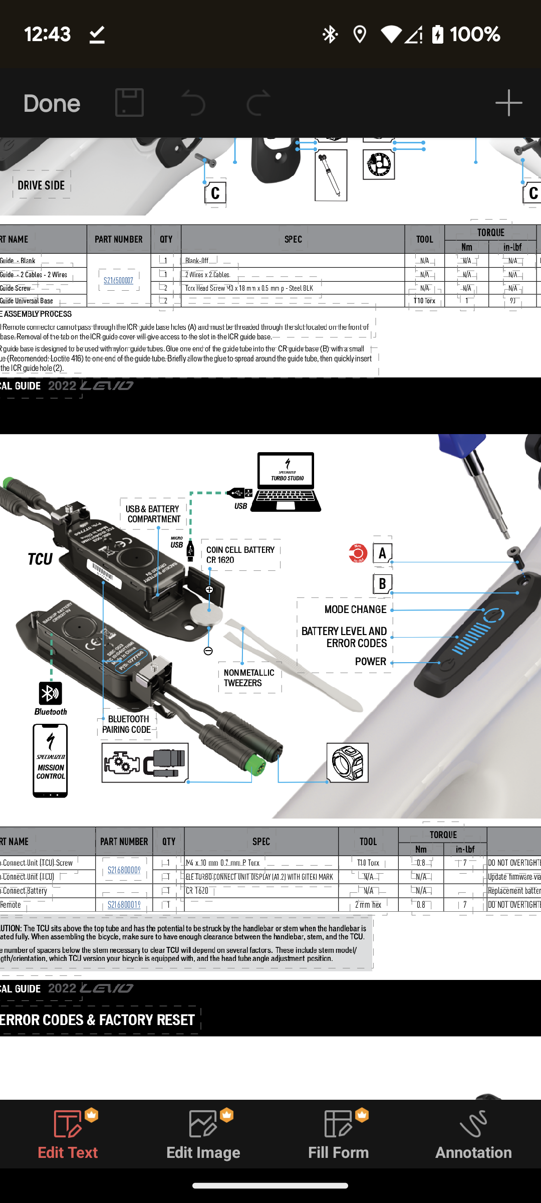

Hiya mate, only just getting round to switiching the cable to the left but im having a real issue getting the cable/socket through the plastic bit that the cables go through and which the screw fits through, its to big to fit through and i cant make the end of the plastic part wide enough?
I am honestly dredful at things like this and advise would be greatly recieved

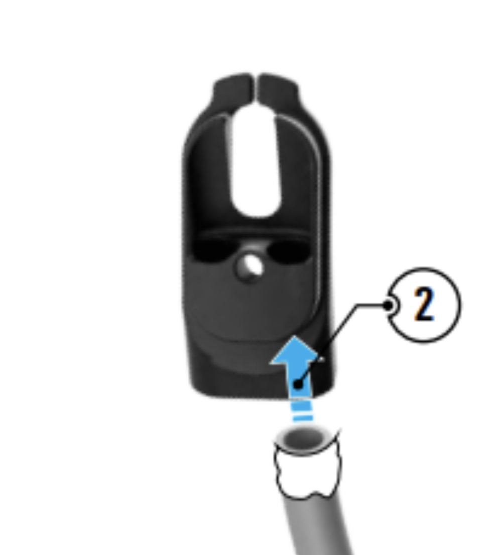

Post a pic. You have to remove the cable guide from the frame, it has a slot in the end that allows you to push the controller cable though without having to force the connector through the hole.

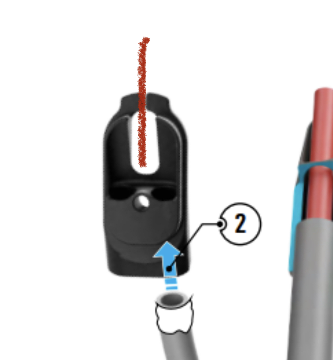

If you push that black plastic back towards the rear of the bike, you should see it has an open end that you can push the cable through, then you can pull the cable out of the frame hole.
I've tried mate and no matter how hard I push it back I can't get the cable through the end

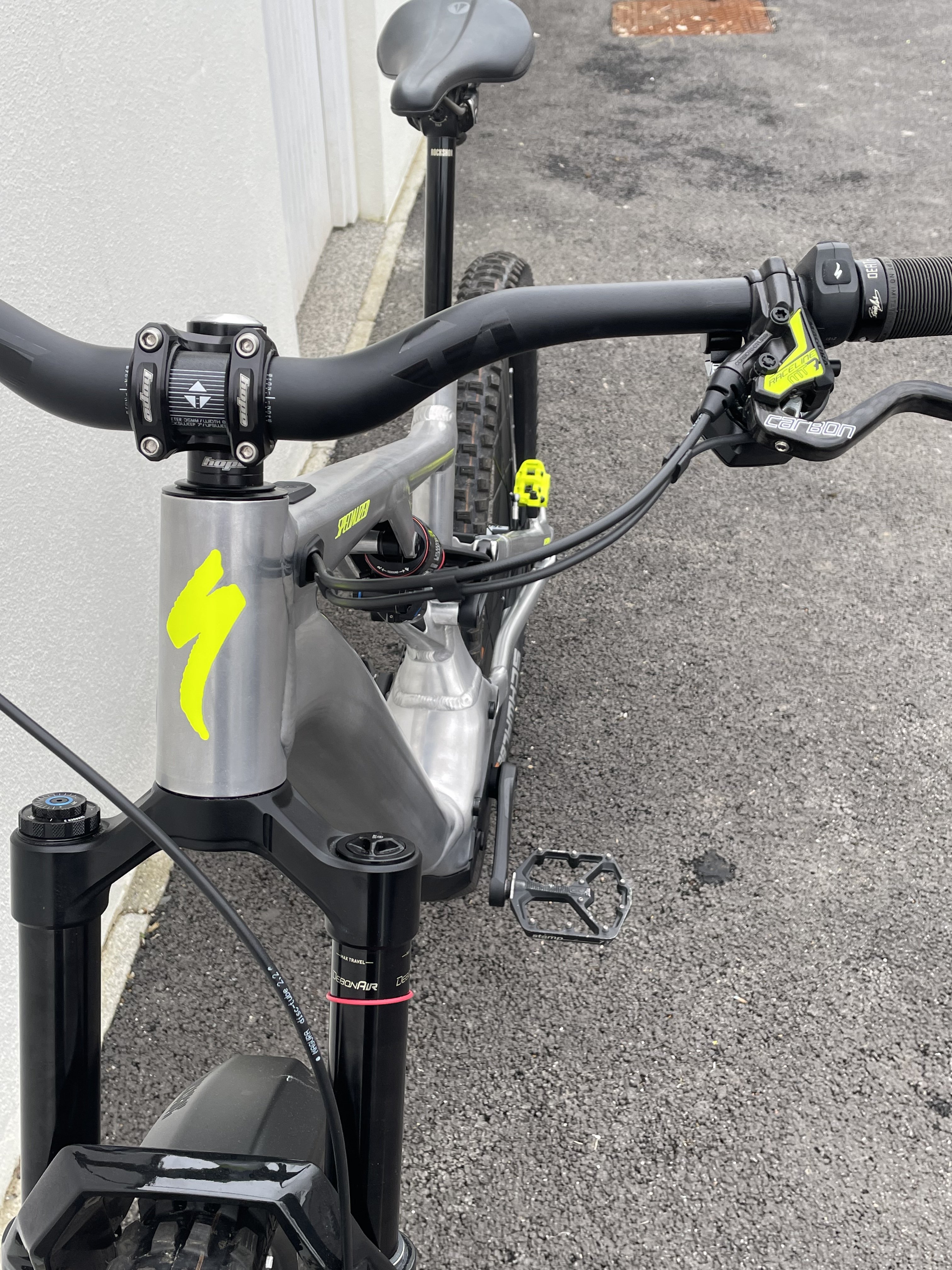

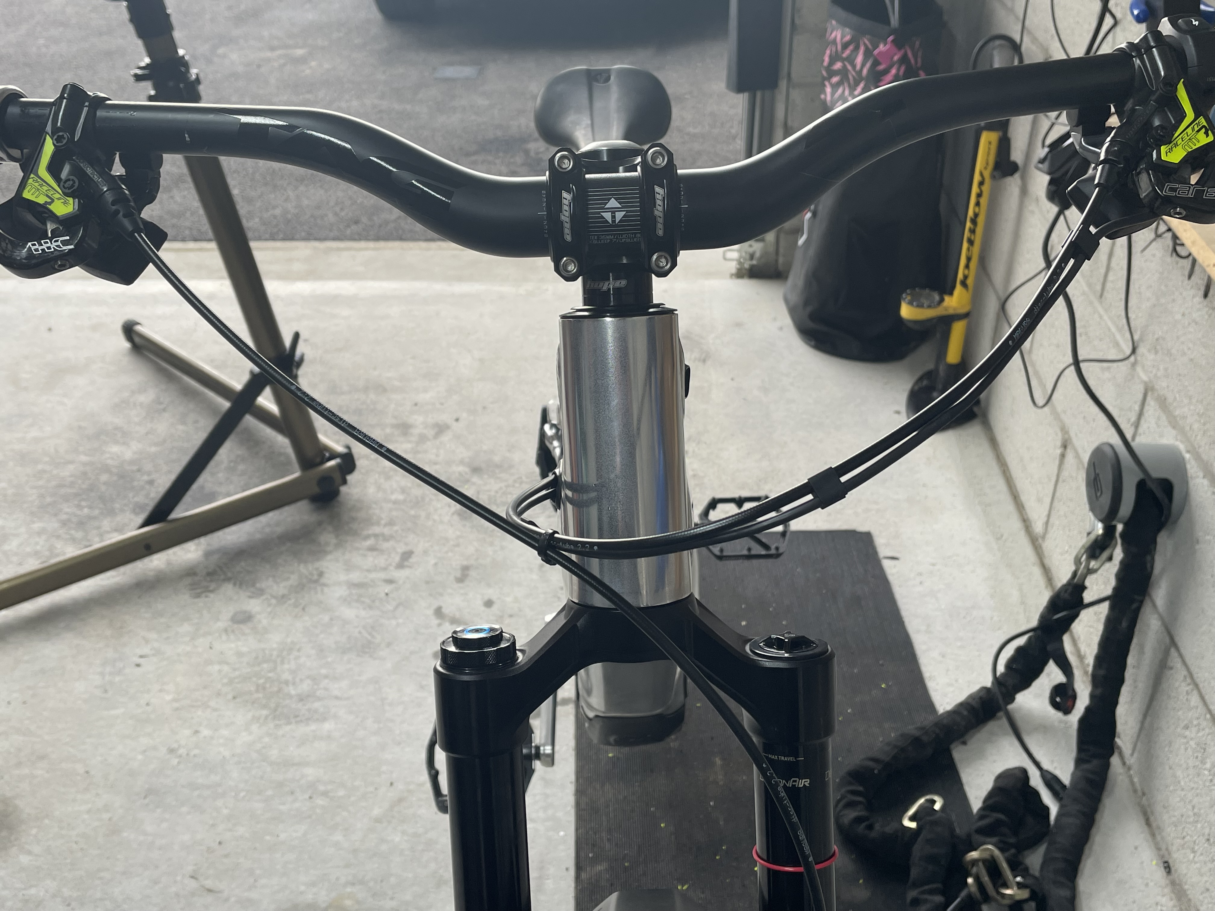

Hi mate, i got it done at long last, also had both brake cables shortened slightly.
Really cleans up the front end. My friend is making me a blank to cover the unused side using a 3D print

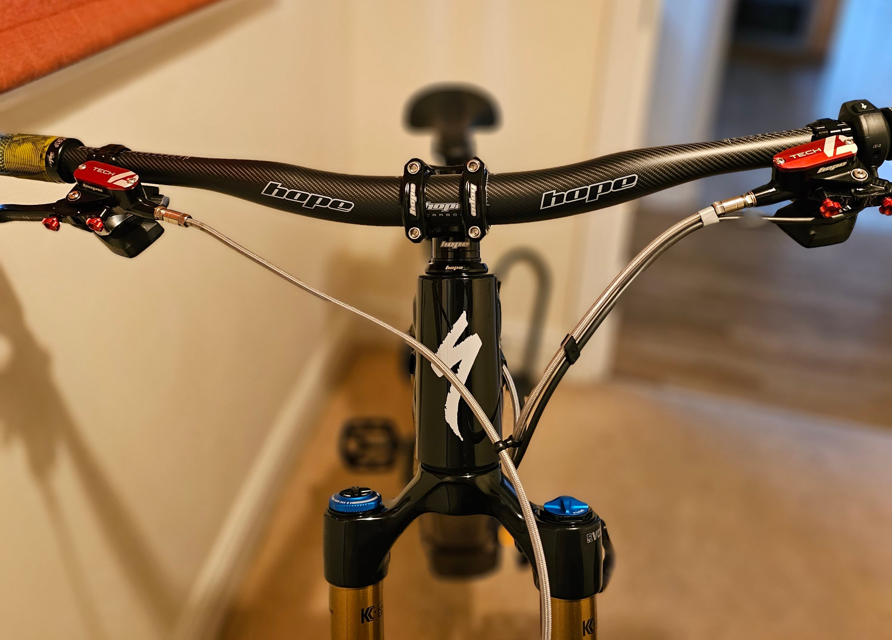

Why didn't you put the brake line and TCU cable thru on the RHS?
Makes more sense putting it through the LHS, looks cleaner and less distance for tcu and brake cable, sending it through the RHS means more cable which defeats the object of the excercise 👍
