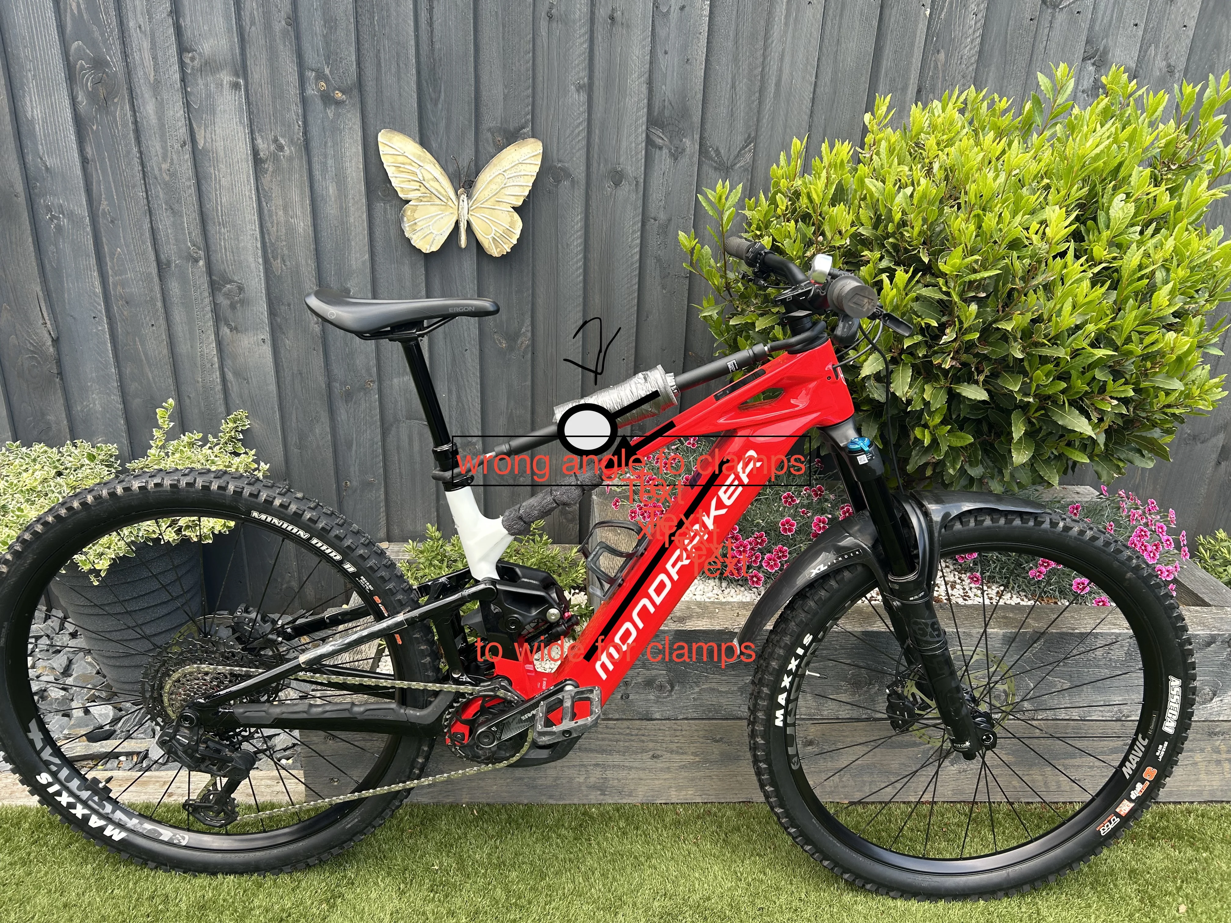

Thule bike racks don't fit the new Mondraker box section frames i had to make a modification but can only fit one bike on now so if any one knows a rack that can take 2 Mondrakers could you please let me know ?

appolagise for the red writing but new to this also the arrow shows what i have done to the thule adjustable clamp.

The photo helps a lot. I can see you've modified the Thule clamp arm to get it to grip the Crafty's box section tube - looks like you've bent or repositioned the clamp contact point to get any purchase at all. The problem is that workaround only gets you to one bike, and it's not a setup I'd trust at motorway speeds regardless.
The honest answer here is that frame-clamp racks and box section tubes are fundamentally incompatible. The modification you've made confirms it - you're fighting the geometry of the design rather than working with it.
The clean fix: wheel-on racks These grip the wheels, not the frame, so the Crafty's tube profile is completely irrelevant.
Thule EasyFold XT 2 - since you're already in the Thule ecosystem, this is the path of least resistance. Folds flat, tilts away from the car, handles two bikes via wheel trays. The Crafty's weight is worth checking against the rated limit - I'd want to confirm the per-bike and total capacity before buying.
Buzzrack Scorpion 2 - solid wheel-tray hitch rack at a lower price point, handles heavier eMTBs well. • Atera Strada Sport - German-made, good eMTB weight ratings, tow-bar mount.
