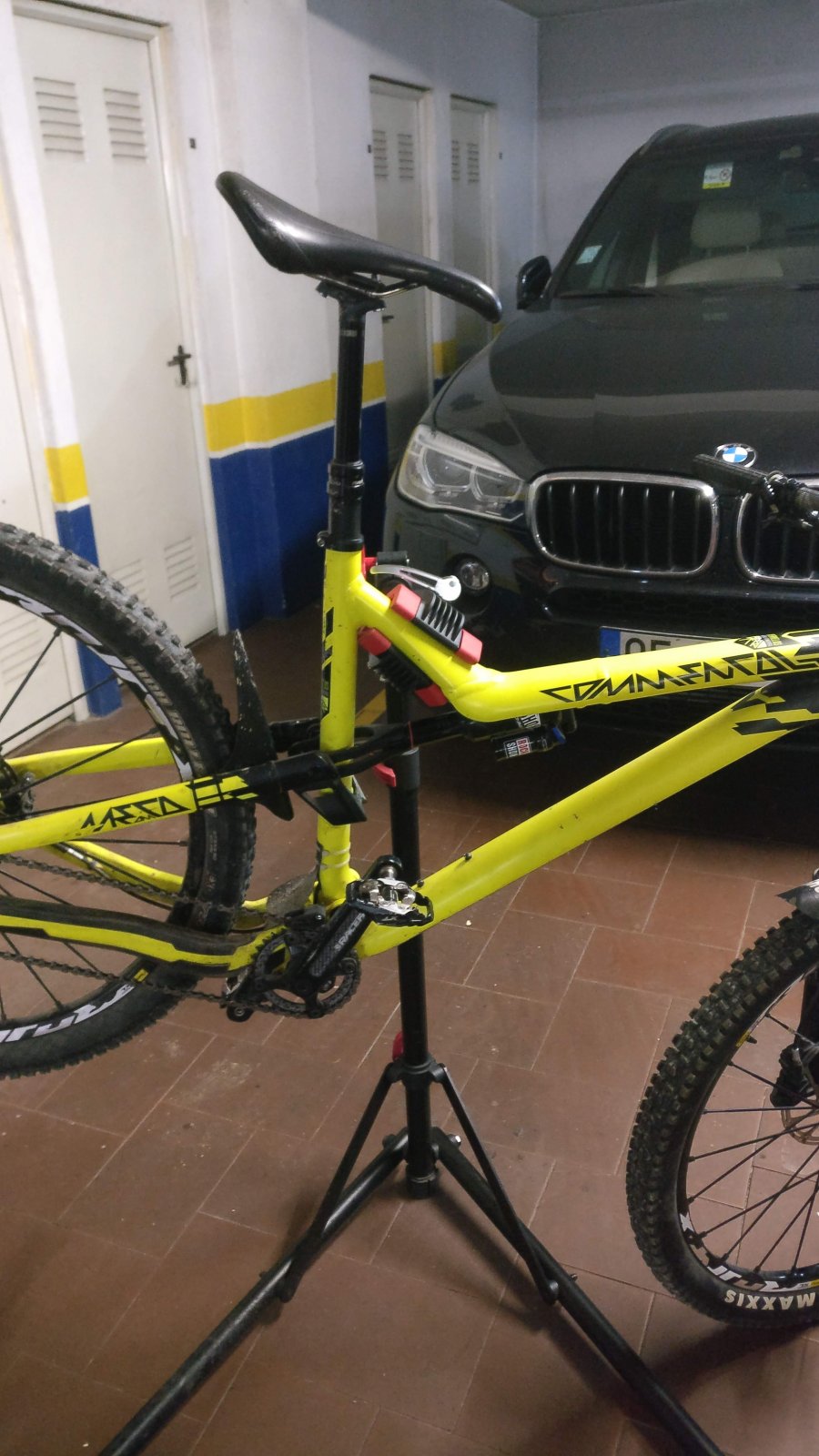

I've been trying to find ways to put my Meta Power on my workstand, but haven't yet found a good option, other than securing the bike by the seatpost, which I'm afraid to do because of all that weight.
My V4 is easy to put on a stand by the diagonal part of top tube:
but that option doesn't work with the Meta Power.
Ideas please?
My Feedback stand fits fine on the seat tube, but it has a different clamp.
You afraid to clamp your seat post because of all that weight but not afraid to sit on the saddle? :)
I clamp all my bikes - including my Meta Prower (without battery) - by the seat post for many years and I'm yet to have any problems...
Feedback Sports stand works fine with mine. Bike is HEAVY and requires a good bit of tightening on the adjustment screws but it works. These stands aren’t really made for a 50# bike. If I had the room I’d mount a permanent Park stand to the floor like in a shop.
