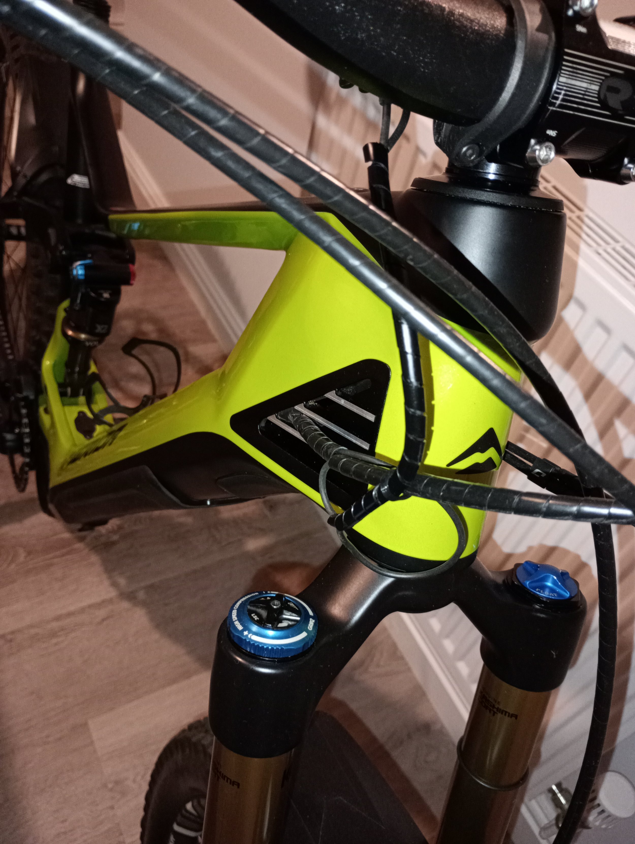

Jack of Newark Cycles completed the job late yesterday after waiting one day for delivery of the control wire. He thought he had the control wire in stock, but it was the wrong one. He couldn't get the light cable, which was just as well because I had decided not to refit the light as I had never once used it over two years. He did not have to remove or even loosen the motor, but he did need his cable routeing tools.
Despite the display being on the right, he decided to take the control wire out of the left vent and support it from the front brake cable. He believed that it was a more secure route, given that the wire is quite thin and fragile looking and may not survive first impact with shrubbery. I agreed! He told me that the light cable's two wires were soldered in to the motor panel instead of being plugged in as he would have assumed. I will repair the light cable and hand it and the light over to whoever buys the bike from me in the future. Overall, a nice neat job and super quick. :love:

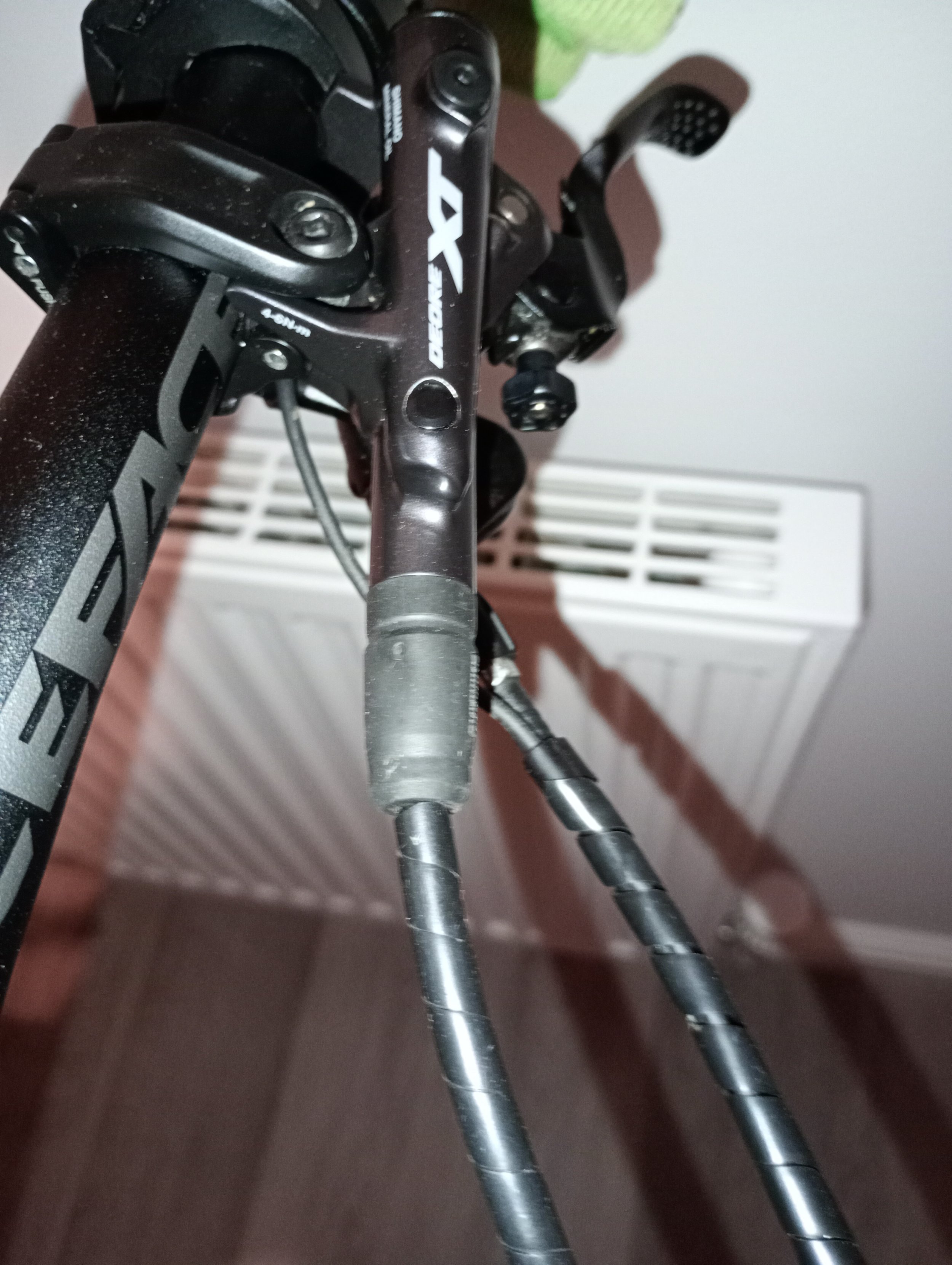

Steve, I've just seen this post, I'm shocked your bike came with the wires routed through the head tube, is that the norm?
I bought my E160 9000 (carbon frame)new in July 2020 and the wires were routed through the vents. Not had any issues with the wires, only the battery in the on/off button went flat when the bike wasn't used over winter.
I changed my stem and bars and routed the cable to the up/down control along the dropper post cable.

Thanks for the informative post @Zagora. Yep, the "wires through the headtube" was a 2021 "improvement"! I haven't found anyone that likes it. it didn't cause me any problems at all, until all of a sudden, it did.
I can only think Merida routed the wires through the head tube to give the cockpit a cleaner look...not much of an improvement if it's causing issues! I wonder how it's routed on the newer '23 models.
Still through the headtube!
At least as far as I can tell from a 2023 review video. It doesn't tend to rank very high versus other stuff.
