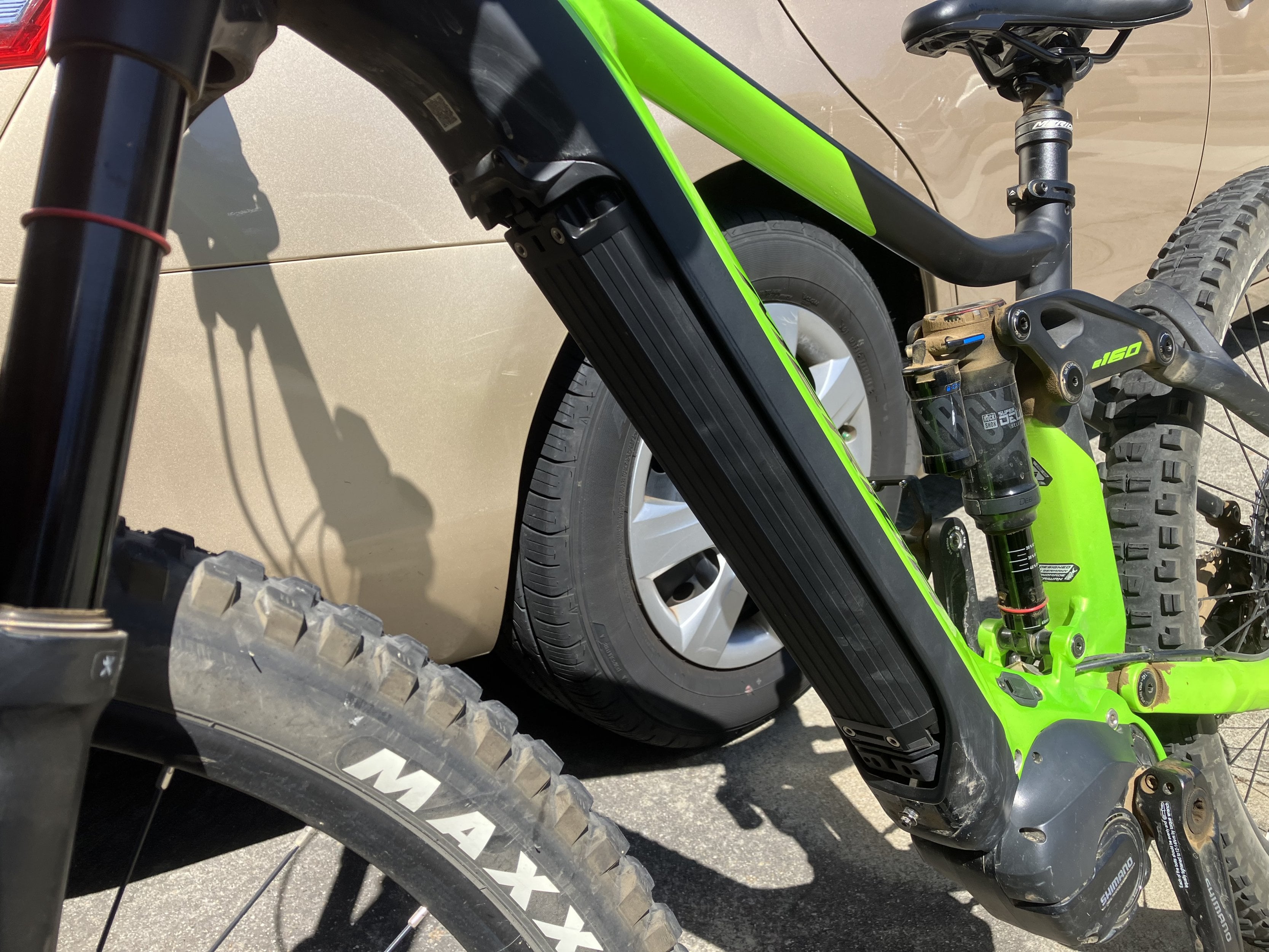

Have an e160 ltd and lost my battery cover riding on Monday. Cost to replace is $60 and will take a couple of weeks to get here. Having a look around on Facebook it seems like a few other people have lost theirs too.
Has it happened to anyone else on here?
What have you done to make sure it doesnt come off?
Cheers

Okay found a replacement cover that someone else had and just made this mod to make sure it doesnt come off again. By putting the piece of plastic in there it uses the existing latch as a screw for the cover instead of just having the rubber hook.

The low battery cradle has 2 screw holes. I use two flat head screw with a rubber washer to hold the cover inplace and stuck a bit of foam rubber on the top inside of the cover to prevent battery rattle. Works like a dream. No need to drill into the frame or have anything protruding from the frame.
I followed the instructions however using 1mm aluminium flat plate. Works perfectly without any issues whatsoever ... gratitude and thanks :)))
No problem. Havent had any issue since doing this to mine.
