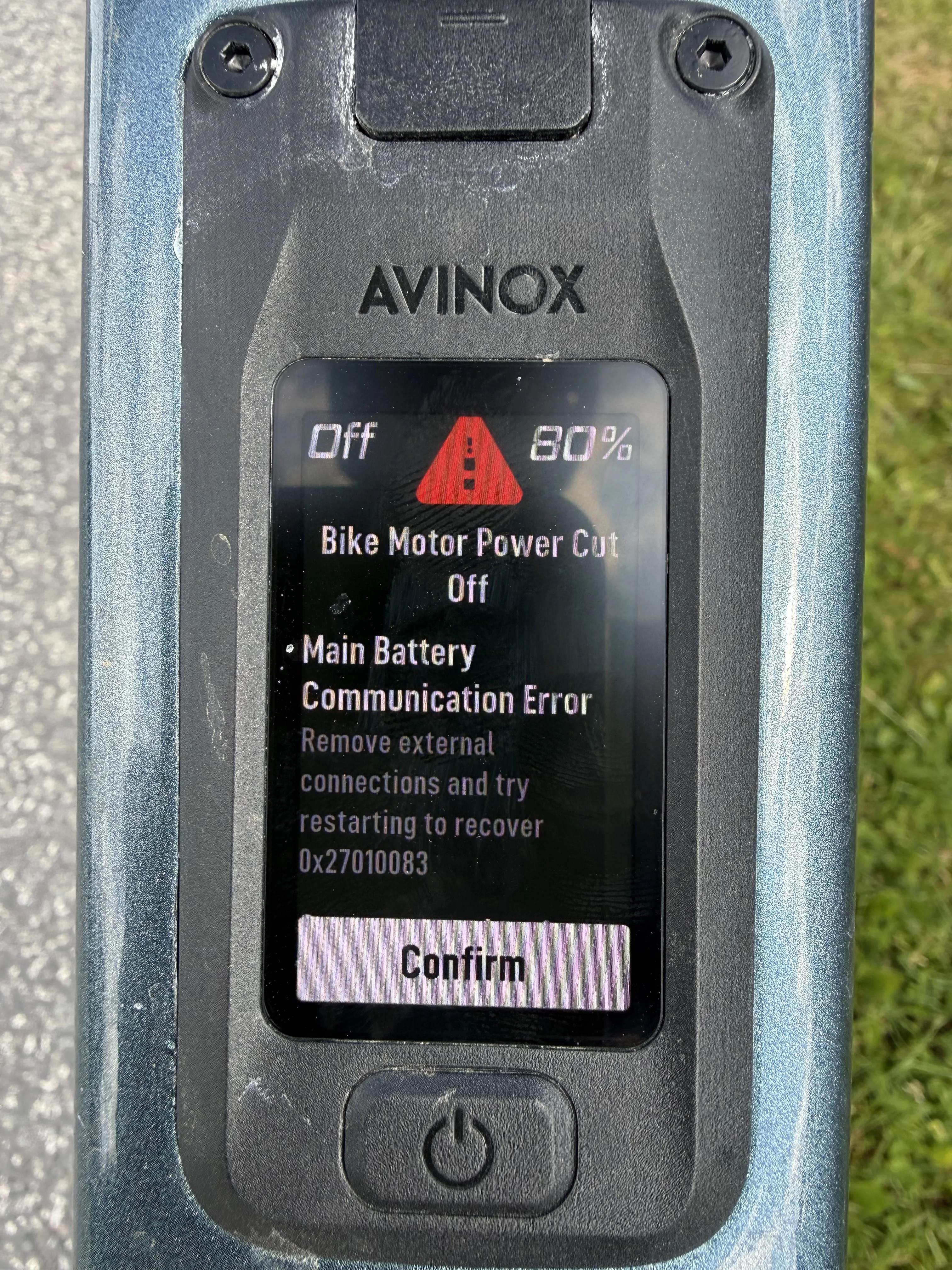

AvinoxM1 problem main battery communication error comes after a few km on the trail. Disconnected all plugs and cleaned but doesn’t help. Has anyone had this problem?

• Note the exact error text/code in the Avinox app when it triggers, and whether it clears on power cycle or needs a rest.
• Check whether it tracks with wet rides specifically — that steers it toward the sensor rather than the main harness.
• Log it with DJI/dealer regardless. The de facto Avinox fix on here for anything that won't clear at source is a warranty motor/harness swap, and reporters found DJI ships replacements to home or dealer within days (owner reports). Don't spend weeks chasing a connector that a swap will settle.
Base rate first though — most Avinox owners never see this, so you're not looking at a doomed bike, just a known niggle worth pinning down.
What's the precise wording of the error, and does it only happen on wet rides? That'll narrow it fast.
This is the error on the screen
