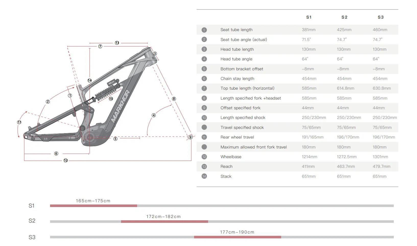

so i found an updated geo chart

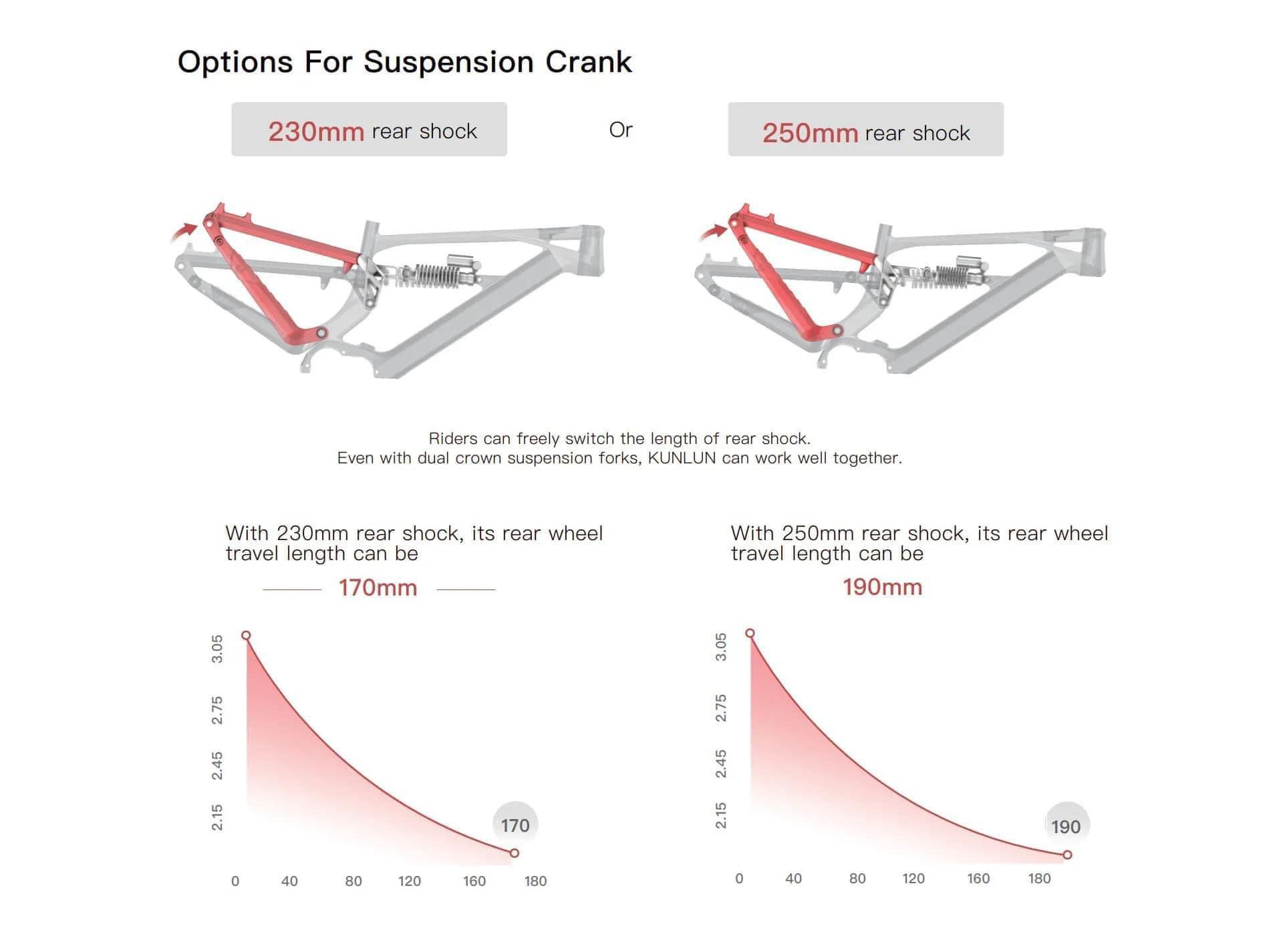

different rear travel can be adjusted with different length rear shocks and yokes.

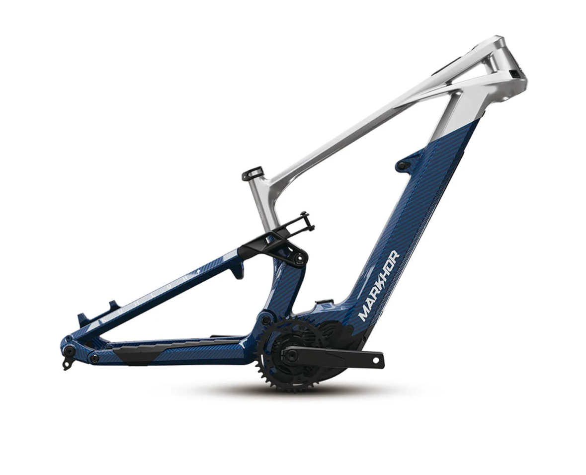

i ordered the frameset in S3 with the shortest yoke for the longest shock possible
250x75 for 196mm rear wheel travel
bushing sizes are 22.2 x 8mm according Markhor.

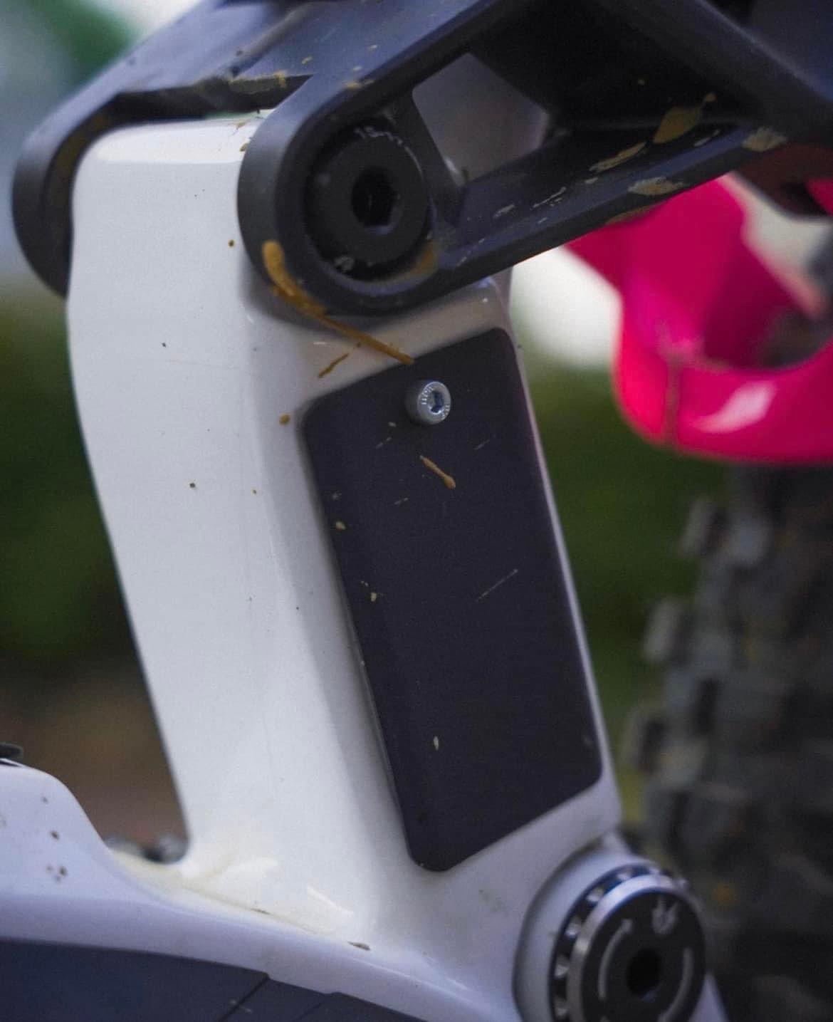

the dropperpost connects to the storage area on top of the motor for easy service of dropperpost cable
also this makes so a long dropper can fit,
have to see this in real if i can fit my oneup 210mm dropper on S3 frame, hopefully it fits..

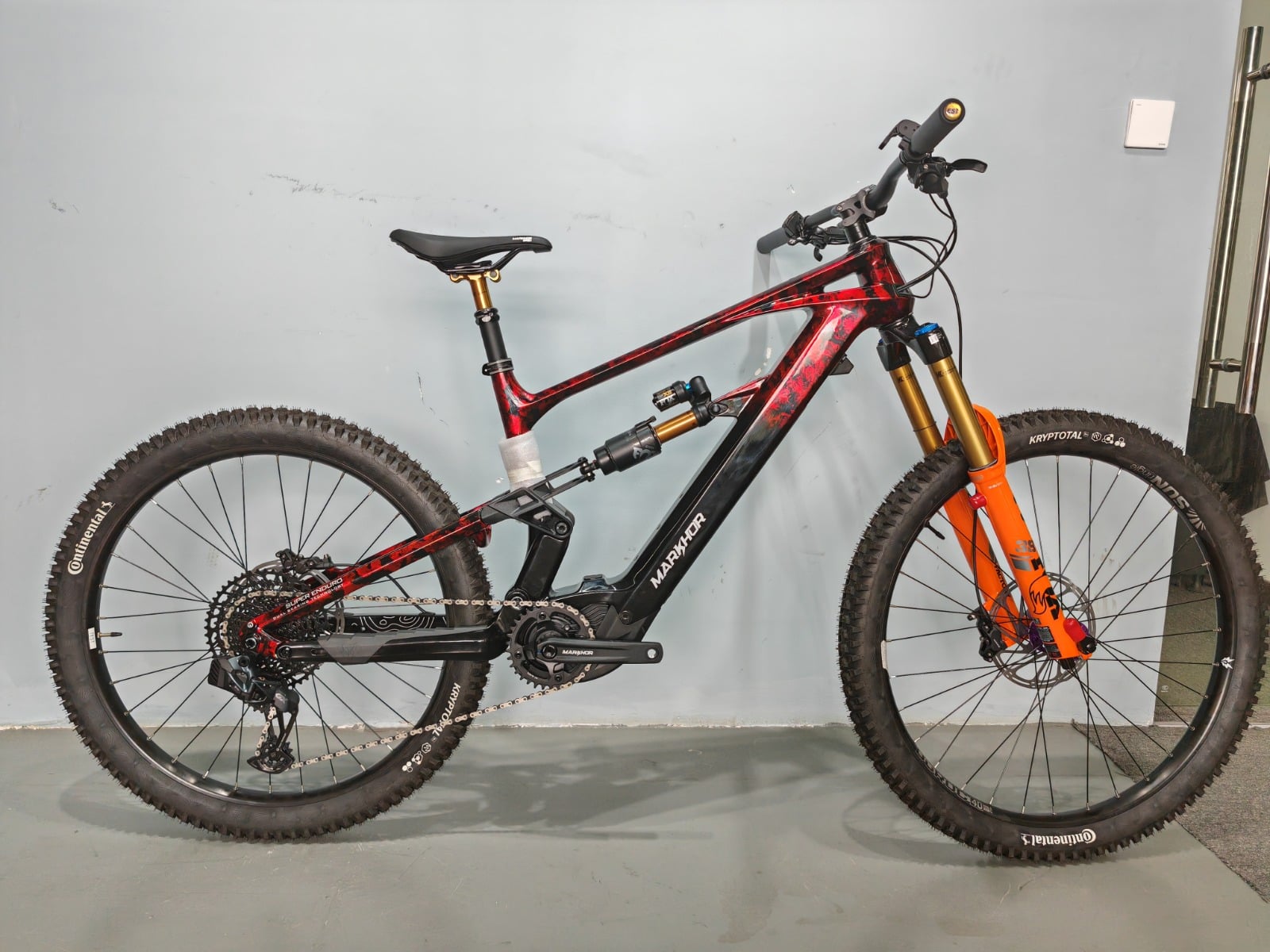

found some more pics 🙃

It doesn't seem strange to you. If you are installing a 250x75 shock absorber, then you should install a 190-200mm fork. And at the same time, the geometry will change.

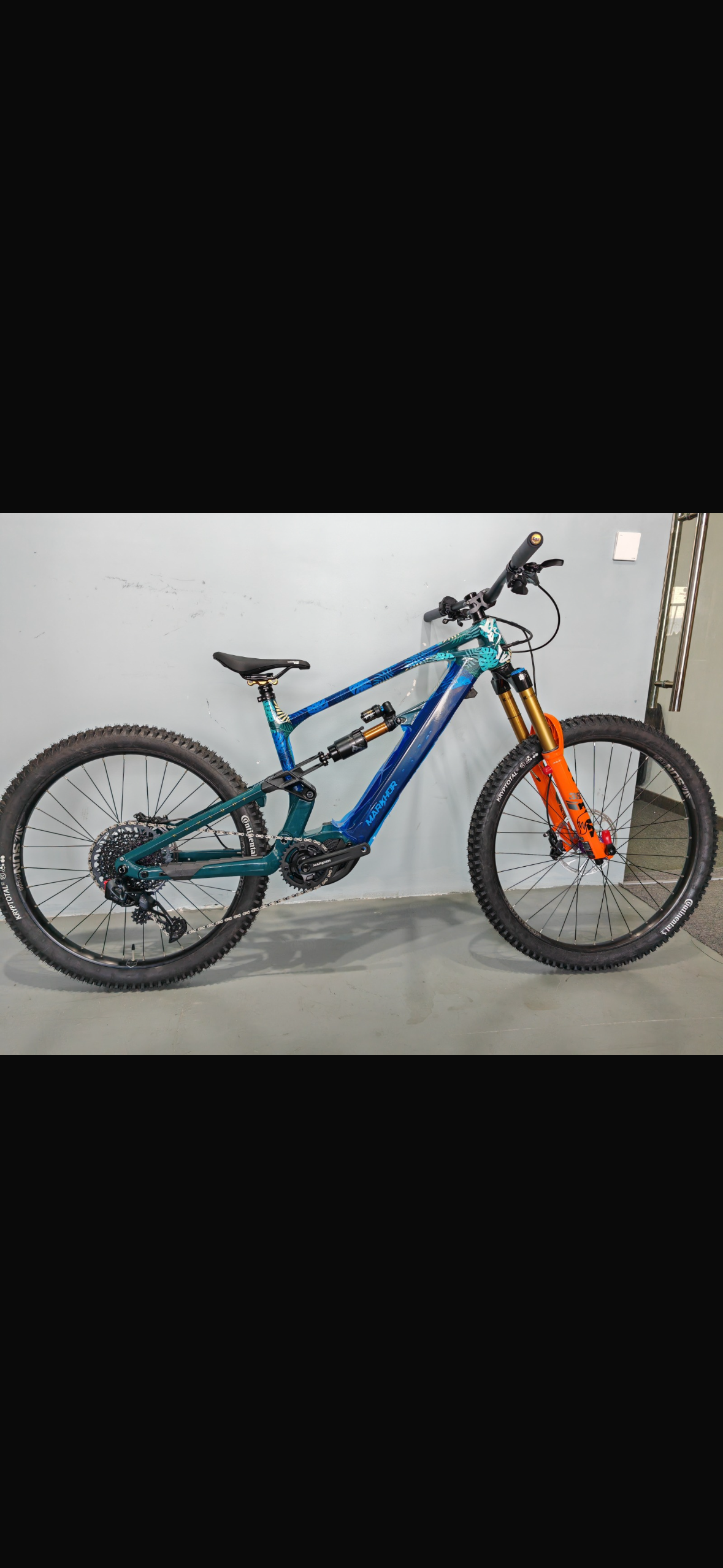

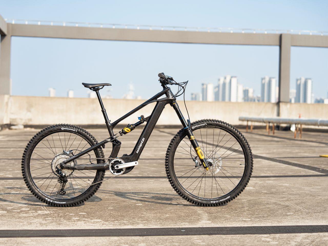

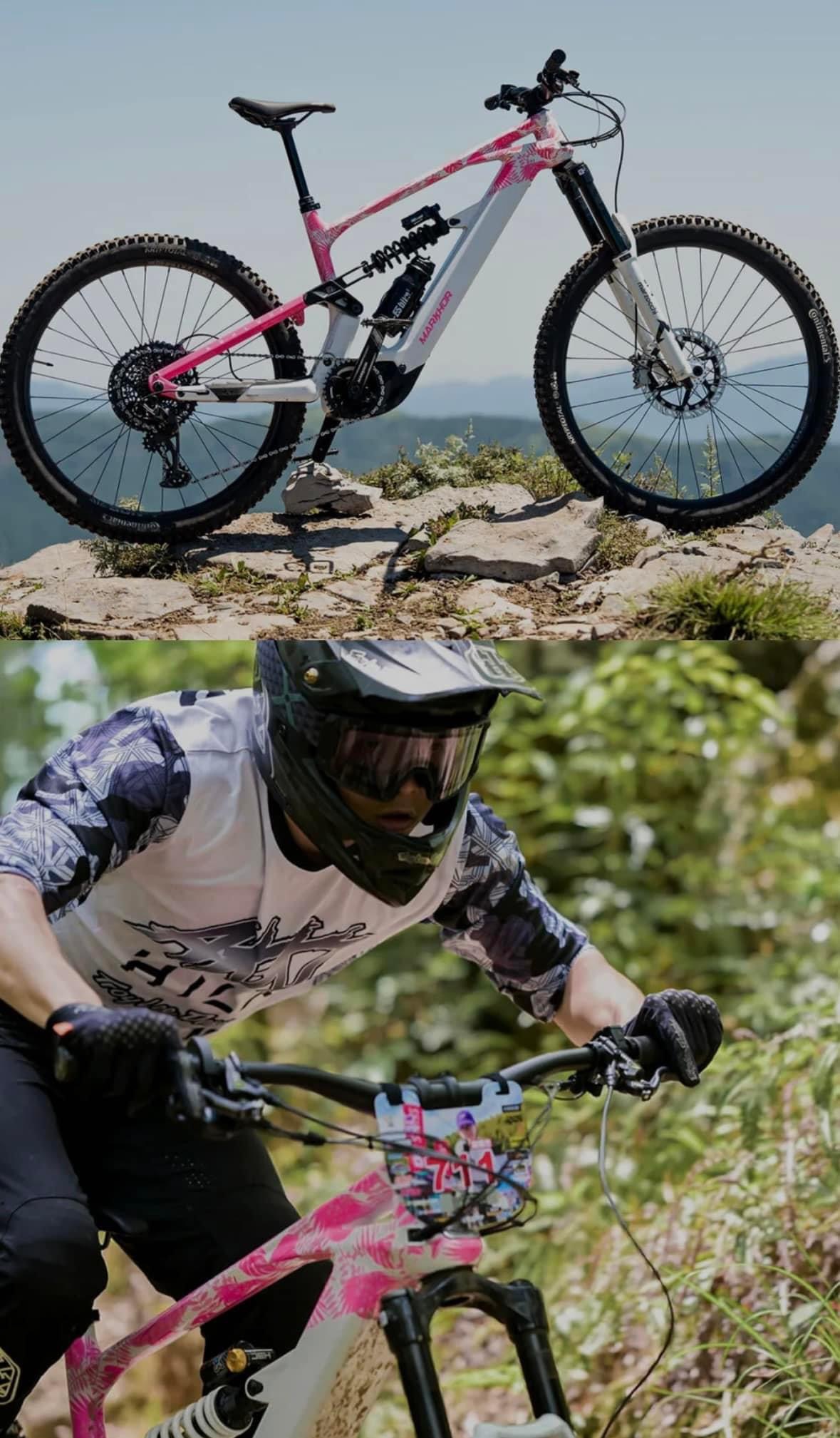

I got a complete Bike from Alibaba. I can say that yes it comes as a mullet setup. 29 in the front 27.5 in the rear. I think it’s a great EMTB I got the size medium (S2) pro spec build because I prefer Rockshox because that’s what I’m used to. If you want to see any pics of my bike let me know. I’ll attach one below. I only upgraded I’ve made is adding Deity pedals and a Deity 80mm rise handlebar. I think it’s a great lightweight EMTB I think it’s like 21KG or something like that. I had a commencal meta power SX race and that thing was heavy af.

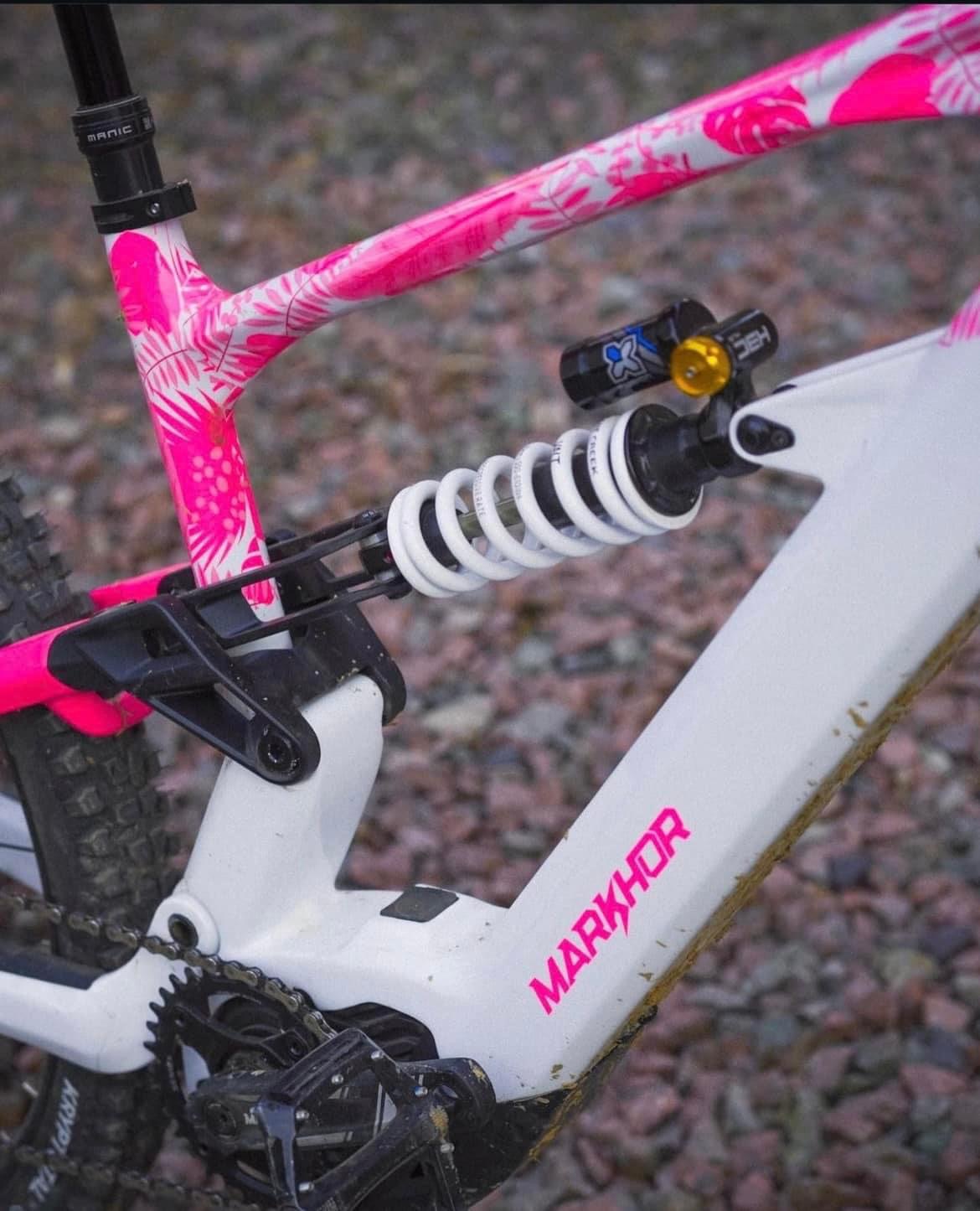

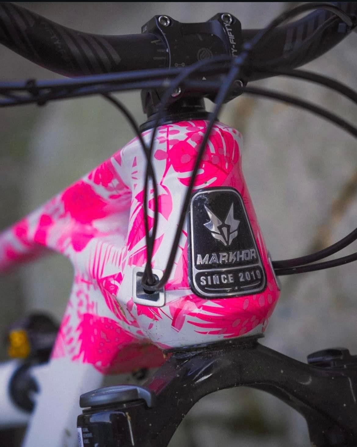

Really wish I had seen this frame before building my E82, strongly considering building one of these up as a Winter project, they look like exactly what I wanted that my E82 fails on: Better overall quality, a little lighter, integrated display, and integrated battery for a skinnier downtube. I see lots of cool paint jobs, can you just request something custom from Markhor when ordering? Any idea approximately what they charge for customization?
they can make the whole bike suit your needs without any diy
yeah this frame has heen much higher quality compared to what i was used to, quite the shock when i recieved it 🤯
