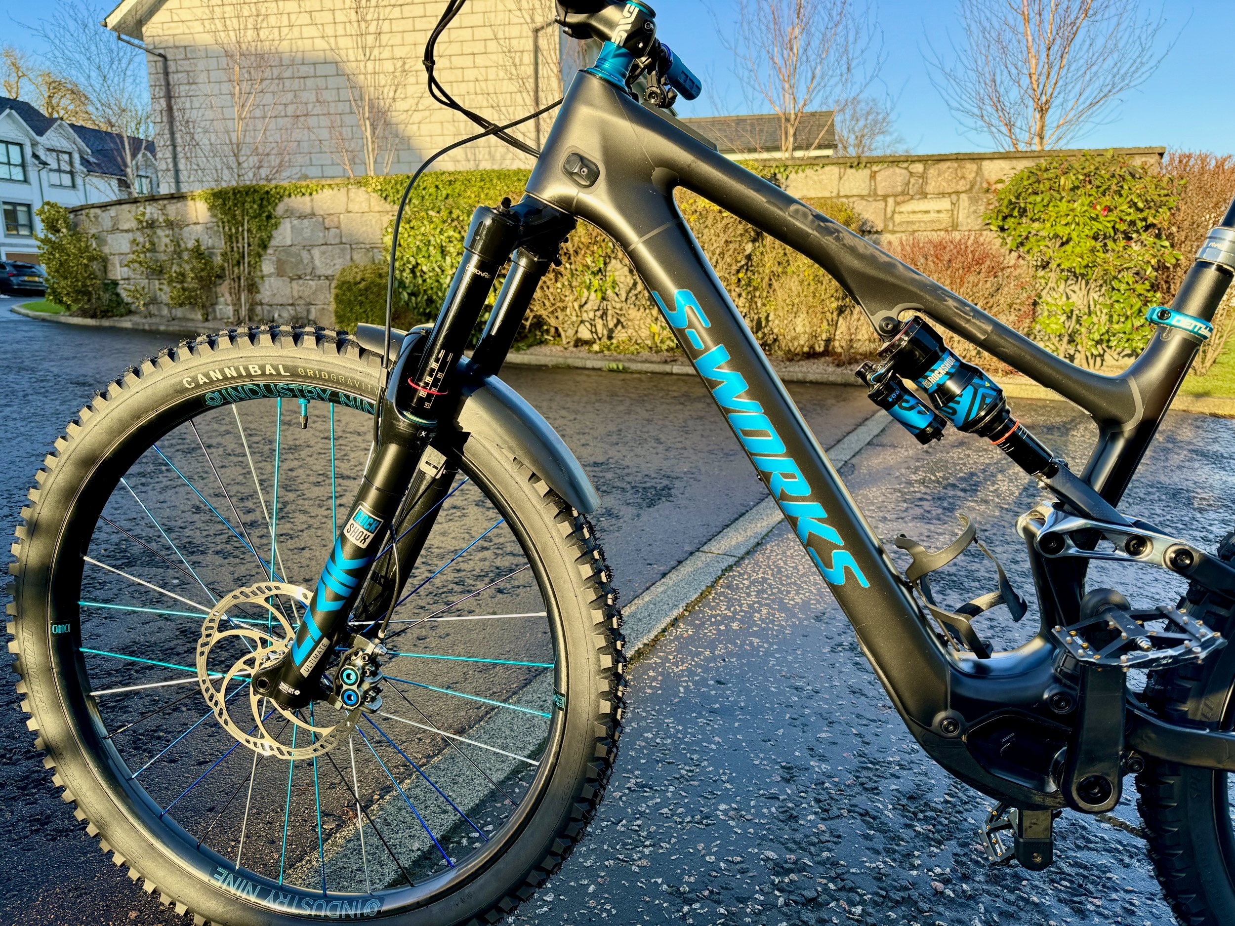

So brakes fitted yesterday removed rear brake and pushed new cable from back to front cable went through ok had to remove cable guide at top of frame as it was hitting it
bLed back brake took ages and 2 attempts to get any feeling in the lever other than hitting the bars 😛
but got there
then seen this vid and followed it worked a treat back brakes feels super strong
now just have to bed the pads in tried last night but zero stopping power
gonna give it a go this morning and see if i can get it to actually stop me
front brake feels pretty good but again need to bed pads in properly
but first need to shorten cable as it’s way too long have some barbs and olives coming today from Amazon
so will use the quick bleed vid again once Iv shortened cable
can’t believe they only gave me 1 olive and Barb for a full set of brakes 😝

Shortened front cable and all good quick bleed and good to go
Back brake feels great
Front needs a little work but currently on a nice little coast ride so plenty of time to bed in properly

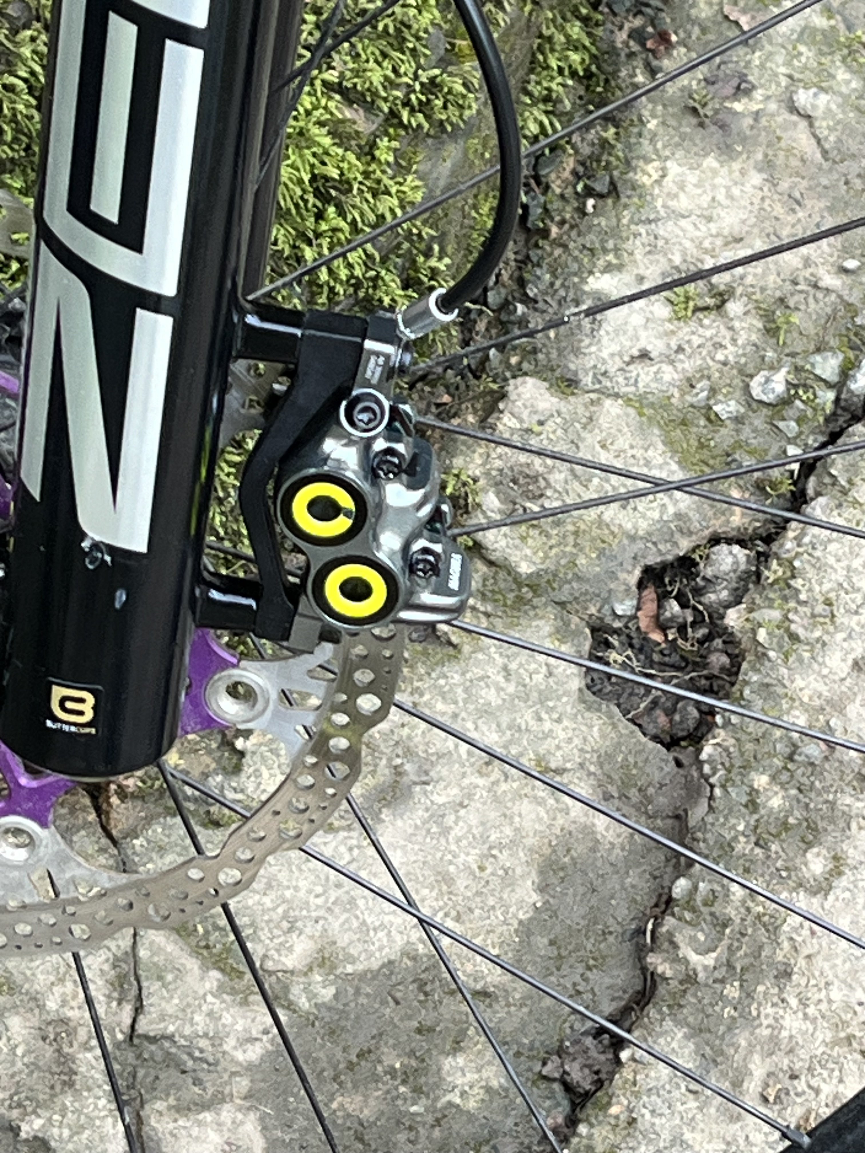

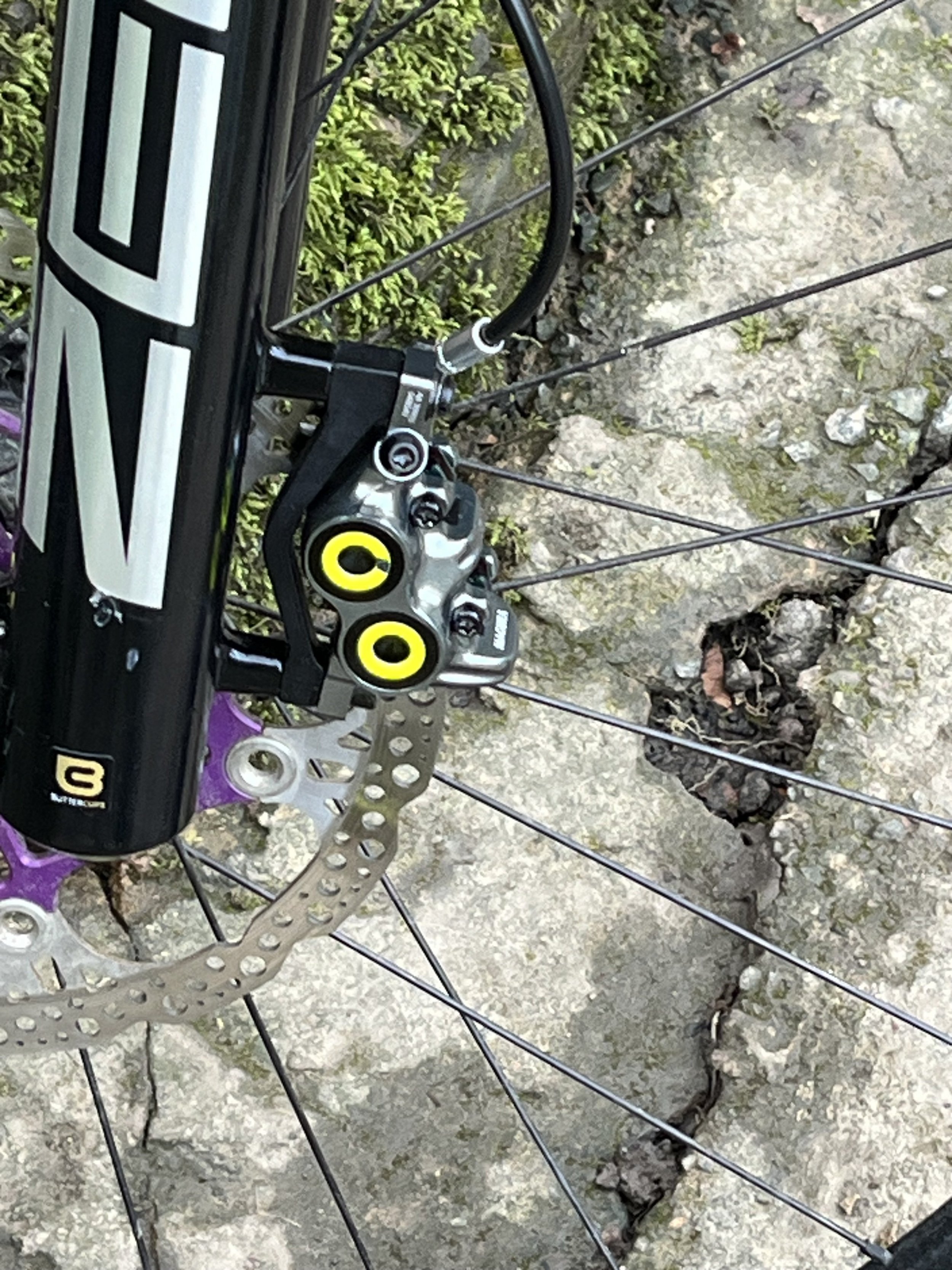

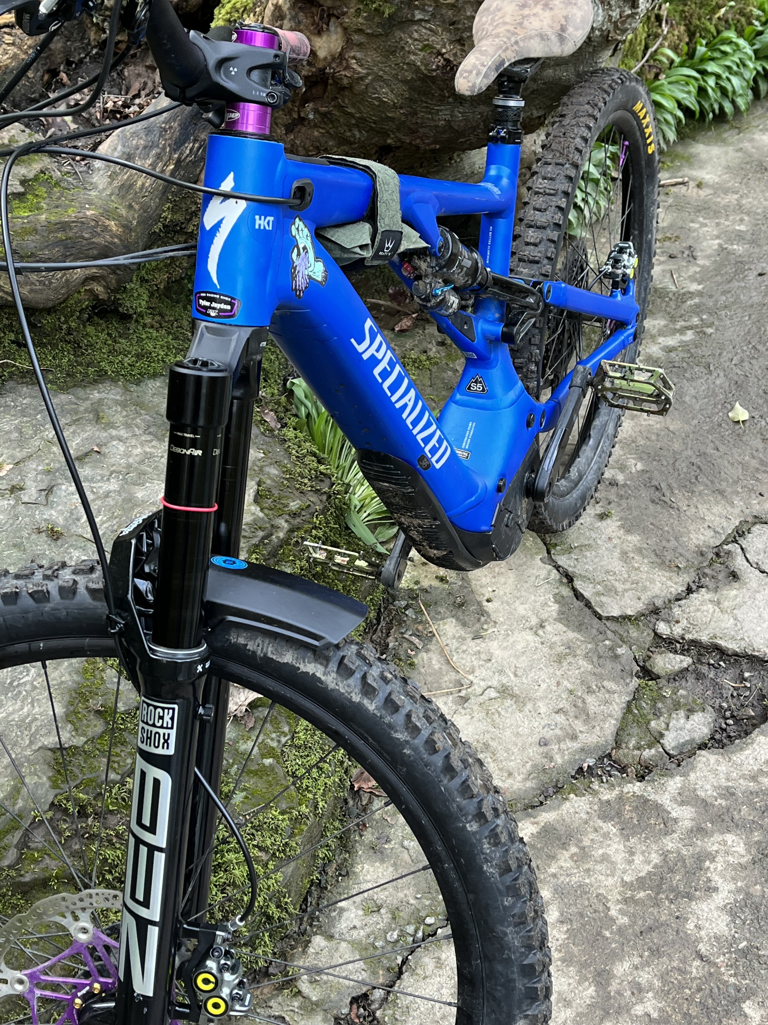

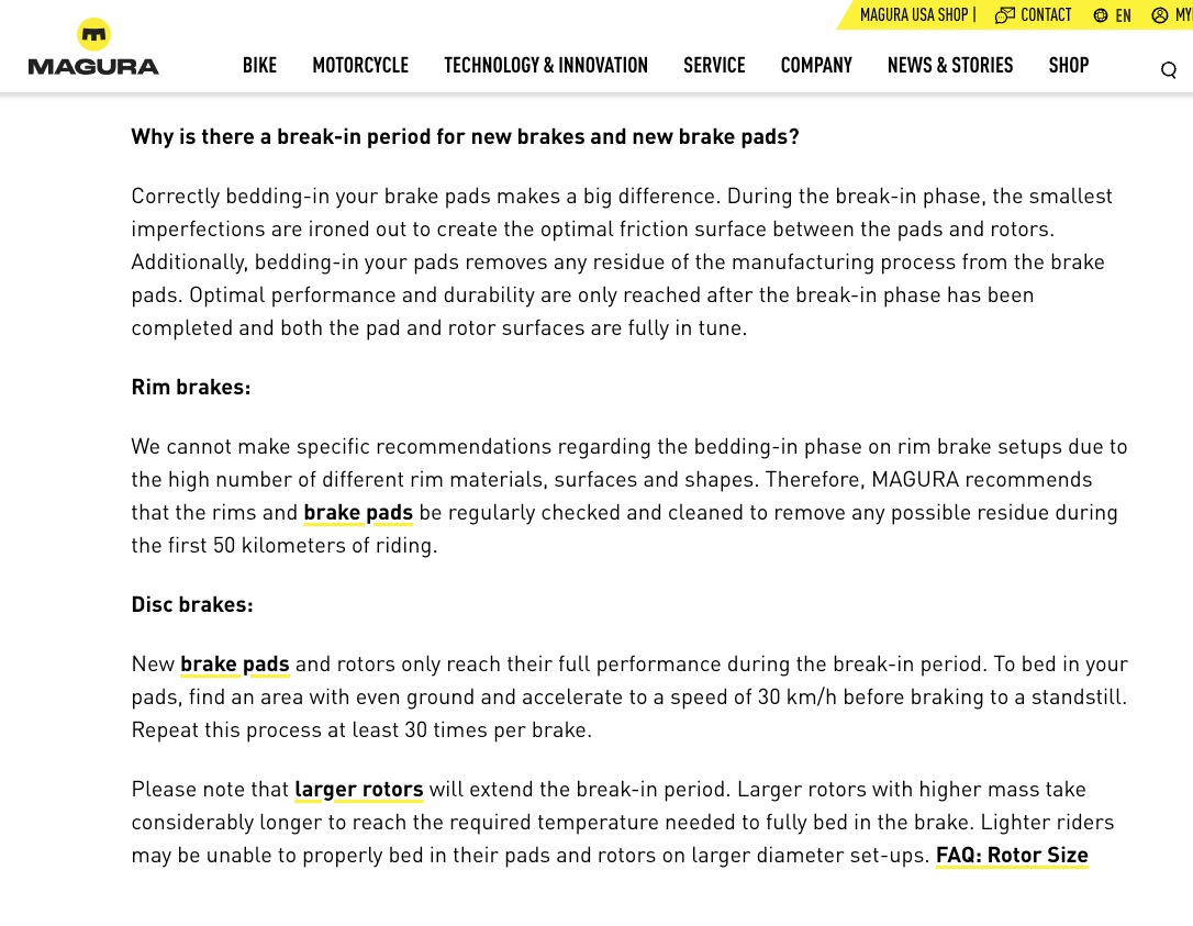

Pretty sure you should NOT do a full stop during bedding, as that could cause pad material transfer. I get to speed and brake to 3-5 MPH a few times with moderate pressure. Then repeat with high, but not lockup pressure.
What would Magura know? 🤷‍♂️
Apparently they "know" the opposite of Galfer. So I continue to use my method and you should use yours.
Fair enough. I'm using Magura rotors, brakes and pads... so I'll stick with their method.
It certainly worked, as the stopping distance from stop 1 to stop 10 was unbelievable. 10-30 didn't improve by much.
As per the OP, my brakes had very little stopping power until I bedded them in.

View attachment 136633 View attachment 136634

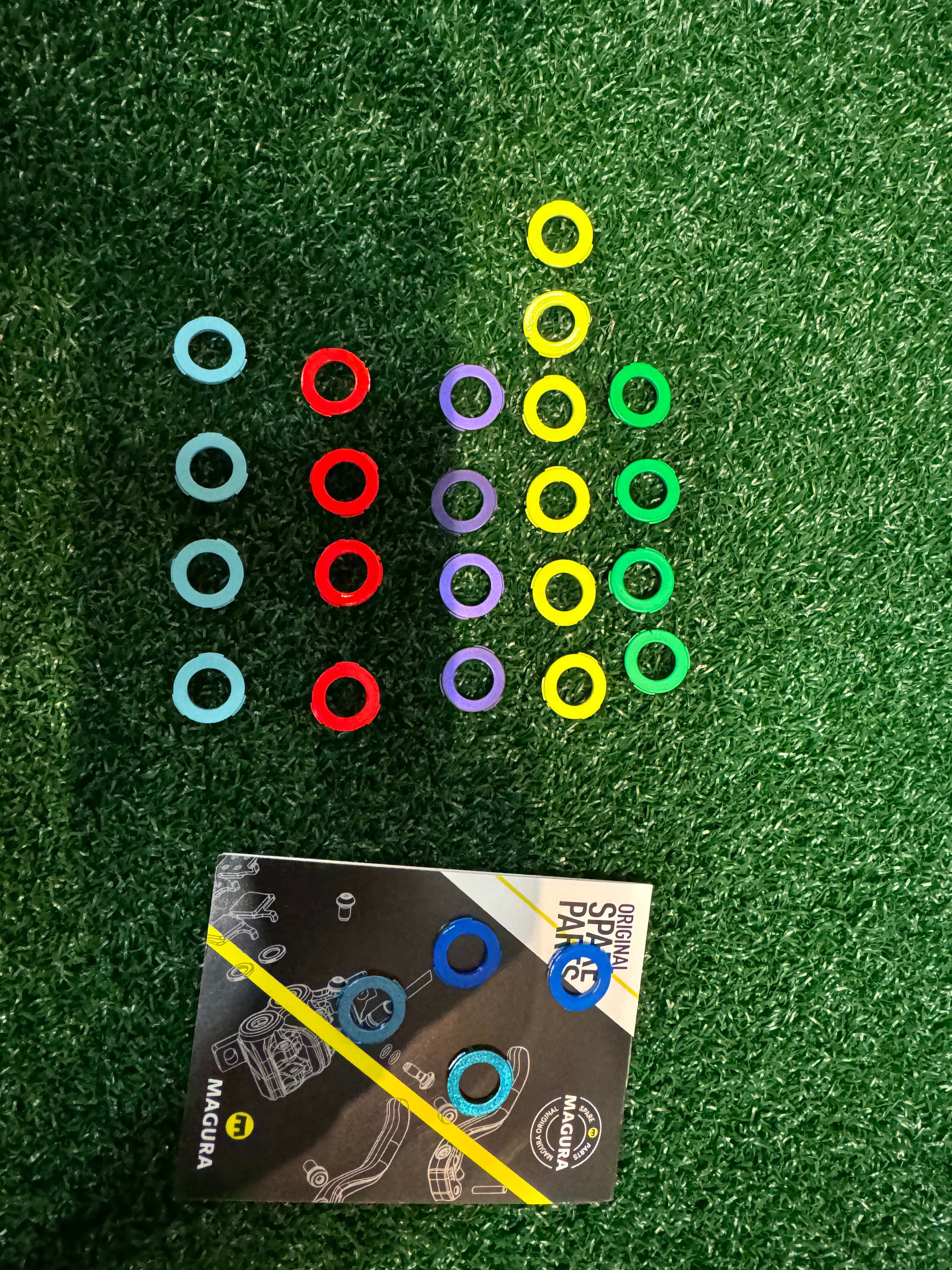

I wanted the Red calliper rings for my MT7’s, to match other bling, so I had to order a 12 pack. Friggen expensive! Then I saw this…
$0.79…ffs.
I wanted 2 different blues to match my spokes... so I had to order 2 packs of the bloody things to get the colours I wanted.
I had purple on my previous bike... I must have a box of spare rings somewhere, as they were a different pack too.
£12 for a pack of 12 3different colours
Think ill order a pack as my bike has purple and a bit of pink (grips)
Although I did message Magura saying one is cracked. See if they send me a spare

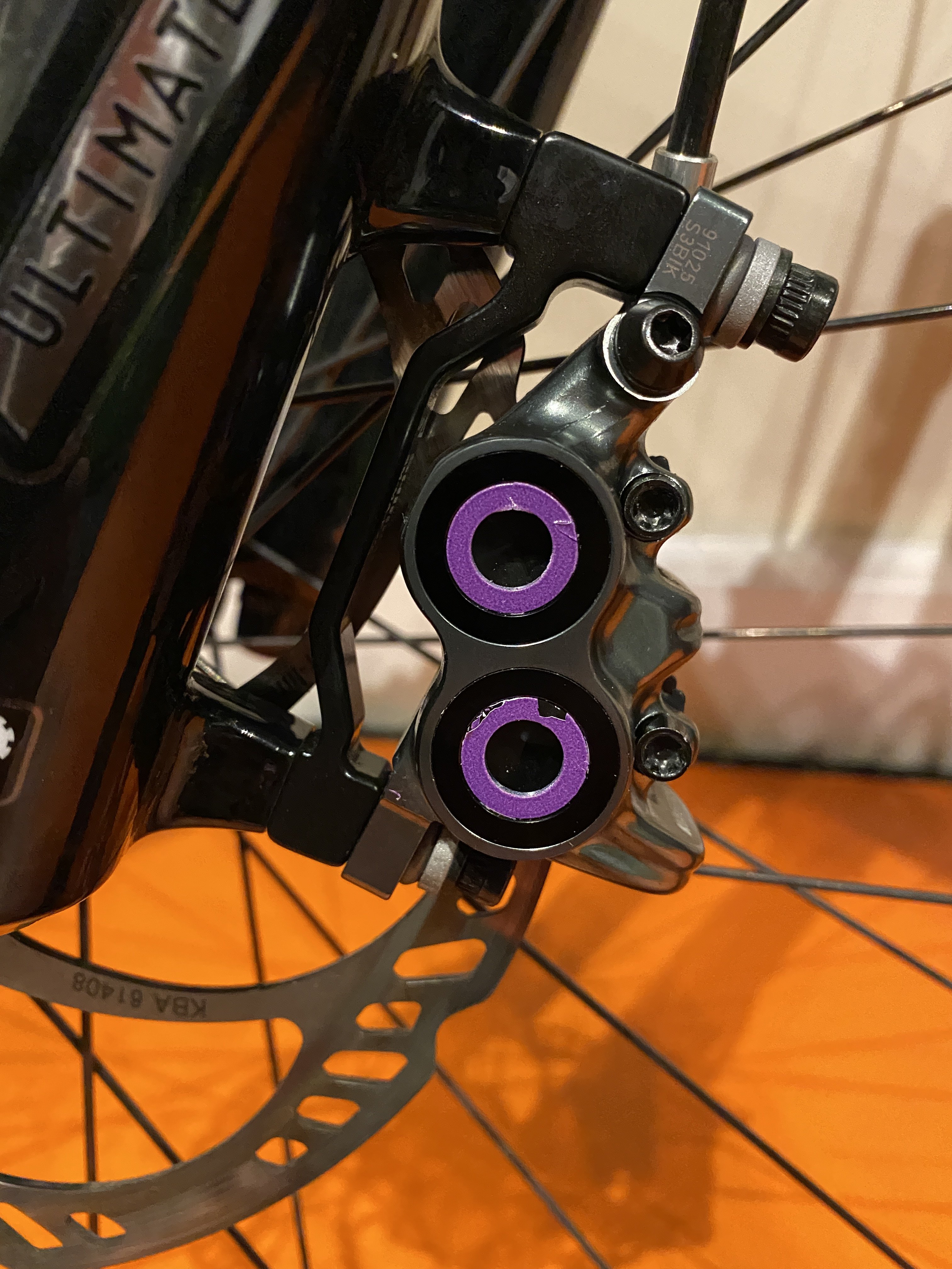

When I bought the purple ones about 4 years ago, each one I pushed in cracked. It was like the new ones were brittle. I emailed Magura support, and they sent me out a new pack… along with some nice Magura biro pens, and some stickers 👍
The replacements went in perfectly.

Here’s my spares. I’m keeping the 2 x 2 different blue ones sitting on the packet (as they’re the spares for mine)… but can easily send you a couple of yellows to replace the broken ones… or 4 of any of the coloured ones?
It’s was “[email protected]” that sent me the replacements.
I had to send a photo, and they sent some out a few days later. 30th March 2020 - near the beginning of Covid.

Great thread and thanks for the tips. I’ve just upgraded to the MT7s (transferred from the old bike).

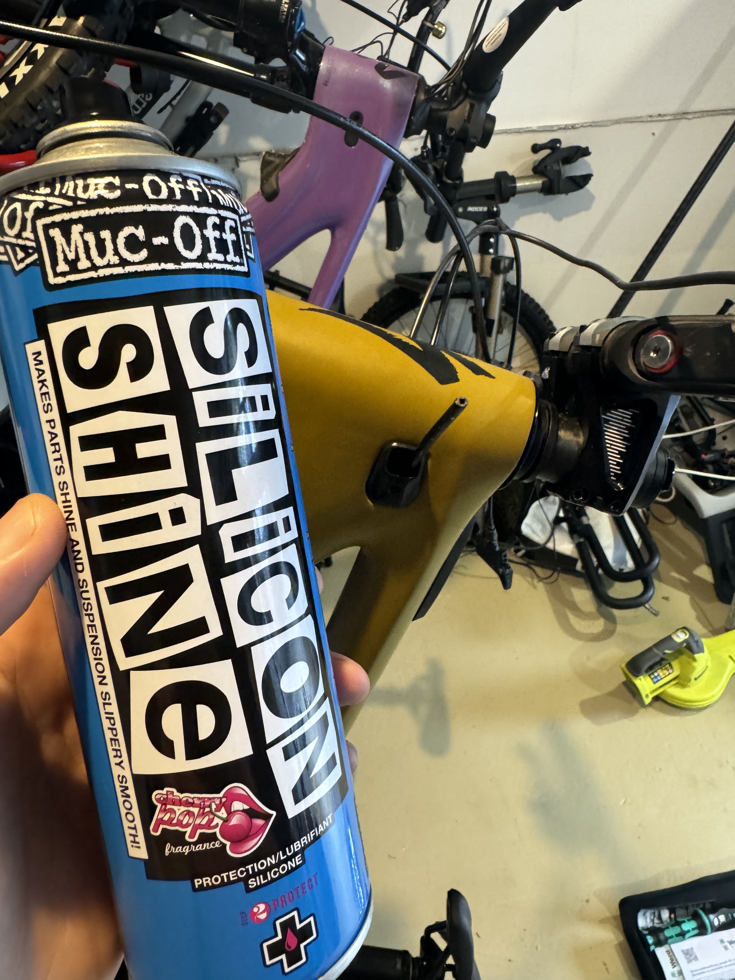

Installation was incredibly straight forward, I sprayed some silicone on the external part of the brake hose, and also into the frame routing and the brake hose just flew straight in and out. If you use silicone just make sure to protect all braking surfaces otherwise you’ll trash your pads before you even use them.
I didn’t know you could change the calliper rings until this thread either, so thanks for helping get the match right for my frame. Had a great ride yesterday, loving the Maguras on my Levo.
I didn’t know you could change the calliper rings until this thread either, so thanks for helping get the match right for my frame. Had a great ride yesterday, loving the Maguras on my Levo. View attachment 136921
Good tip about the silicon Mine went through but was tight in a couple places but overall no problems
