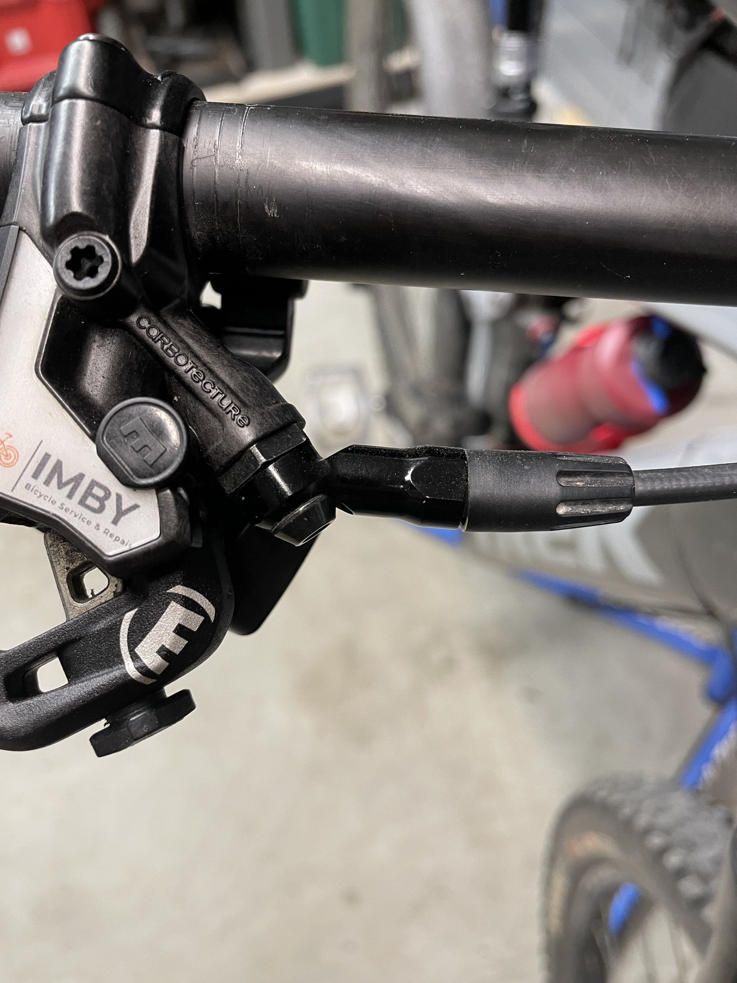

Check to see if there is any oil on the hose, around where it joins to the lever it’s might not like the olive & barb used or the 8mm bolt into lever could be nipped up a bit more

Had this a few times, the 8mm hose bolt for compressing the olive is 4nm, that’s actually a lot tighter than feels comfortable with all that carbotecture plastic!

I’ve only installed about 6 MT7 brake systems. One thing that was suggested to me was to lightly wipe some grease around the olive (new) before it’s installed. Always use a new olive and barb for installs.

Could try chopping the olive off and putting a new one on. I think there’s enough excess on the hose.

If the brake line and barb are not held securely in place during installation, the final seat will not be correct when the olive is pressed or crushed. It will leak.

I’m going to borrow a hose cutter from work and re-do the connection tomorrow and see if that works any better. I’ve removed both bleed screws and checked them, but they both have ‘new’ looking seals and there is no debris or anything in the threads. Can’t see it being them leaking.

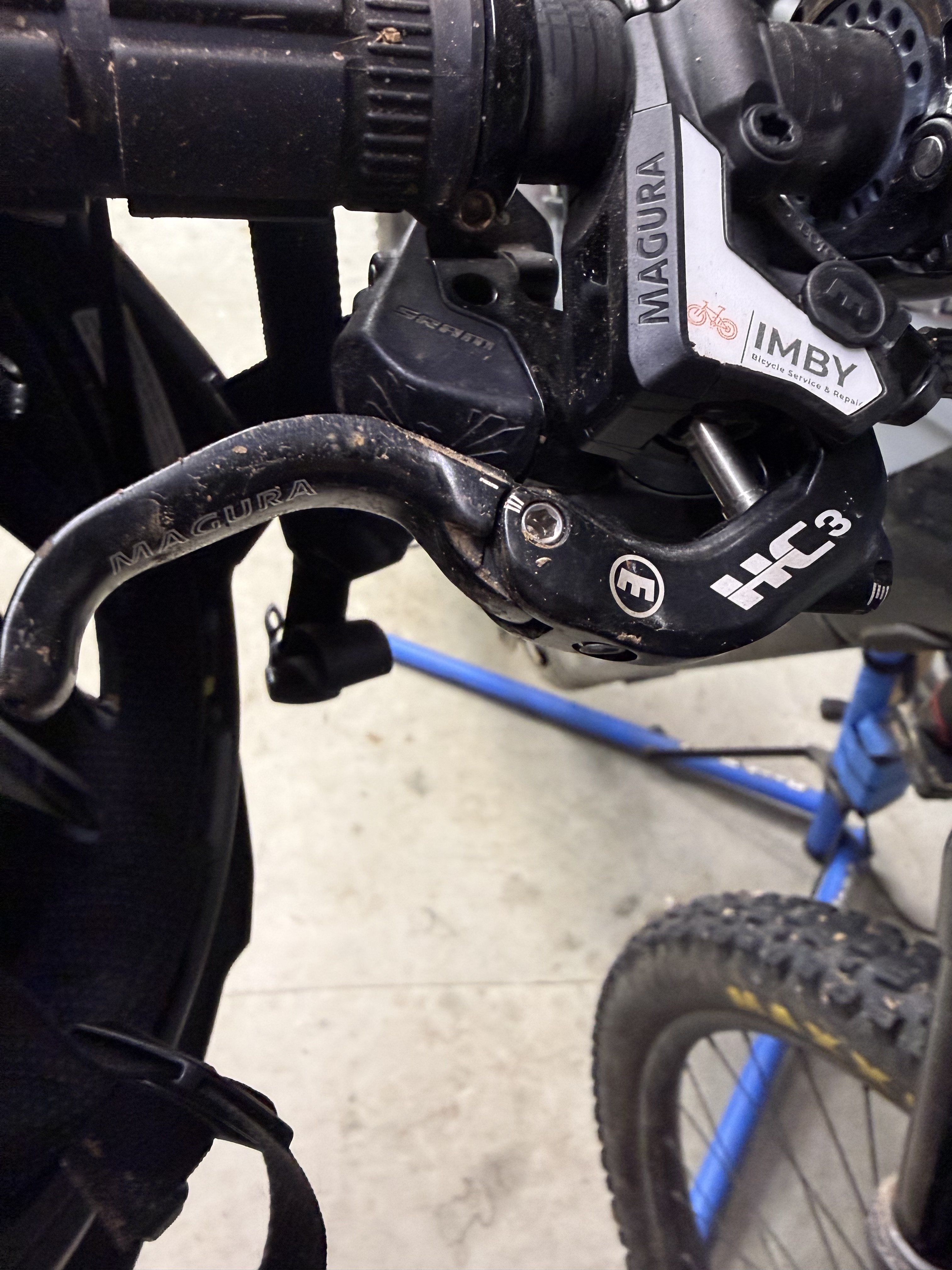

Ultimately I cut the crappy plastic levers off and fitted Shimano xt ones instead. Perfection.
I did the same. Replacement Magura levers were ridiculously expensive, Shimano XT less than half the cost. Completely different feel with bugger all modulation, but I prefer that to how the Maguras felt. I also had endless arguments over a leaking banjo crimp on a brand new hose I fitted, Magura would not warranty without me sending the whole brake set to them for testing - complete bullshit. Had to buy a second hose because I didn’t have time to waste on that process. In summary of Magura: fantastic calipers, average levers that failed within 2 years, worst customer service for what is supposed to be a premium product.

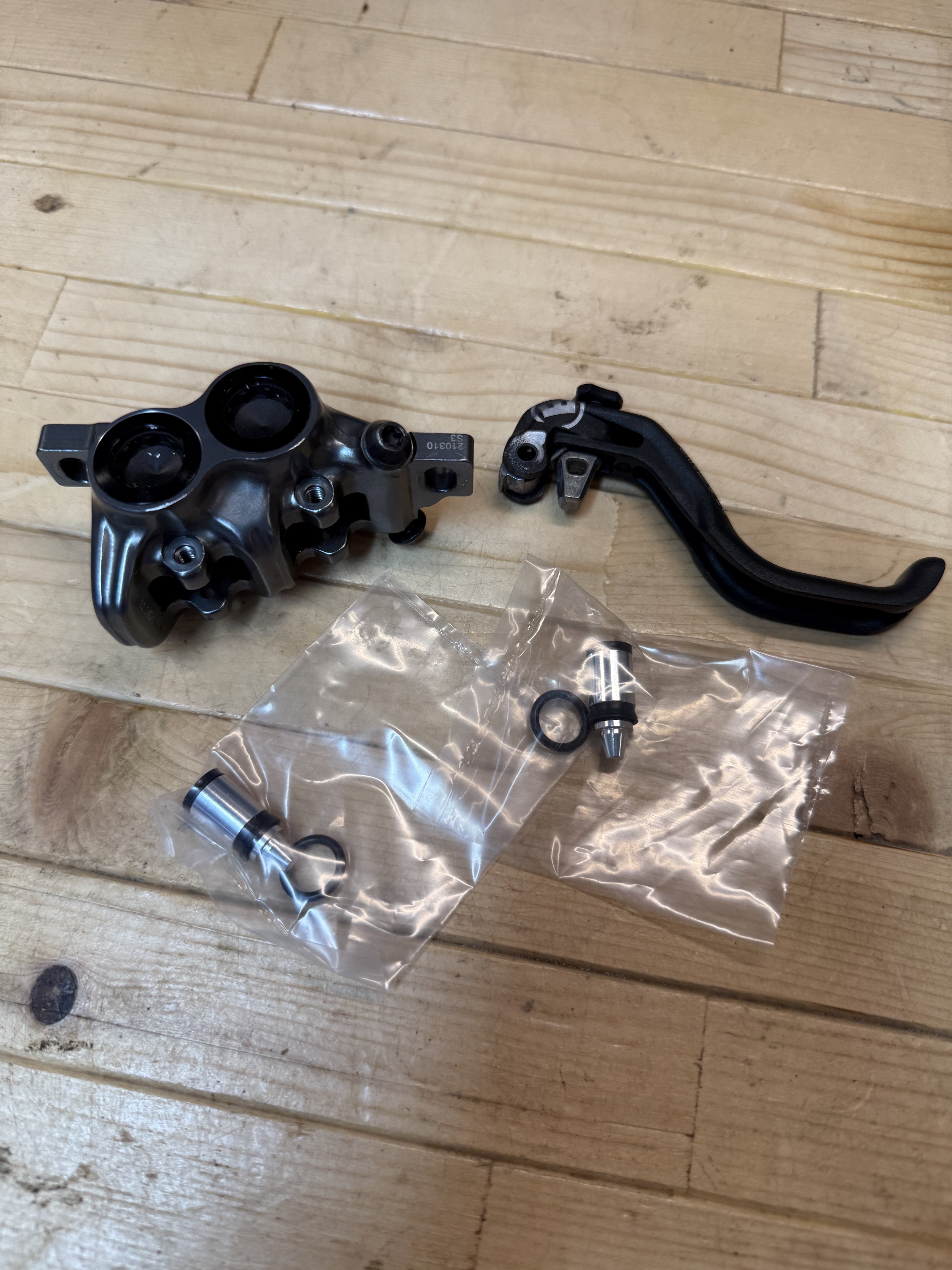

Rebuild parts are available for the MT7’s, MT8’s and MT5’s master cylinder. A small T9 torx and wrench is all you need.
I’ve replaced pistons and seals, and different levers for the master cylinder.
The calliper requires a special torx-type socket for seal and ring replacement.
A full bleed is usually needed after replacement.
