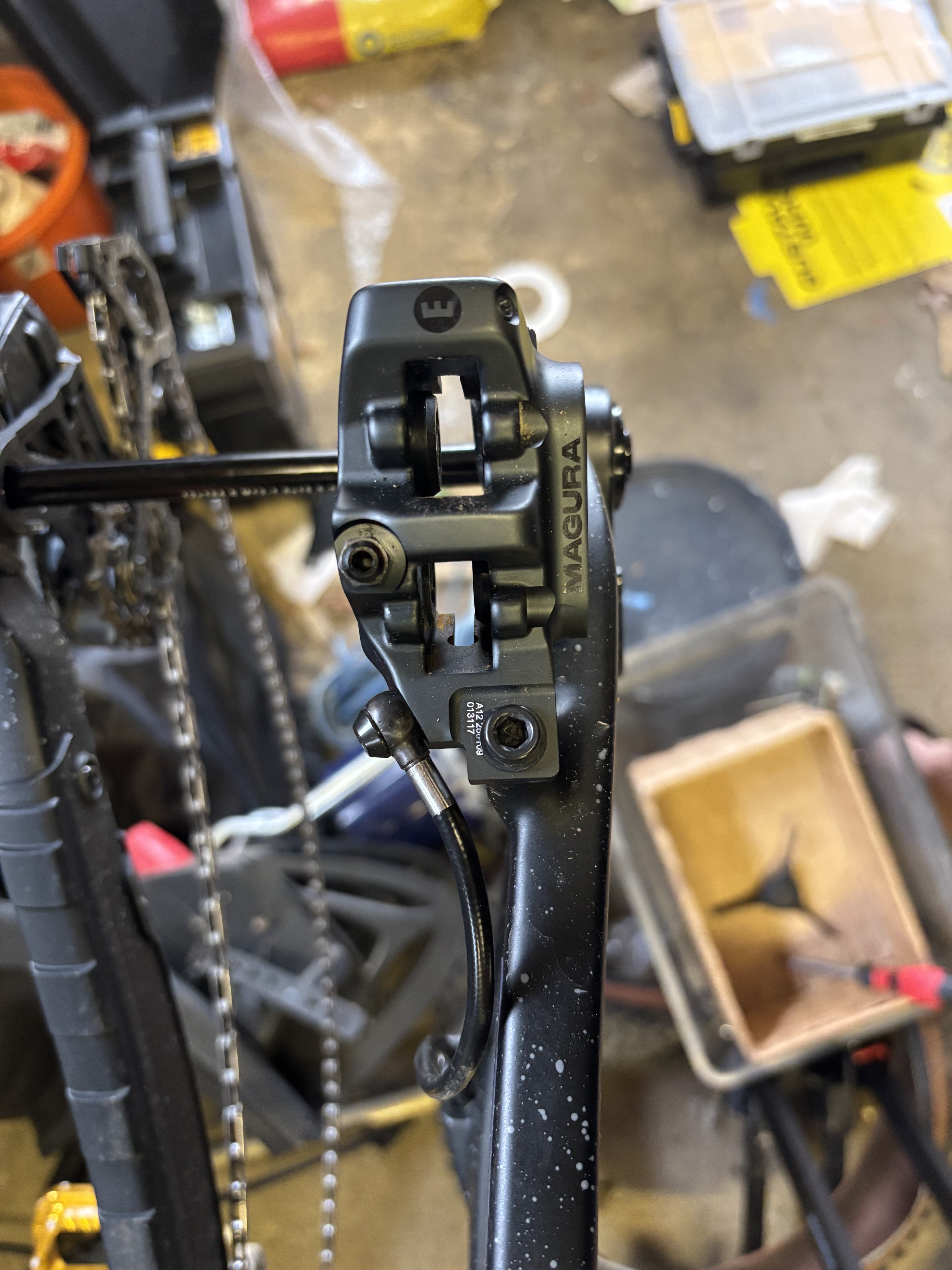

Struggling to get my Gustavs setup
They were squealing like mad on the first ride

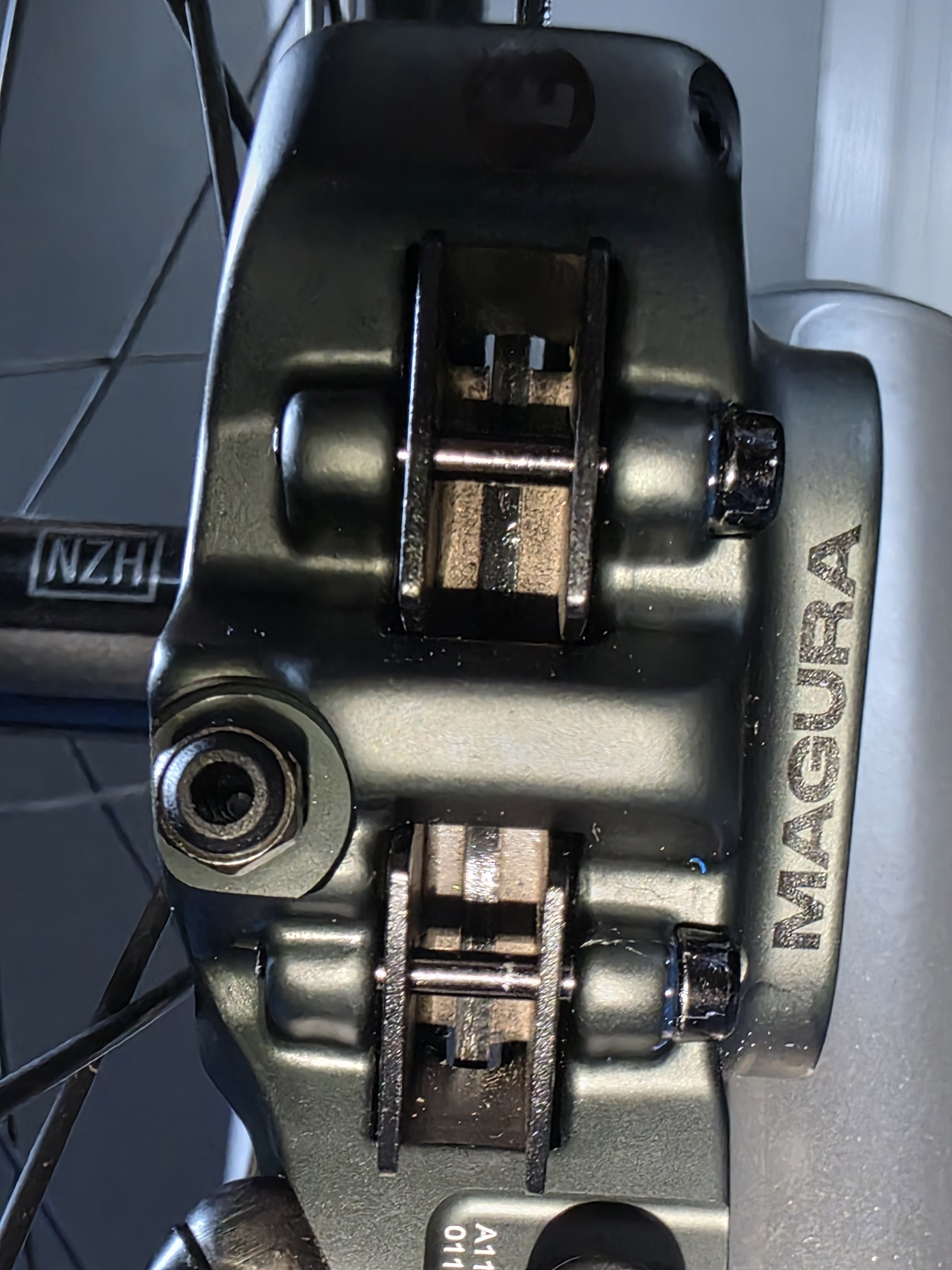

I’ve noticed now that when pulling th levers not all the pistons move at the same time
I’ve tried the tool to only let one piston move at a time but still uneven when pulling the lever picture shows. 2 pistons moving and the other 2 still in the caliper 🤷🏼‍♂️
Any advice or previous experience with these brakes?
Pull the pistons beyond the seal just a little tiny bit (like the one you have already) and lube it. Push it in and out a few times and then bleed. Seems like they're sticking.

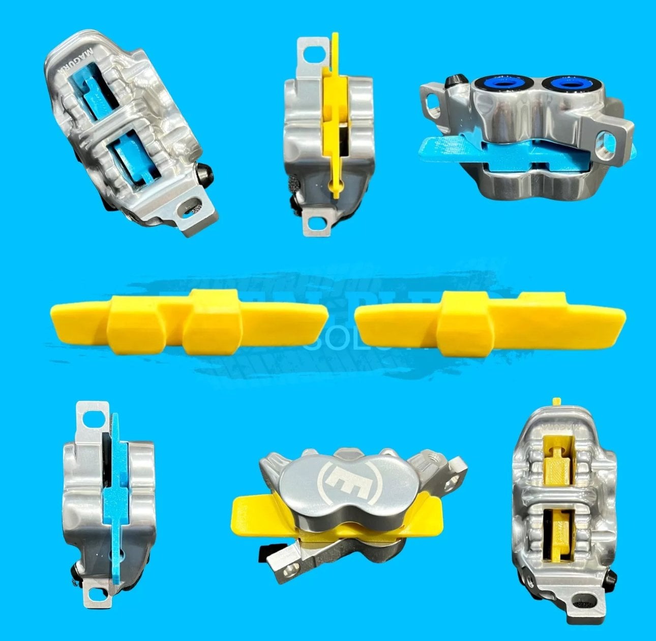

I have this tool
So essentially push 1 piston out and rub some royal blood round it with a cotton bud?
That’s what I would try first, wheels off, pads out and some brake cleaner in there to get the grit out to start and see how you get on.

You can pull the pads and stick the yellow tools fat end first with the slot going over the disk to align the caliper.
