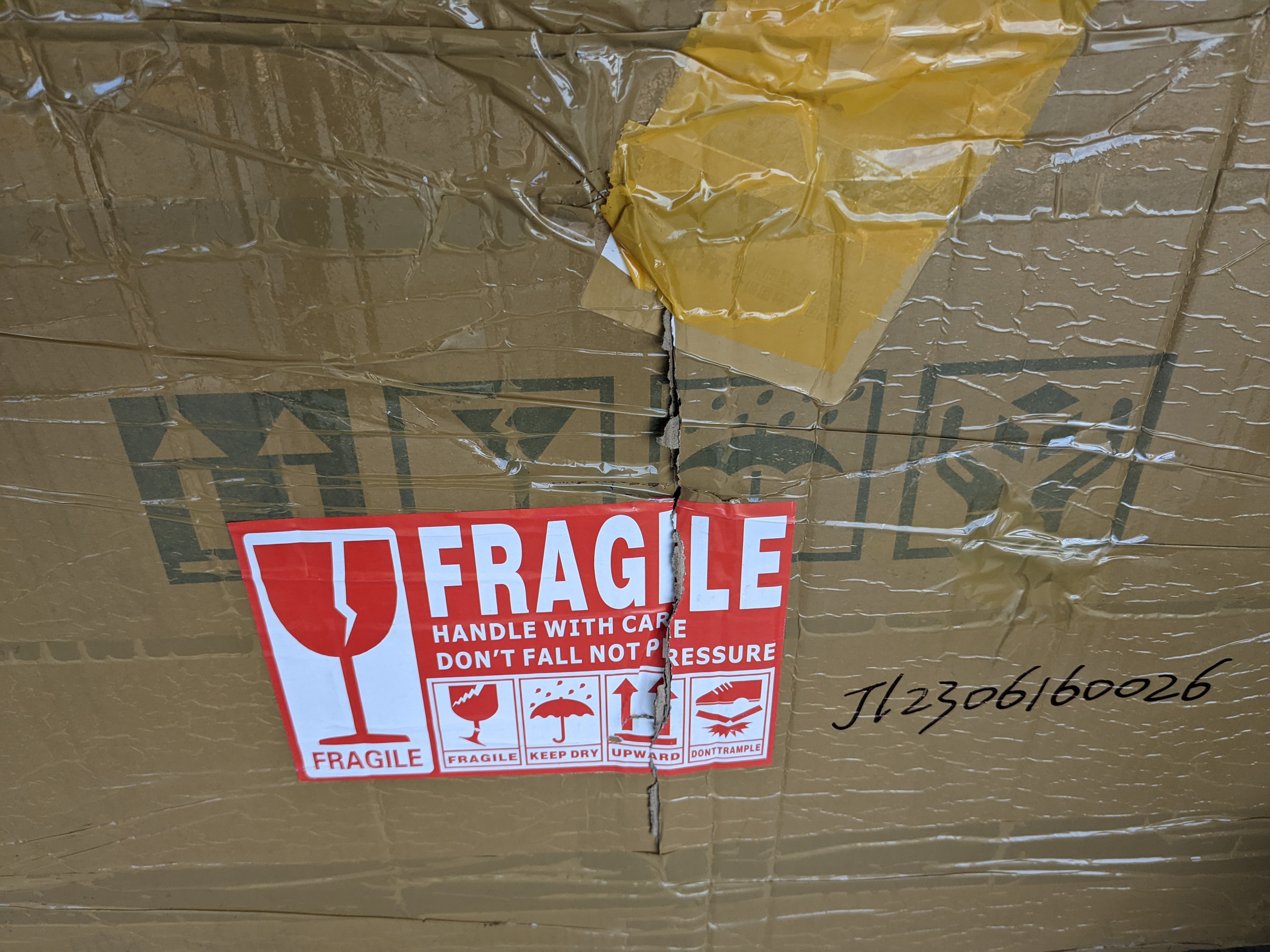

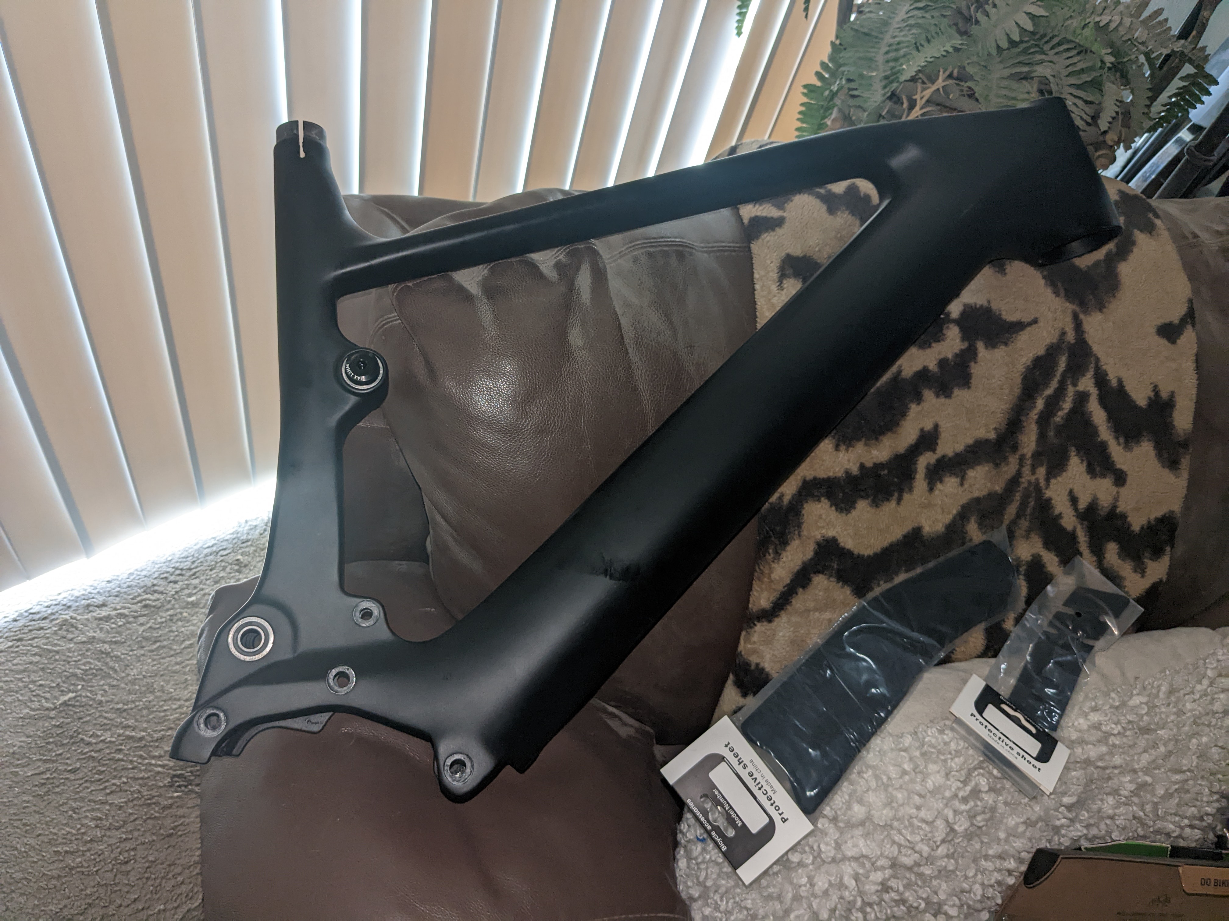

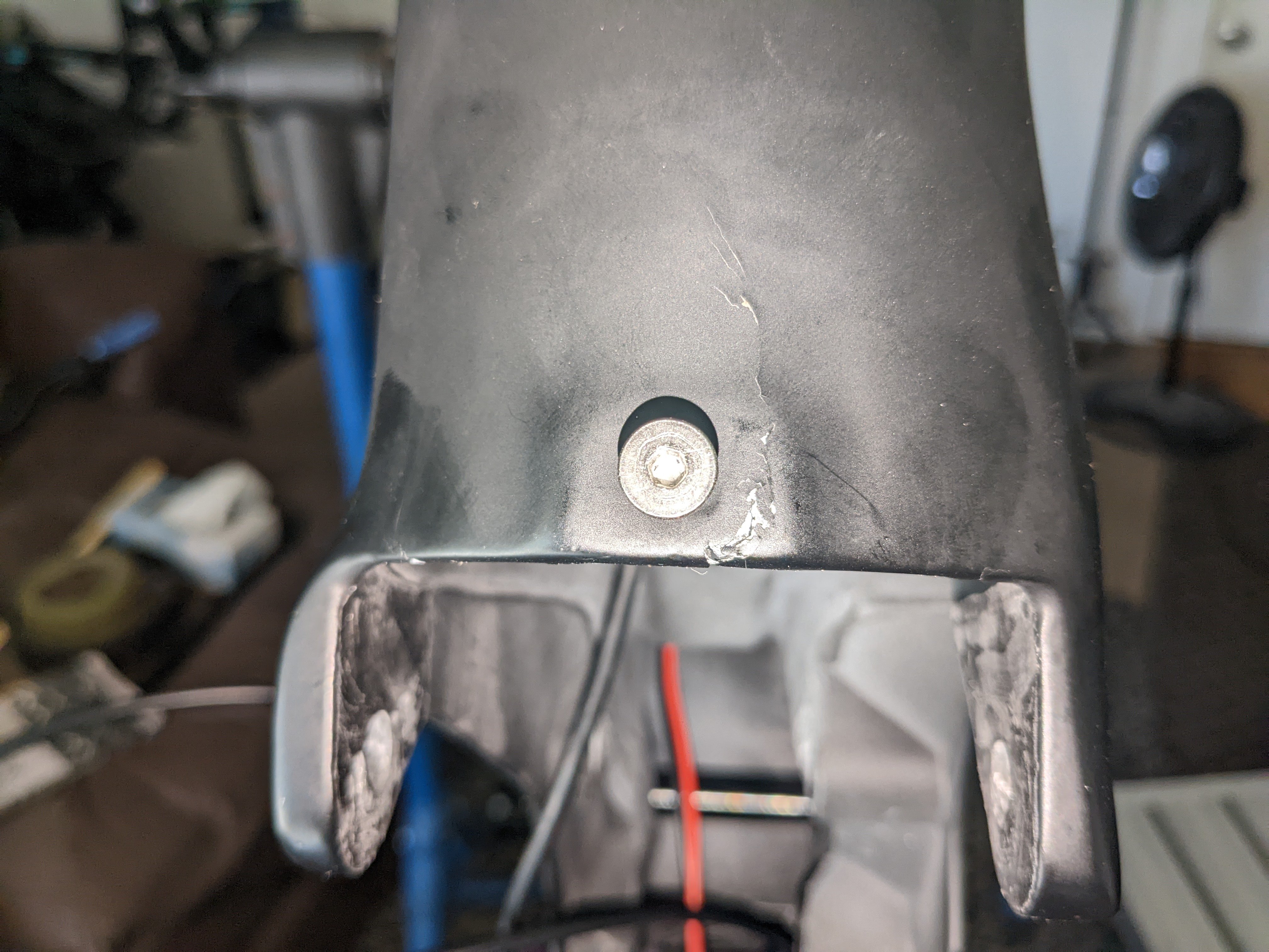

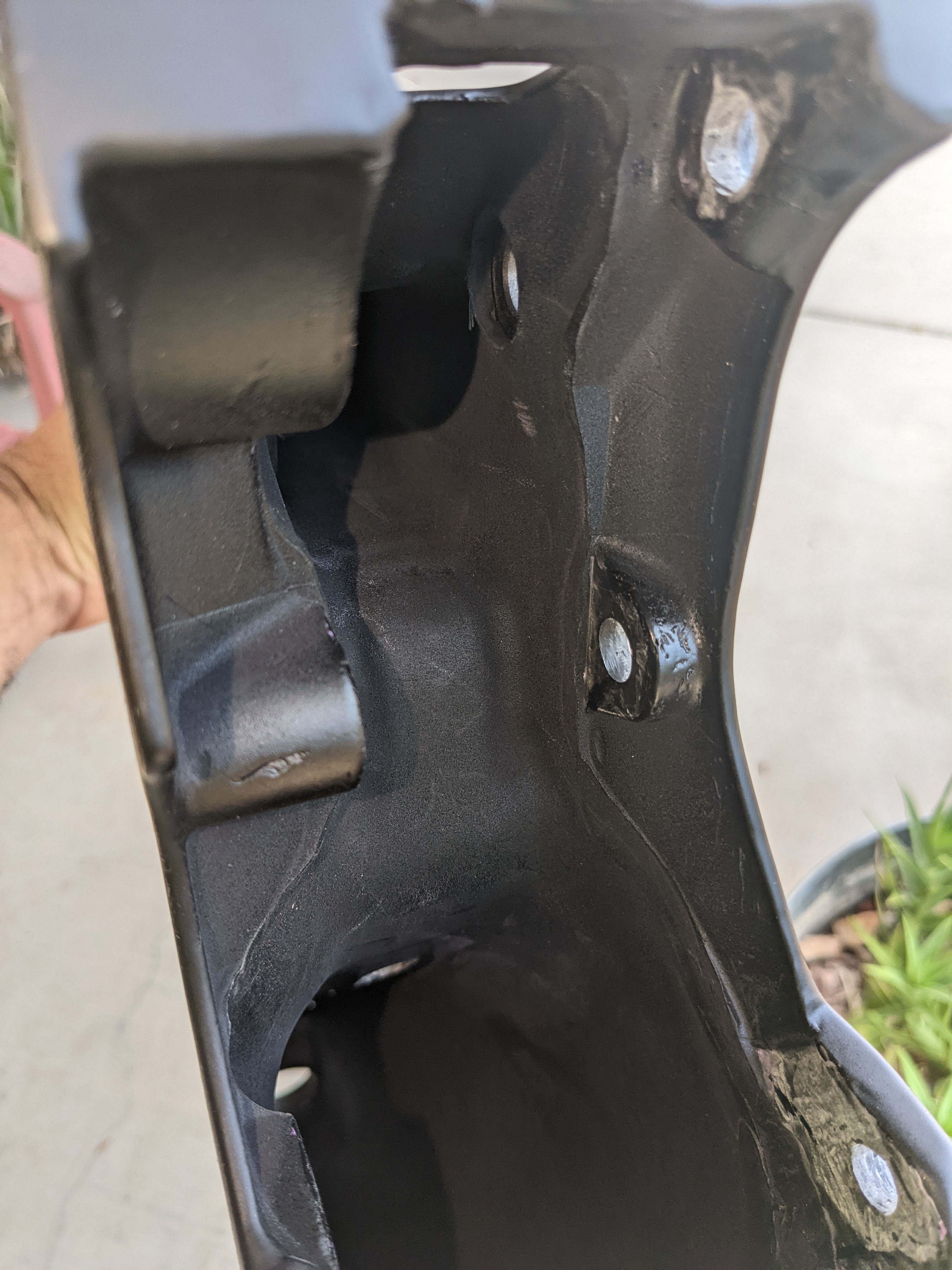

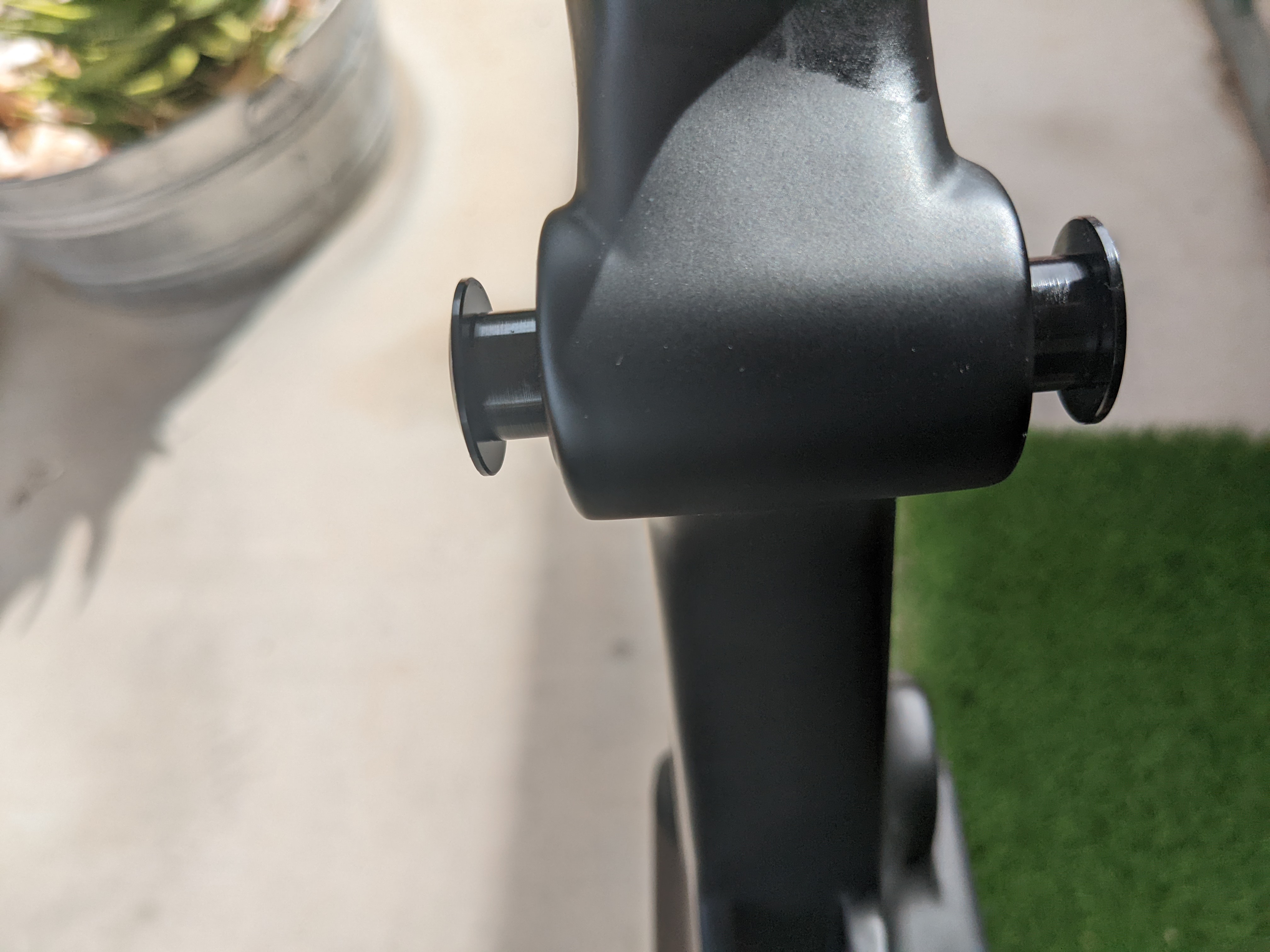

Better luck finally...warranty front triangle frame came in.🤙 This was to replace the cracked lower tube (damaged in shipping?) during the build 6 weeks ago.
The SZZS engineering team added another 3-K weave carbon layer all along the downtube and seat post (looks like glued black tarpaper a little) but feels to be integrated in well, and hoping it strengthens the area a bit more. Especially as a heavier rider.💪
But even the cracked frame seemed to do well on chunkier, rocky terrain. It's taken pebble-strikes and debris well with only small dings and scratches. I didn't put any downtube armor on it while waiting for the replacement to see how tough it is...seems tough.🛡️
Bonus, the replacement main pivot actually looks like the correct length (use a future spare).😎
The shipping box was cut up significantly and the frame had only a few superficial scratches as a result from the non "fragile" delivery process.😝 It should be easy to sand and paint as planned...so better luck!🤞

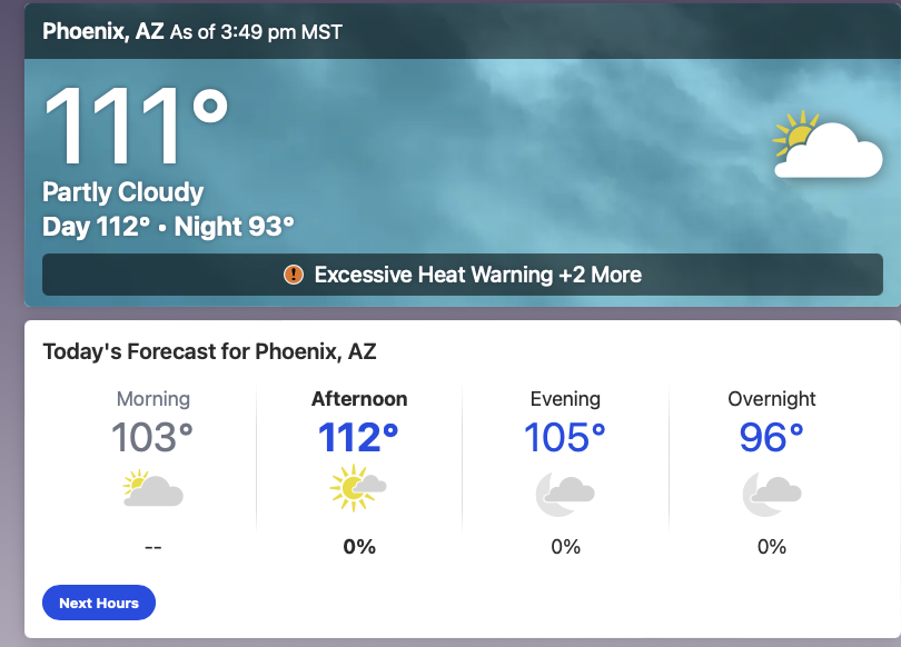

@TCFlowClyde is this how hot its been for you?
Very hot 🔥(and humidity is coming soon during our monsoon season😆)...crazy heatwave in our region.🤯
Now is the time for desert E-mtbers to camp and hit the local, cooler alpine mountain trails for a few rides in much more pleasant temps. 🏕️🚴‍♂️

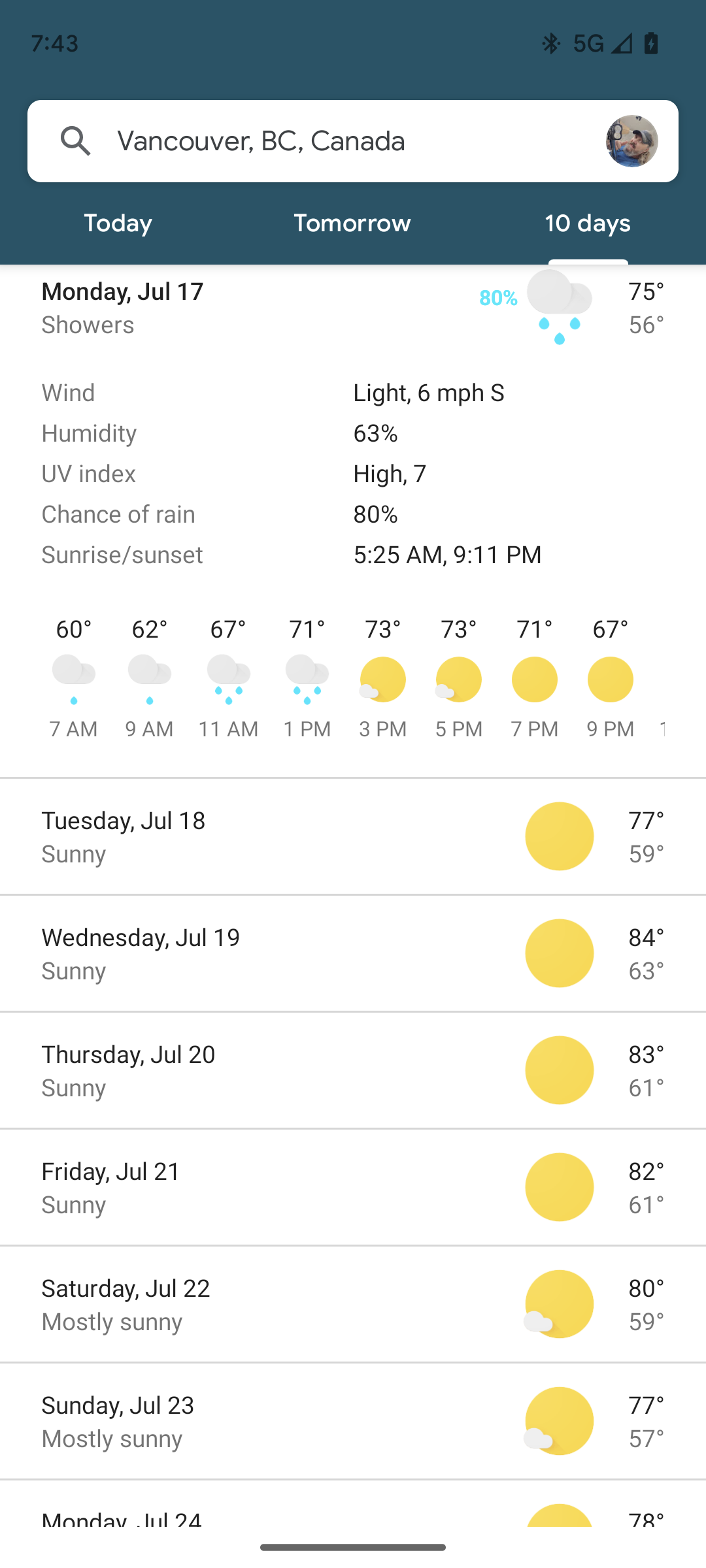

Wish we had that nice balmy BC riding weather.🤙

@TCFlowClyde mate, you've had some pretty heavy handed deliveries of late. That box is totally wrapped with packing tape, and they still managed to rip through it. How did you manage p-off all the delivery companies? :LOL::LOL::LOL:
