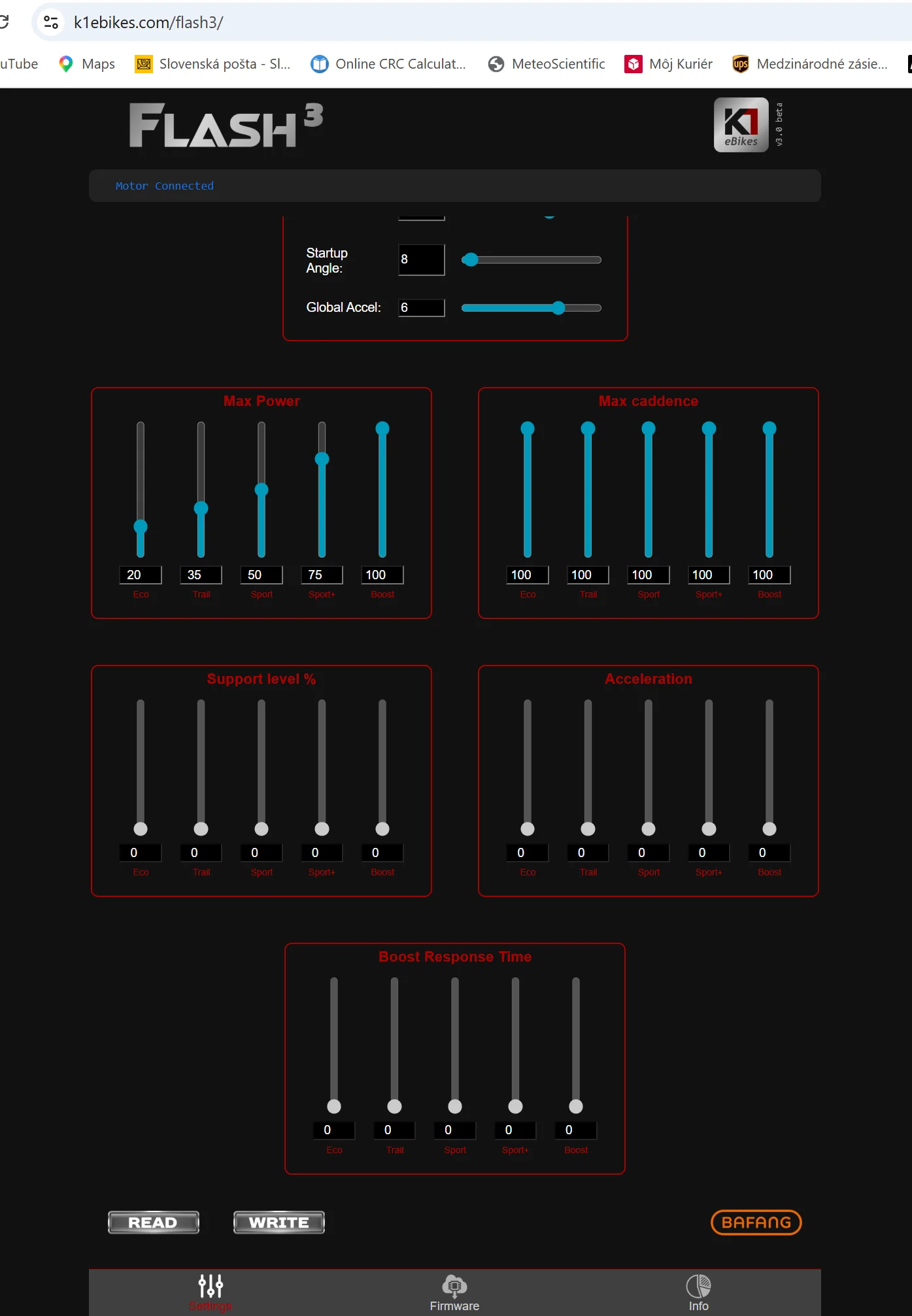

This week will be out new Flash v3 . Is running over Windows and Chrome, check beta web app at www.k1ebikes.com/flash3
Simple, no passwords, no instalations, firmwares from cloud.

So I decided to go with Flash v3 over web app and only Chrome on Windows is supported. You do not need any installation, passwords. And is fast. I like this web app solution. I can do updates very quickly (on server side). Of course you are dependant on internet, but is now all the apps. (Flash v2 is completely independant)
I guarantee I will be keeping and maintaining webserver and page at least till 2032. Still lot of work and debugging. Next, I have to add some quick guide and notes. Just dont have any skills in JS (layout was a pain - so it looks funny, but is prepared also for mobile phone) and its boring job. ;)
Later, will try to make work this web app also under Android. Just affraid a bit about compatibility, GPT told me, some manufacturers can be blocking USB port.
I have the v2 version anything new on the v3 ? an overrun adjustment would be sweet 👍
It is same functionality as v2. You know not possible to come up with something new, only what motor support.
That overrun is strange. Still lot of people reporting me M560 has overrun and to me it looks like overrun is low and fine. Had motors and firmwares with much more overrun.
There is new parameter setting, named "Boost Response time". This should be overrun I guess, but have not tried on a bike. But defined only at RS models. Is strange it is not in Besst, but in GO this setting will show up.

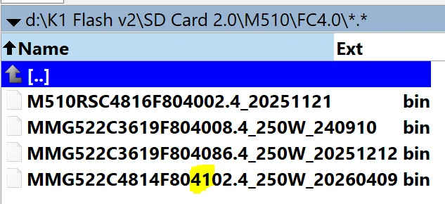

It works just fine. M510 brought a change in a throttle behaviour, is hardcoded to 32 kmh.
With FC3.0 motor and factory bafang firmware throttle does not work. (but there is some custom firmware)
For FC4.0 motors I dont know if works. Guys, who has FC4.0 motor and throttle?
And latest firmware is even labeled as 4.1
