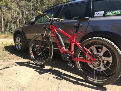

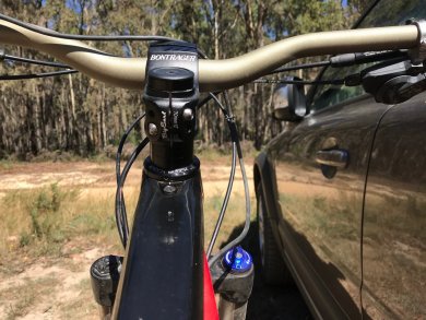

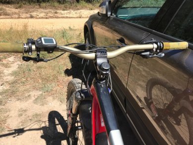

This is my set up - 70mm stem 10 deg raise . Bars are 780mm wide 35mm raise .
Makes the front end ( for me )easier to loft over logs and dips - i ride on a lot of fire roads , moto tracks and trails which are tight twisty and in some sections rough . IMG_2198.JPGIMG_2199.JPGIMG_2200.jpg

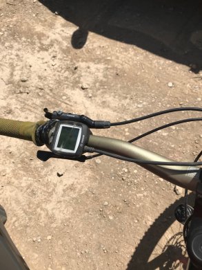

The only issue today was ........ i came off and the result was the screen is buggered .
Still works , just cannot read the info .....
