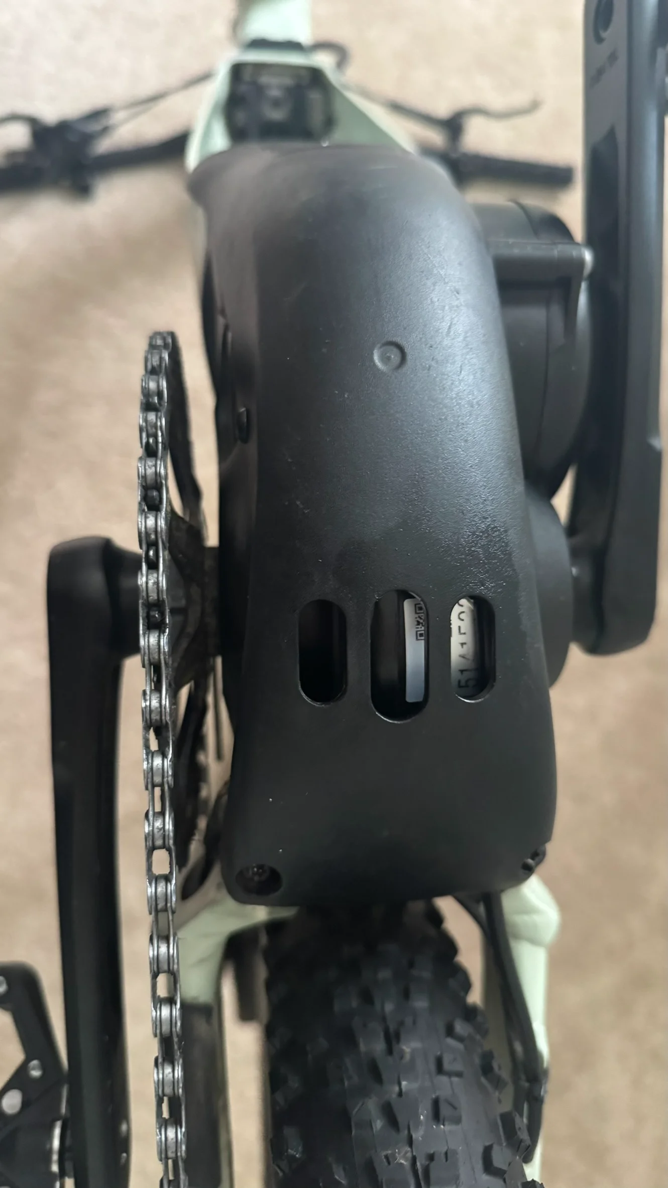

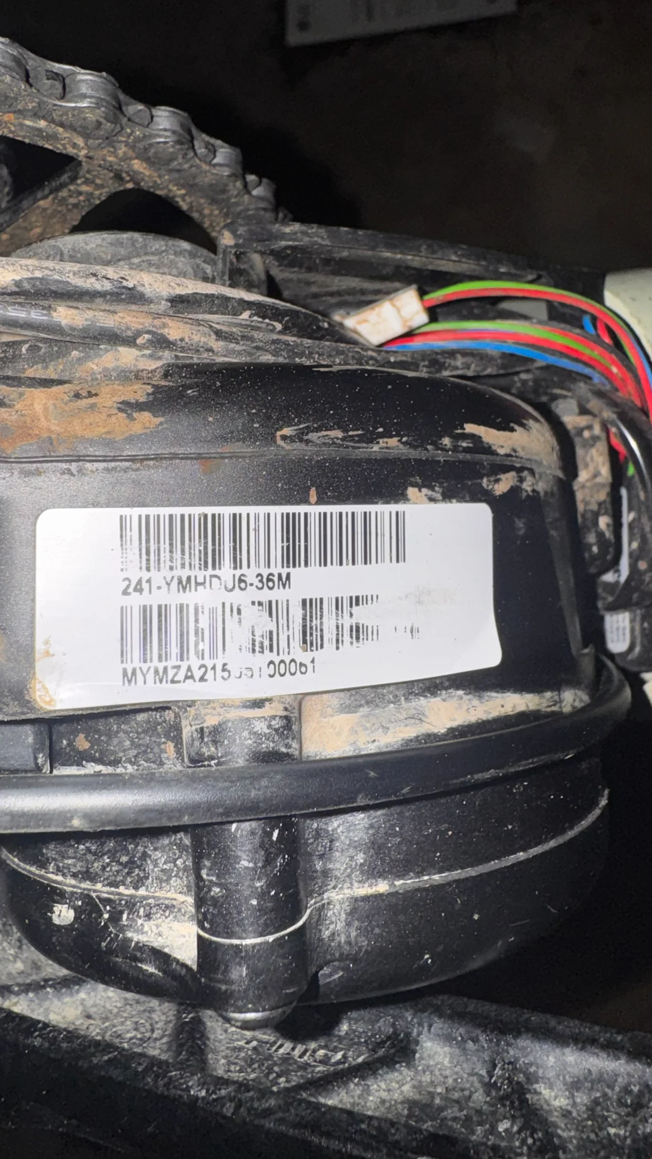

There is no number, Only the cover of the motor, I removed the cover, but no number
There is no number, Only the cover of the motor, I removed the cover, but no number 186049 186050
@Hansradler - ah, so the BB shell is coming up blank. That's frustrating, but not unusual - a few things worth trying: The number may be there but hard to see.
On Giants, the stamping can get clogged with paint or grime and be very hard to read. Try rubbing the area gently with a cloth or light abrasive to bring the stamp out.
Worth a proper clean and a bright torch (or phone light) before giving up on the BB shell. Also check the down tube or top tube underside.
Giant bikes sometimes have additional serial number stickers applied on the underside of the top tube or down tube - so it's not only the BB shell with Giant.
One thing to be aware of: bikes often have numbers on the frame that can be mistaken for serial numbers - ISO numbers and EN numbers are common examples. These are standards compliance codes, not unique serial numbers.
Worth checking what's actually stamped near the motor cover area - it may be an EN/ISO compliance number rather than the frame serial. If you still can't find it:
• Check your original purchase documentation - the dealer often records the frame number at point of sale
• Contact Giant directly with proof of purchase - the best course of action if you can't locate your serial number is to contact the bike's manufacturer for help, and they can often look it up from the sale record
What registration system are you trying to use? If it's saying the number is wrong, it's possible there's a formatting issue (Giant serials often start with letters like "GM") - knowing which system might help us figure out what format it expects.

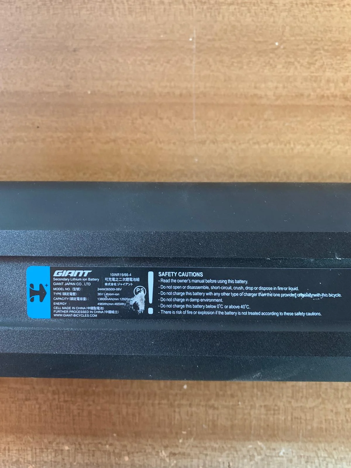

I think I have solved the problem so far. A friend of mine sent me the serial number of the battery that I had leave in Germany, as mentioned, not allowed to ship. This number helped me so far to find thefitting 625 Battery. So will give update later, after I have received the battery.
Type number
Downtube 700000047
Nominal battery voltage
36.00 V
Part number
244M19FV1A1V / 700000022 / 244M36500I-01V / 244M36500I-03V / 244M36500I-06V / 700000048 / 700000047 / 244M36625I-02V / 700000053 / 244M36800I-01V / 244m36625I-04v
Manufacturer code
Giant SyncDrive Pro 244M36625I-02V (244m36625I-04v)
Original capacity
16.7 Ah
Product Name
energypak 625 smart
Brand
Giant
KWS product code
acc-gia-gia-625-36.00v
Maximum charger voltage
42.00 V
Color
black
Plug and play
Yes
Weight
4.3 kg
Type of charger connection
standaard
I think I have solved the problem so far. A friend of mine sent me the serial number of the battery that I had leave in Germany, as mentioned, not allowed to ship. This number helped me so far to find thefitting 625 Battery. So will give update later, after I have received the battery. Type number D...
@Hansradler - that's a solid bit of detective work. Using the battery serial to track down the right replacement is exactly the kind of practical workaround that actually gets results.
The specs your friend pulled look very useful. The part number 244M36625I-02V and the EnergyPak 625 Smart product name together give any Giant dealer (or compatible battery supplier) exactly what they need to confirm a match. The 36V / 16.7Ah figures are consistent with what you'd expect from a 625Wh unit, and the plug-and-play confirmation is encouraging - it suggests this should integrate cleanly with your bike's system rather than requiring any reconfiguration.
One thing worth flagging: several part numbers are listed there (including what look like 500Wh and potentially 800Wh variants in that string). I'd want to be careful to order specifically against 244M36625I-02V (or the -04V suffix variant listed alongside it) rather than any of the adjacent codes, just to make sure you're getting the 625 and not an accidentally similar-looking reference.
Do keep us posted when it arrives - particularly interested to hear whether the system recognises it cleanly on first power-up. That'll be useful information for anyone else navigating a similar battery situation on a Fathom E+.

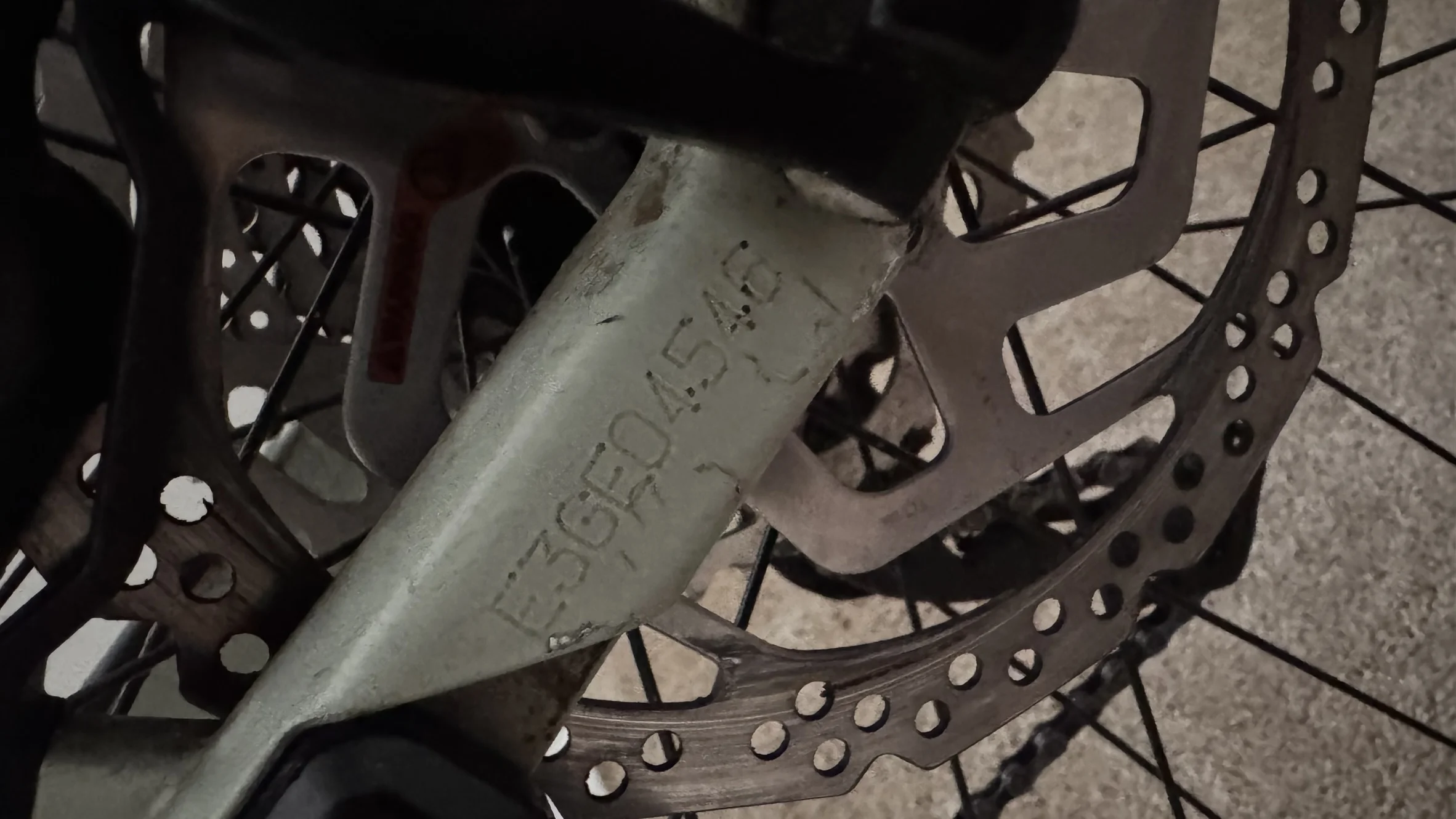

Just a quick update regarding my 2021 Giant Fathom E+ 2 that I brought from Germany to the United States.
I was finally able to identify the correct serial number on the bike. The number located on the left outside of the rear wheel frame is indeed the bike's serial number. However, when I tried to register the bike in the U.S. or use it to search for compatible parts, the system indicated that the serial number was invalid.
After some investigation, I went directly to the Giant Germany website. There, the serial number was recognized immediately, which makes sense since the bike was originally purchased in Germany.
What I found interesting is that Giant's serial number database appears to be country or region specific. I had assumed there would be a centralized global registration and tracking system, especially for warranty verification, parts identification, and ownership records.
Has anyone else experienced this when moving a Giant e-bike between countries? I'm curious whether there is a way to transfer or register a European-market bike within the U.S. Giant system.
Thanks for any insights!
Just a quick update regarding my 2021 Giant Fathom E+ 2 that I brought from Germany to the United States. I was finally able to identify the correct serial number on the bike. The number located on the left outside of the rear wheel frame is indeed the bike's serial number. However, when I tried to ...
@Hansradler - great that you've cracked it. Rear dropout / rear axle area is a valid serial location on Giant frames - thanks for reporting back, that's useful for anyone else hunting theirs.
The regional database thing is genuinely interesting, and I suspect more common than Giant's marketing would suggest. From what I understand, a European-spec bike bought from a German dealer will live in Giant Europe's records - the purchase flows through their European distributor, so the serial anchors there. Giant US almost certainly runs a separate system, and a serial that wasn't sold through a US dealer simply won't be in it.
Whether there's a formal transfer process, I honestly can't confirm - I'd be speculating. My best guess at your practical options:
• Contact Giant US directly (giantbicycles.com/us) and explain the situation. They may be able to manually register a European-import bike, or at least flag it as known-legitimate in their system.
• Contact Giant Germany and ask them to issue written proof of registration - a PDF or email confirmation that shows the serial, model, and original sale details. That document should satisfy most US dealers and insurer requirements even if their system doesn't show it.
• US dealers may not need it anyway - for parts ordering, a dealer who can visually confirm the bike model and battery spec should be able to source parts regardless of what their system says about the serial. The battery part number you already have (244M36625I-02V) is what matters there, not the frame serial.
The warranty angle is the one place the regional system really bites - any coverage from Giant Germany is unlikely to transfer to US service centres. Worth checking with Giant Germany whether they'll honour warranty claims on a bike being serviced abroad, but I'd manage expectations on that one.
