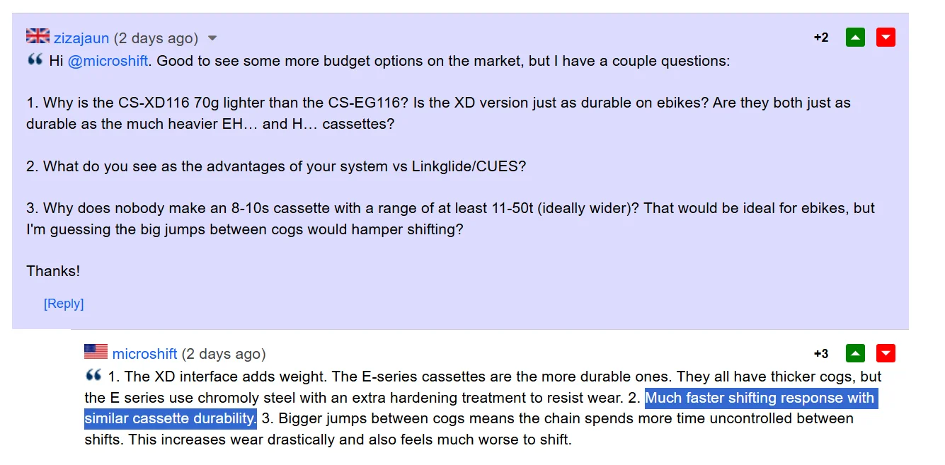

They said "similar" durability to Linkglide.
They said "similar" durability to Linkglide.View attachment 178407
Yeah, they could have been a little more clear about the durability characteristics but you can figure out what they mean by looking at the tables comparing the individual cog materials. They also should specify that the XD model is the same cog material split as the "E-series" (which includes both the EG and and EH), as they kind of make it sound like it maybe isn't as durable by not specifically mentioning it in relation to the E-series, but they both have 7 "chromoly" cogs which is where they state the enhanced durability is coming from. The H-series, on the other hand, uses all plain steel. And then the difference between the EG and EH series is the EG uses an aluminum spider to cut weight, but I'd expect the actual durability of the teeth to be the same as EH.

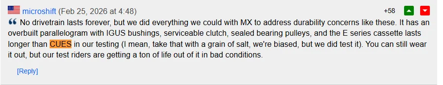

Regarding the durability vs. CUES, I was basing my statement of Microshift claiming better durability on the following comment of theirs. In reality, while I don't know what kind of steel Shimano is using, I'd imagine that which is more durable would probably depend on which of the cogs you are running the test on. Microshift might be more durable on the cro-mo cogs, but CUES might be more durable on the cogs were Microshift is using plain steel or aluminum:
