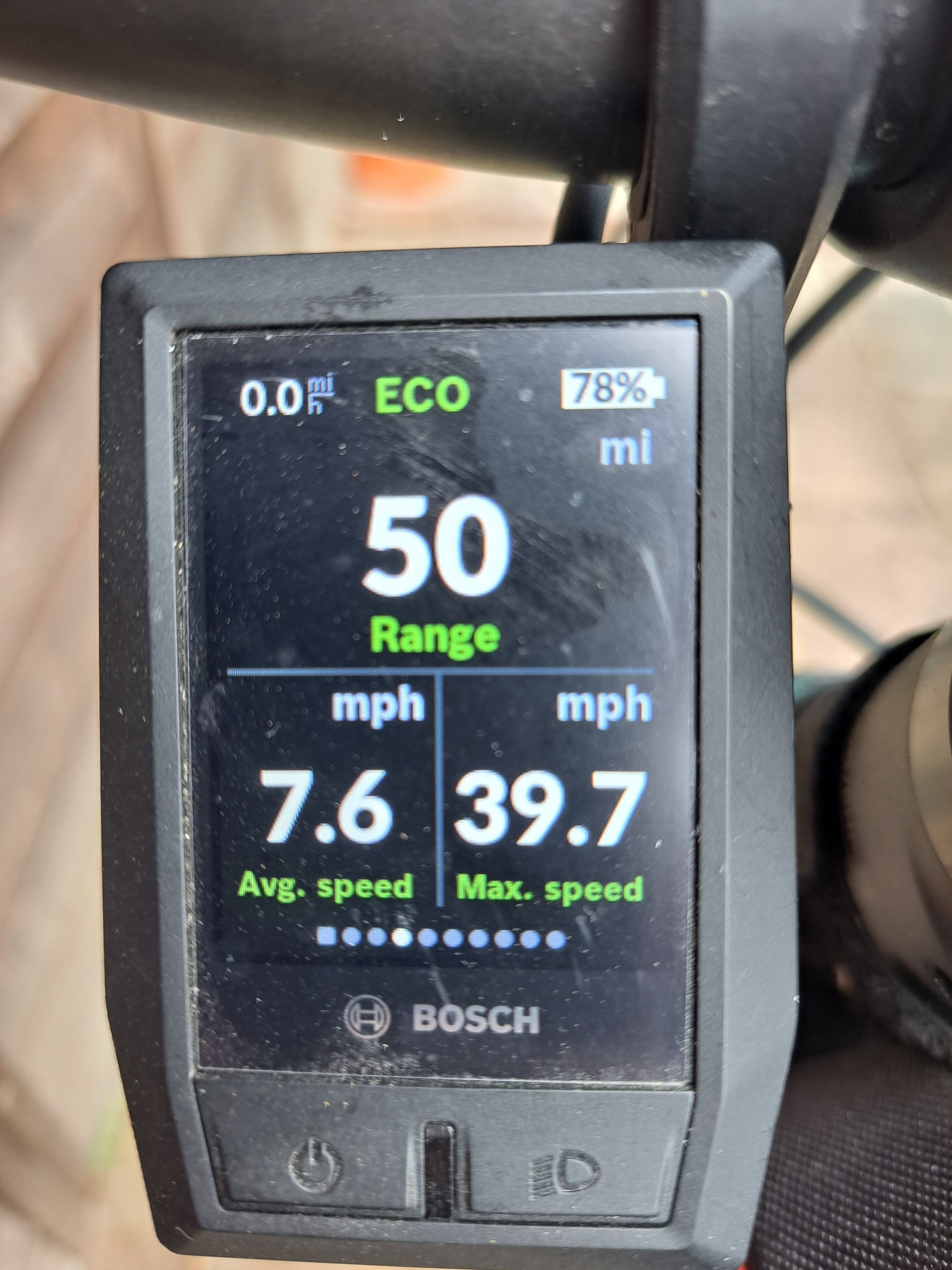

Turned the motor off on a really steep rough trail and got this (Trek Rail). So much vibration that started seeing double tbh 😆
Don't understand why folk bother turning the motor off to freewheel downhill.....it merely stops any assist which you would not be calling for anyway so there is no battery saving by doing so.
