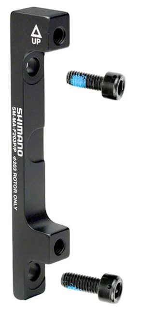

Swapping the front and rear brakes from SRAM to Shimano XT was a massive upgrade. You would need to get the following:
- two new shimano olive and barb insert kits.
- Shimano brakes of your choice.
- Shimano mineral Oil and Bleed kit.
- New 6 bolt rotors of your choice (203mm front and 180mm rear ice tech is what I used).
- Caliper adapter for front 203mm shimano rotor. Make sure you get the one in the photo.

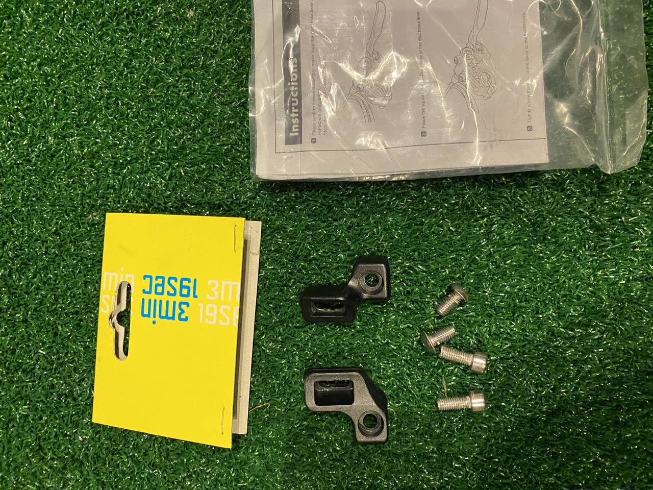

What did you do with the dropper post lever? Since it uses the matchmaker attached to the SRAM brake lever assembly?
I installed the Sram AXS reverb post so the controller came with a clamp. I used XT brakes so they have their own clamp and are positioned inboard of the reverb controller. I can attach a photo tomorrow.
yea my expert came with a xfusion dropper with no clamp. It’s hooked to my sram brakes by a matchmaker. Looking at matchmaker they don’t make anything for the new Shimano XT or XTR brakes
Just got my MT7s in the mail today as well! Quick question - any trouble with the internal routing? Anything to note that helped you during install?
The internal cable routing ‘should’ be as simple as just pushing the new hose in - and it pops out where it should. There is a sleeve / conduit that runs inside the frame - so when you push a hose it, it follows this path.
Mine was a nightmare and got stuck - so I’d go with the barb suggestion above just in case. It could save you hours of heartache!!
I ordered Magua’s own Matchmaker kit, which works perfectly with my AXS shifter / dropper lever.
I don’t think the post mount adapter is the correct one for Magura? You need one that is bigger at the top than the bottom - and that the bolts from the piston go straight through into the fork. Maybe it’s different as I have a Rockshox fork?

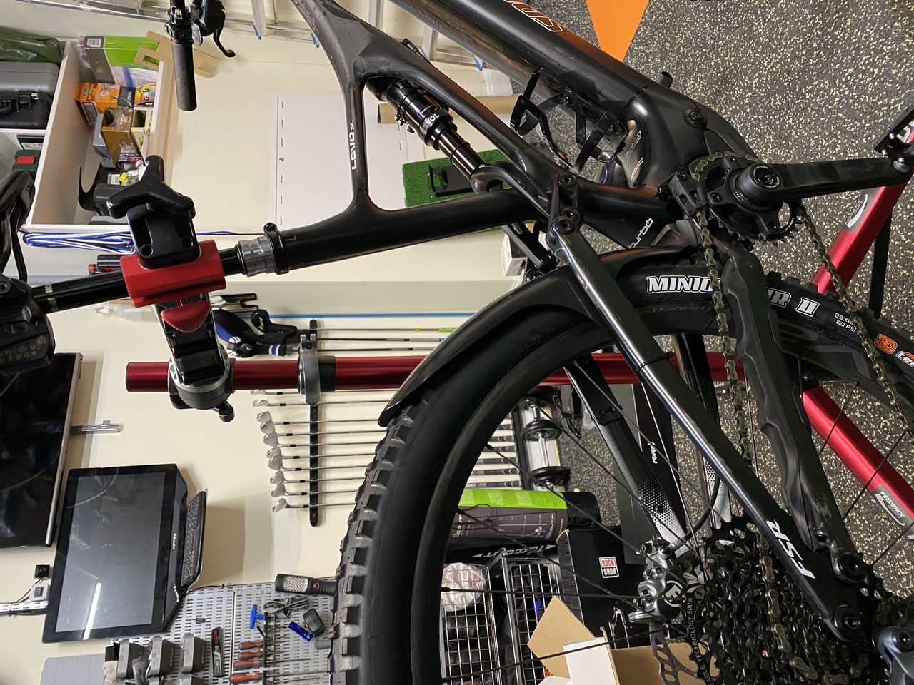

Too miserable outside to ride today...
Today I changed my tubeless valves to Muc Off 44mm ones as my front Roval one leaked like a sieve!
I then shortened my brake hoses a bit - as it was much cleaner looking with the wireless dropper fitted. I also got some ‘plugs’ sent to my LBS from Specialized to fill the blanks where I removed the shifter / dropper cables. I have 1 more for the TCU control when I remove that too.

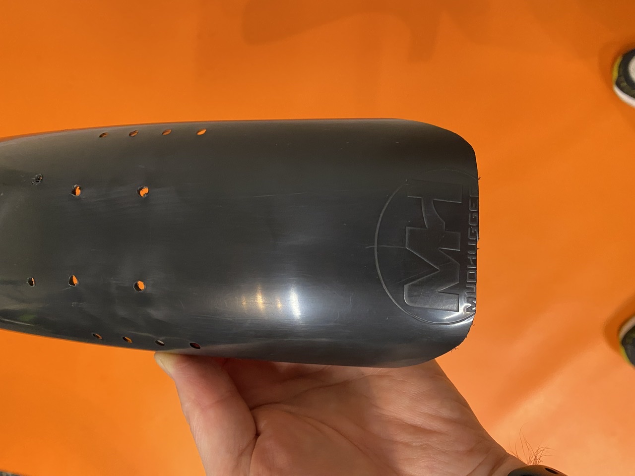

I decided to experiment with my Mud Hugger front guard, and chopped a few inches off the end - then drilled a couple more holes in it.
I then applied a couple of extra layers of Invisiframe to the seat stay, and fitted the guard. Hopefully it’s supposed to be dry in the morning, so I’ll get a chance to test it.
Another +75g added, but in North East Scotland at the moment, you NEED mudguards of some description!

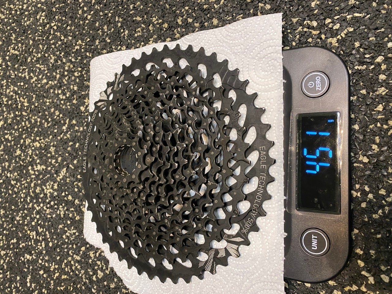

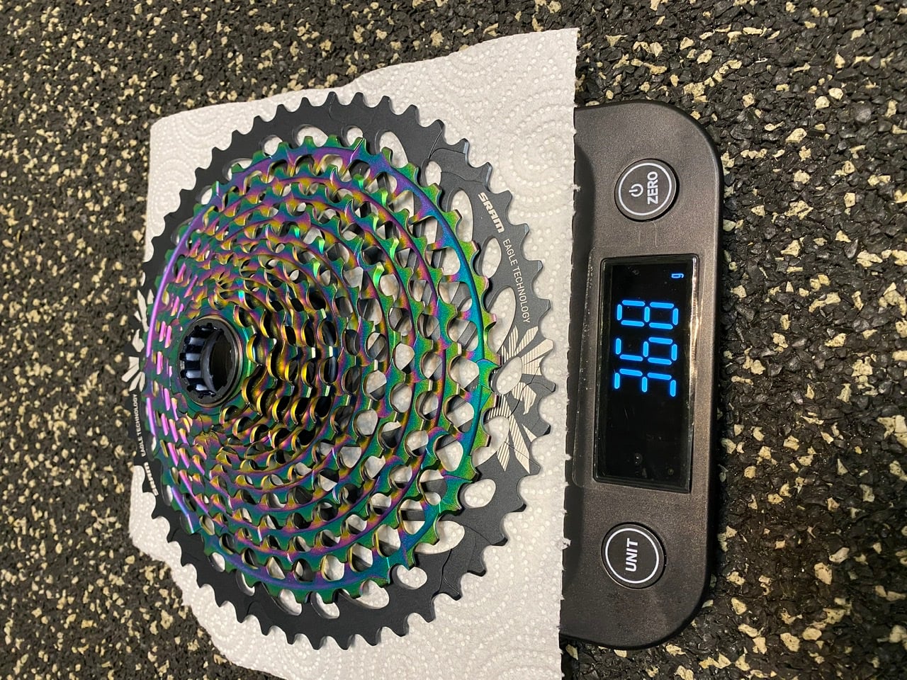

One of this weeks parcels arrived today...
An XX1 ‘rainbow’ cassette and chain - and removal tools.
SRAM Eagle GX Cassette - 451g
SRAM Eagle XX1 Cassette - 368g
That’s another 83g removed... and I think the XX1 chain is a whopping 5g lighter than the GX one!

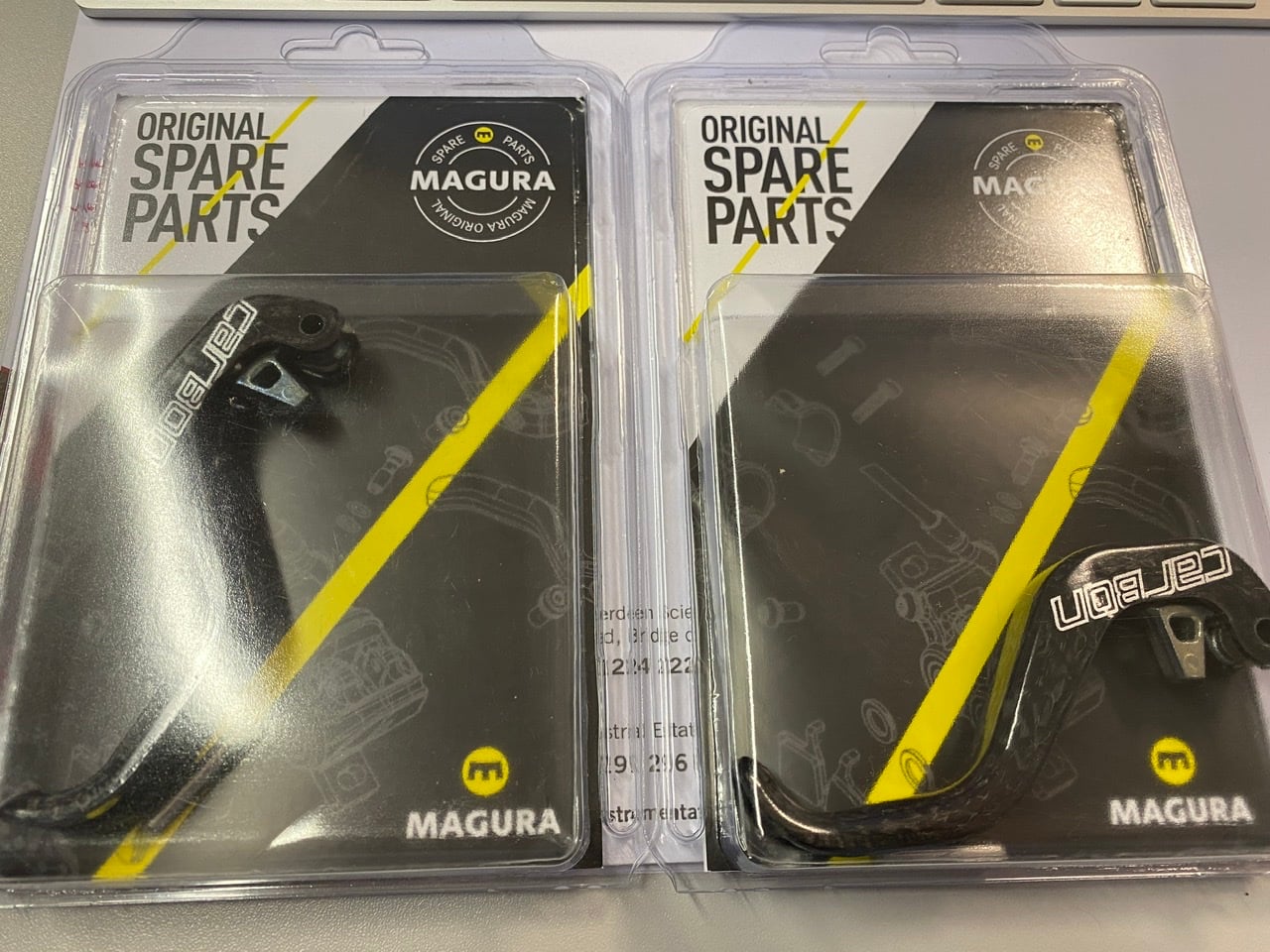

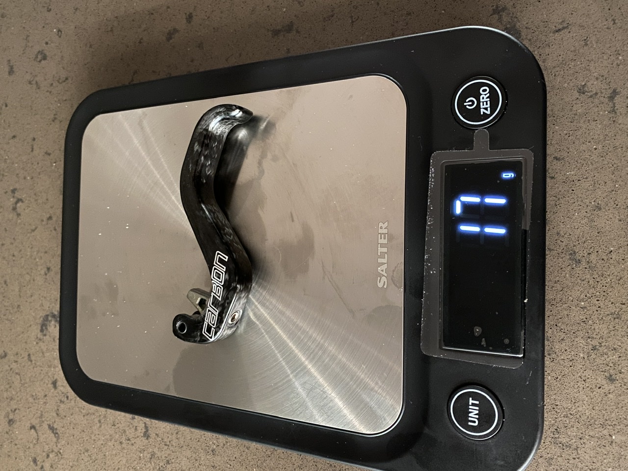

Another parcel yesterday...

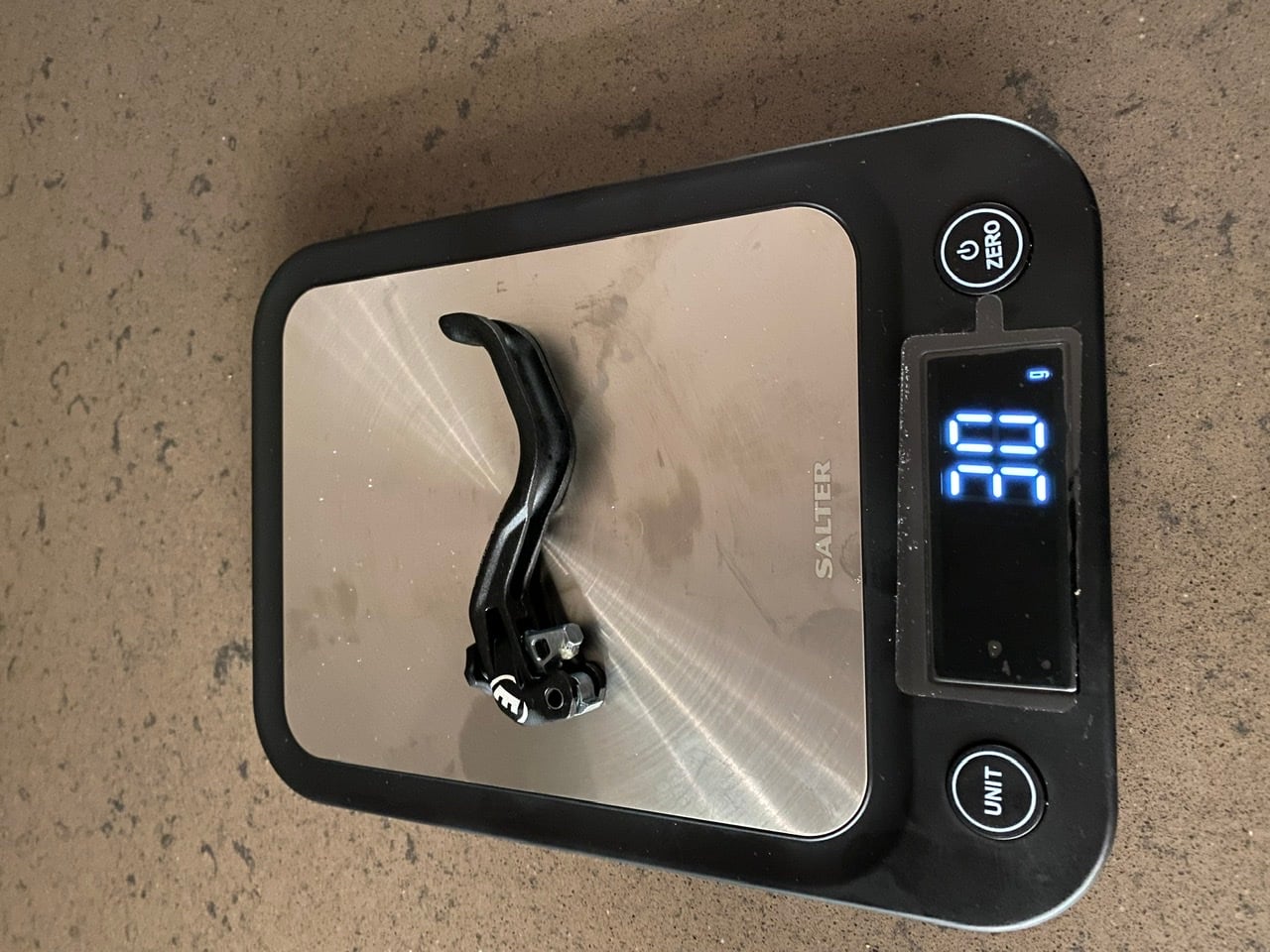

Magura carbon levers. Not really bought as a weight saver, but will shave a few grams off. I suffer from Raynaud’s syndrome, which means I always have cold hands, and especially finger tips. Carbon levers don’t feel nearly as cold to touch on cold days as alloy - hence the swap. I swapped to carbon levers on my last bike, and they genuinely make a big difference when it’s freezing outside.
Magura Alloy Lever - 30g
Magura Carbon lever: 17g
26g saving for the pair. Definitely not worth £129 for the weight saving - but worth it for my fingers!
Magura carbon levers. Not really bought as a weight saver, but will shave a few grams off. I suffer from Raynaud’s syndrome, which means I always have cold hands, and especially finger tips. Carbon levers don’t feel nearly as cold to touch on cold days as alloy - hence the swap. I swapped to carbon levers on my last bike, and they genuinely male a big difference when it’s freezing outside.

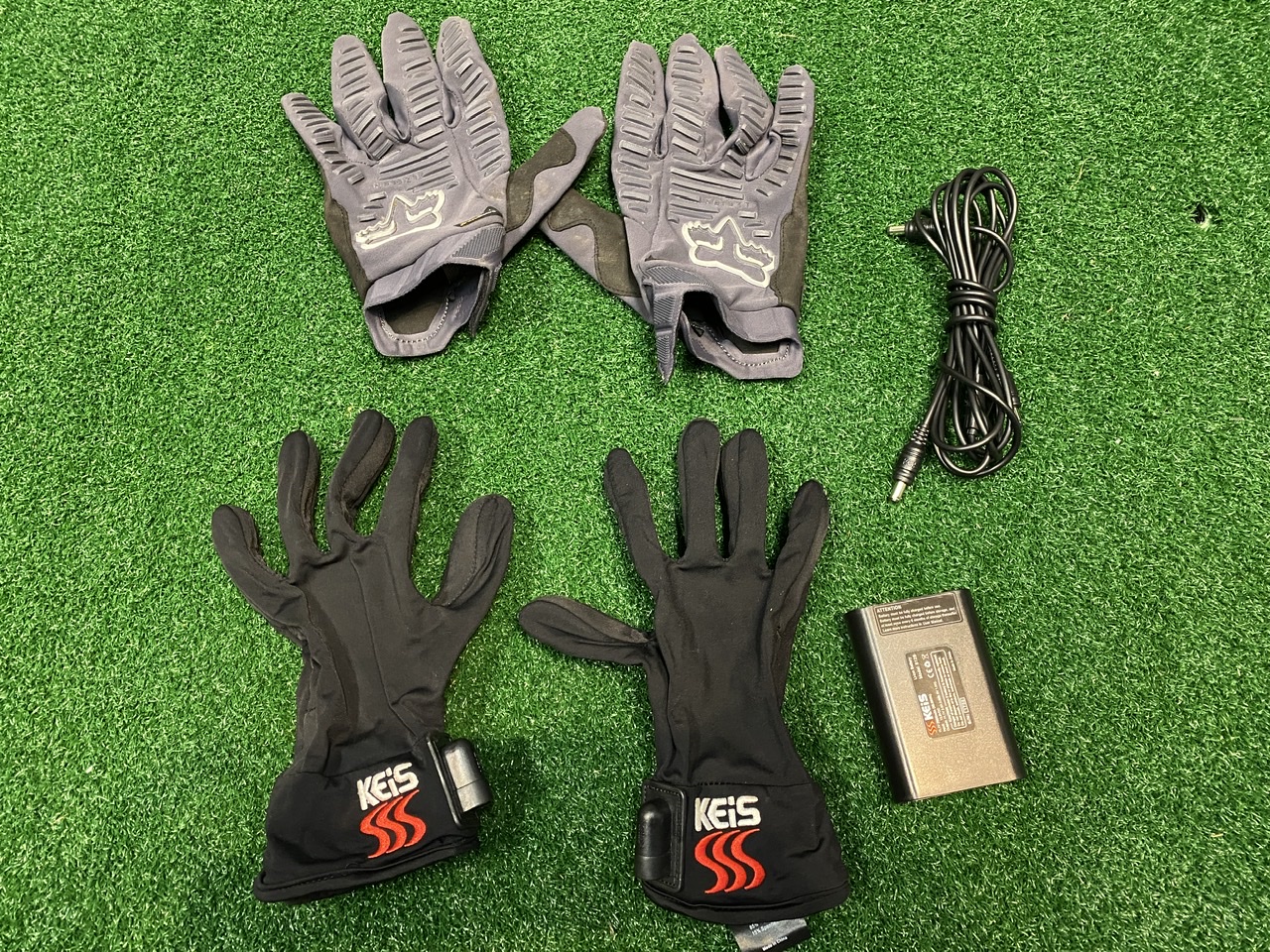

I get the same sort of problem with my hands and fingers.
I started using these (recommended by @Mikerb ) and found a dramatic improvement.
I use these...
They’re Keis heated lining gloves. I think they’re meant for motorcycle use - to wear under giant gauntlet type gloves.
I bought them in a Medium (which is snug) and then bought the same Fox gloves as I wear in an XL to go over the Keis ones.
The battery goes in my chest pocket, and I run a wire down each sleeve. It’s a bit of a PITA to get set up, but once your plugged in, they stay warm for a couple of hours. I also have a controller somewhere that you can choose the heat setting - which makes them last longer on lower heats. Without it, they’re full blast all the time.
I’d rather just have a single pair of thin Fox gloves on for the feel... but in cold temperatures this can be extremely painful. The Keis gloves work really well. They just take a few extra minutes to run the cables - but I do this in the house before I go.

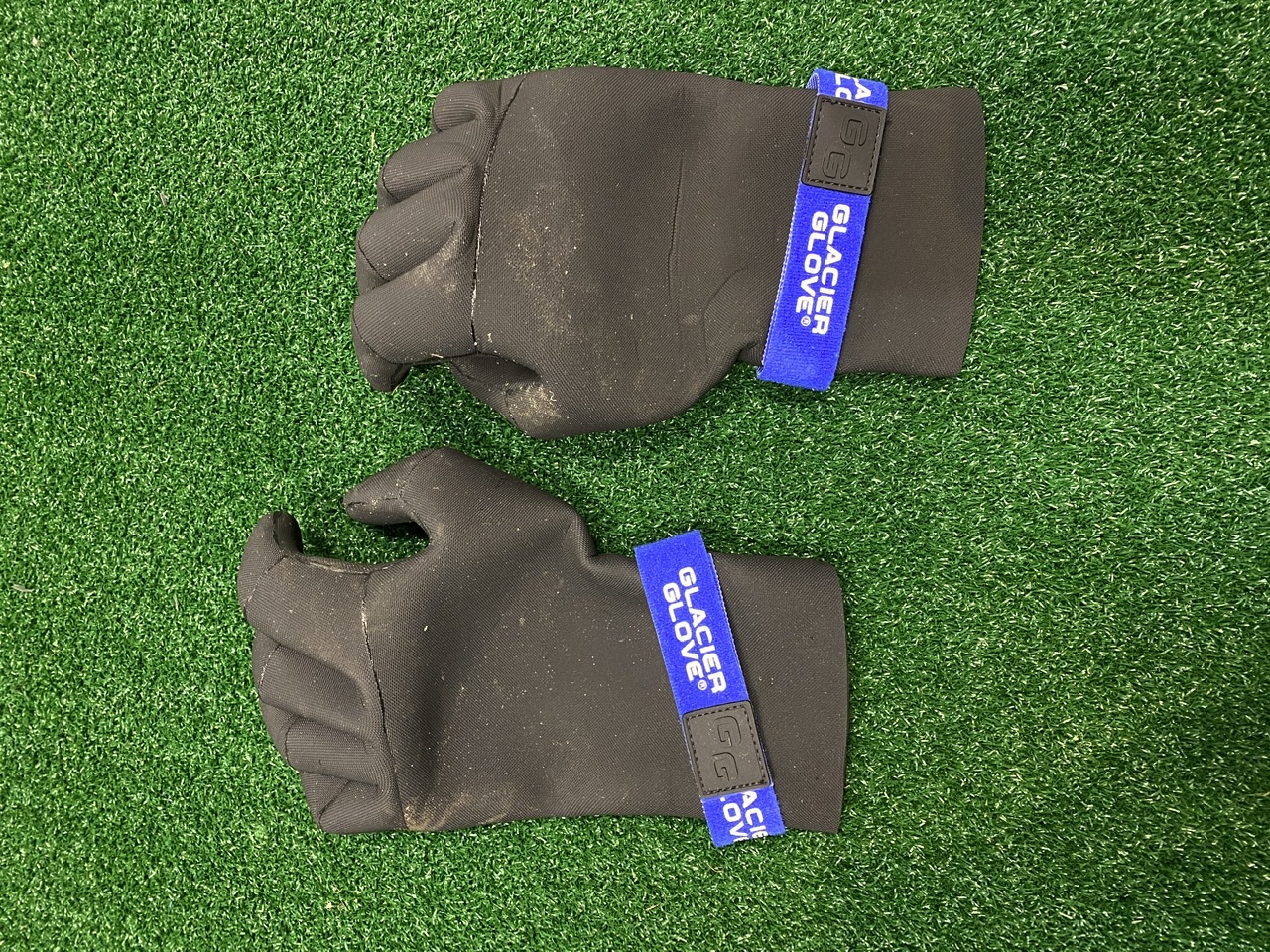

When I get home, I use Glacier Gloves for washing the bike as they’re fully waterproof and insulated. I also use them for cleaning the car too. Can easily put your hand in a bucket of water for extended periods of time and they don’t leak. My first pair lasted about 2 1/2 years till they started leaking a bit. These ones are only a couple of months old.
There is a matchmaker for these.
I have a set of them in a drawer that I bought for the Trek Rail - and then returned the bike.
Had to order from Germany, but came in a couple of days.

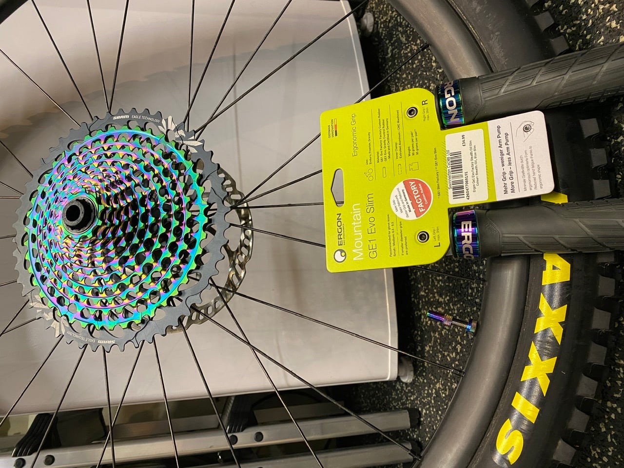

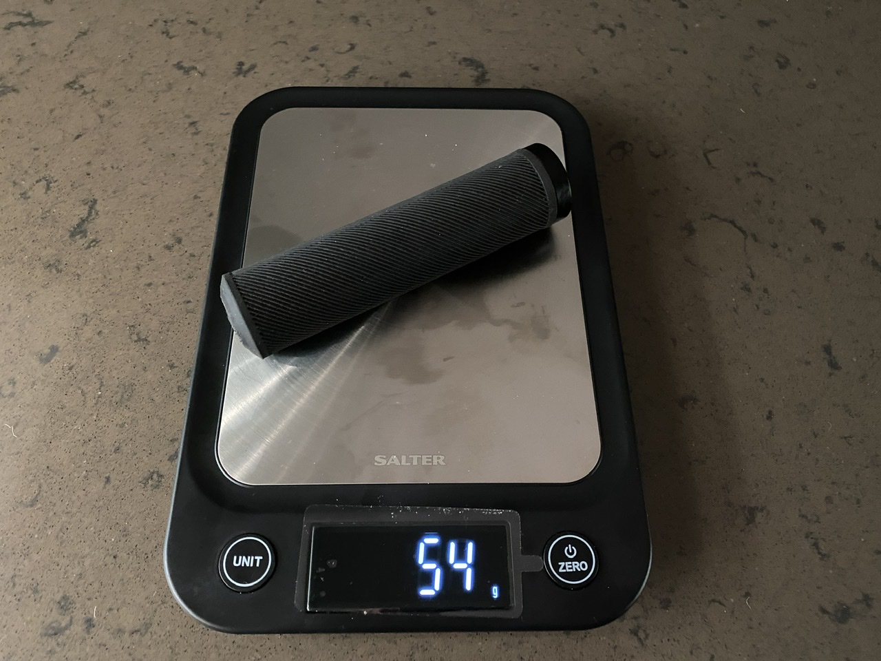

A couple more things arrived today, and I’ve fitted / weighed another that I’d never got round to!
Following the iridescent theme of my cassette / chain and valves - I got some Ergon GE1 grips to replace the standard Specialized ones.
Specialized grips = 54g each
Ergon GE1 grips = 50g each
Woohoo = 8g saved... but much nicer looking and very grippy!

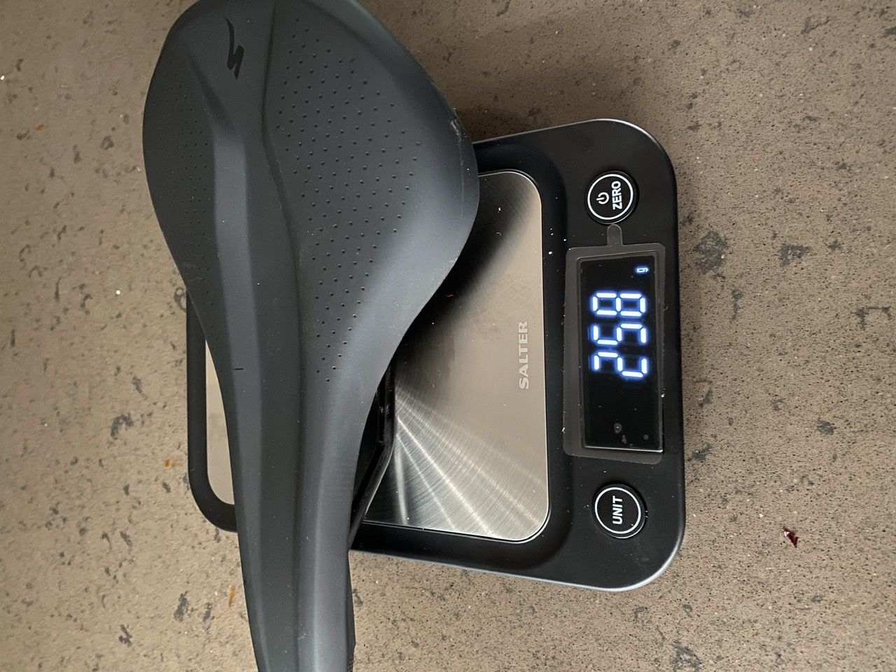

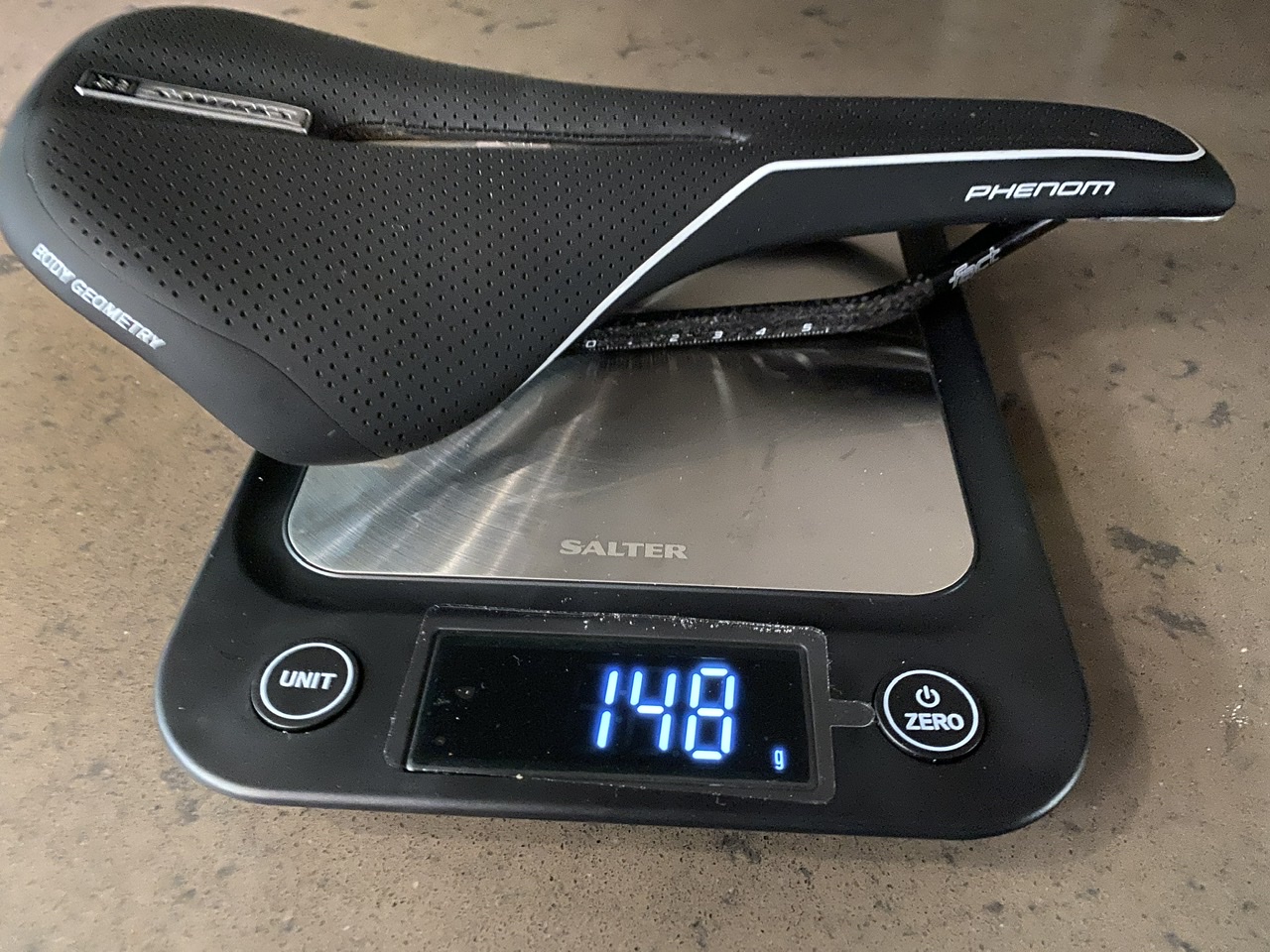

Specialized Bridge Comp Saddle = 258g
Specialized Phenom S-Works Saddle = 148g
110g saving there. I have a Phenom Expert on my Stumpy which I love. Hopefully the S-Works is the same comfort, but with carbon rails!

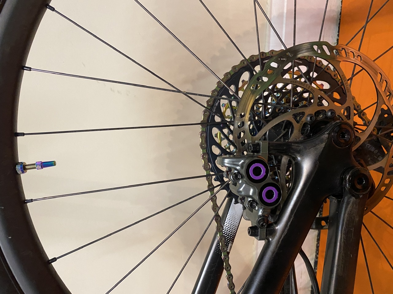

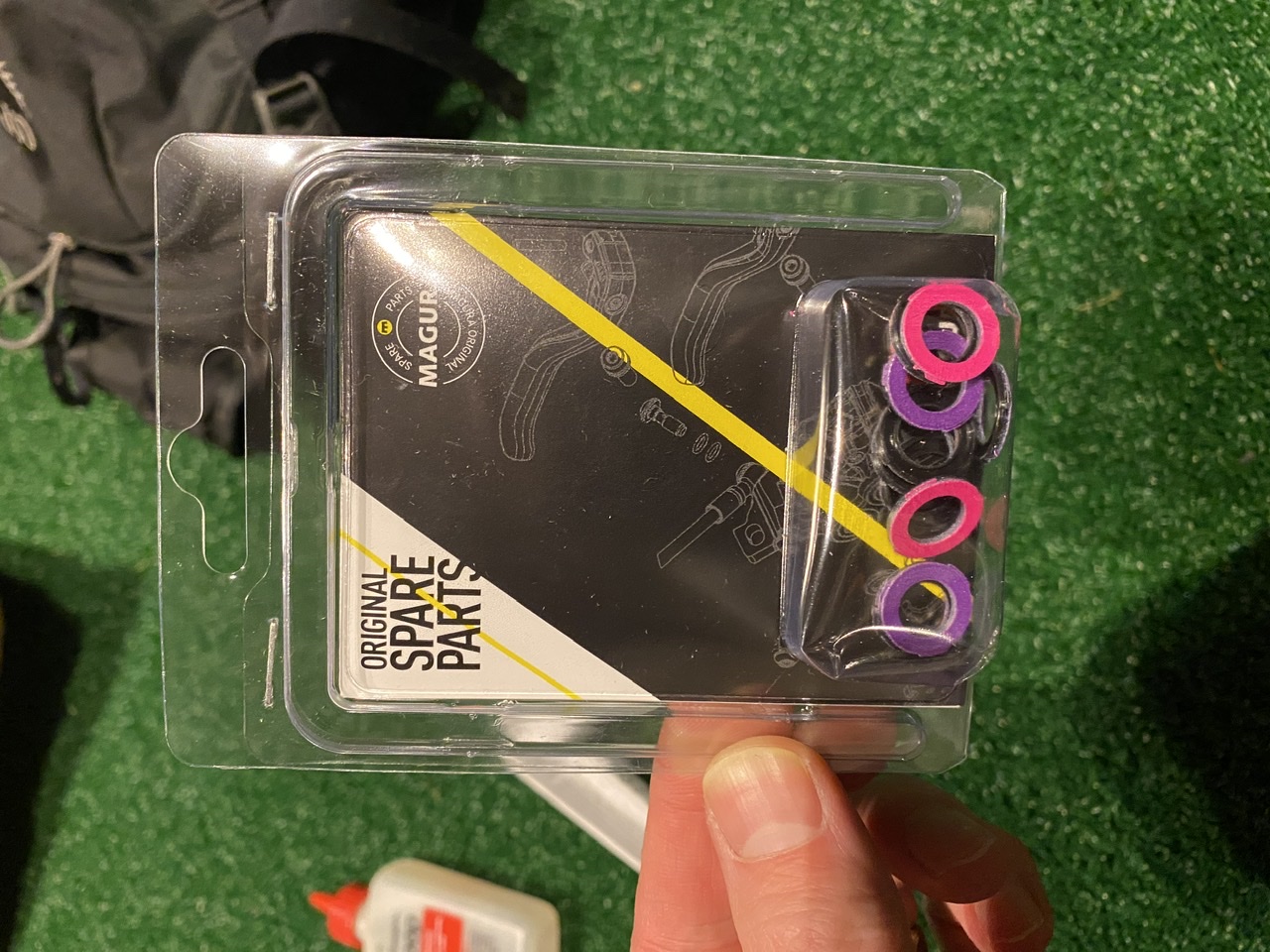

Changed the Magura MT7 luminous yellow circles on the callipers to purple ones to be more fitting with my iridescent bits! Now need to see if I can find the purple MT7 logos for the levers that are pictured on their website.

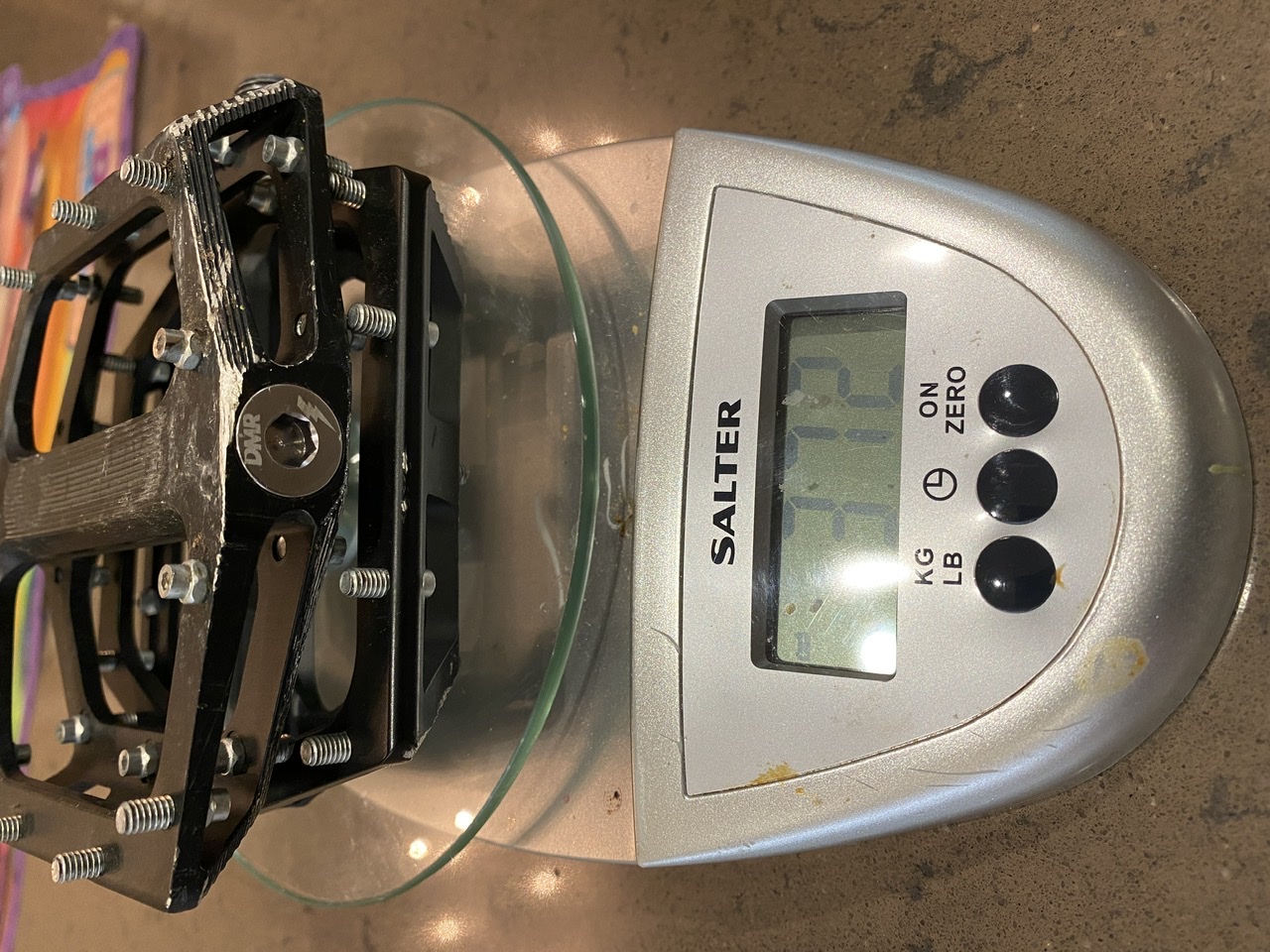

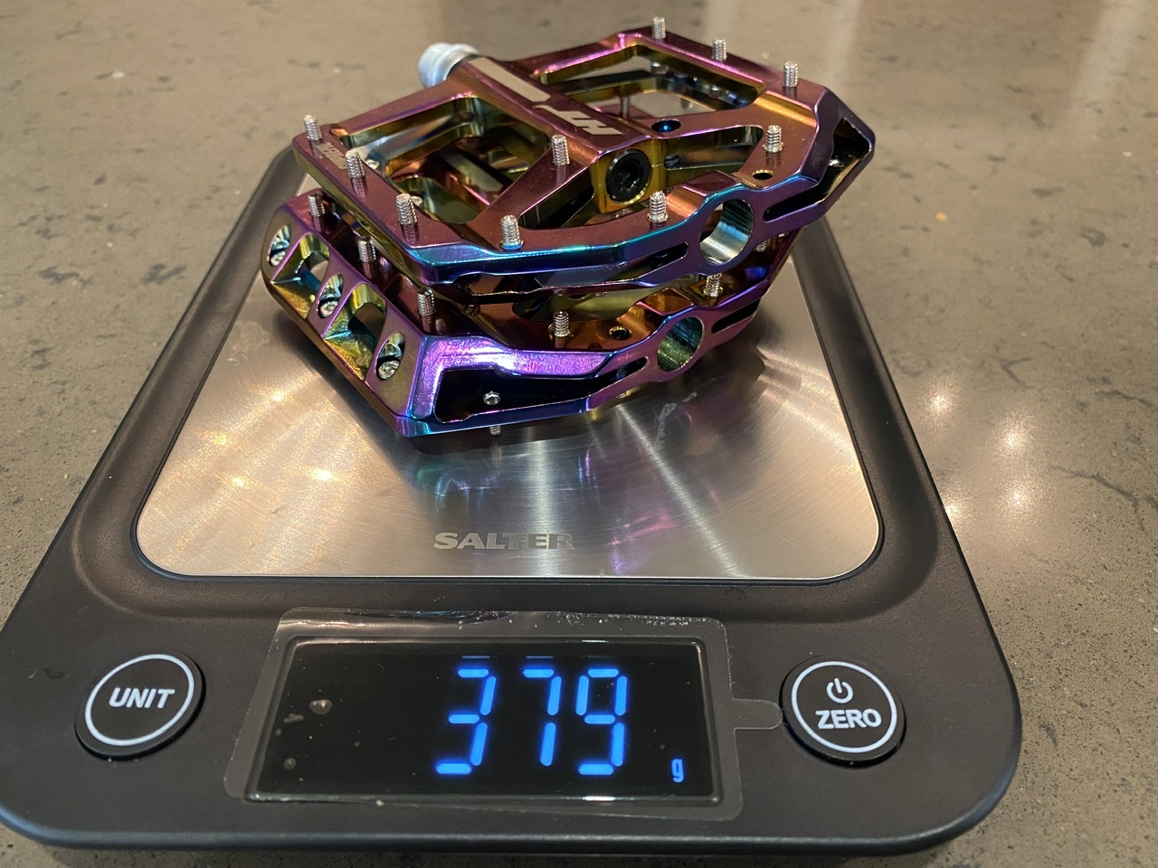

Following the iridescent theme, I bought some new pedals. HT Components ANS-10 Supreme pedals. A few extra g’s above my previous DMR Vault Magnesium pedals, but these look awesome!
DMR Vault Mg = 372g (pair)
HT ANS-10 Supreme = 379g (pair)
+7g - so very little in it!
