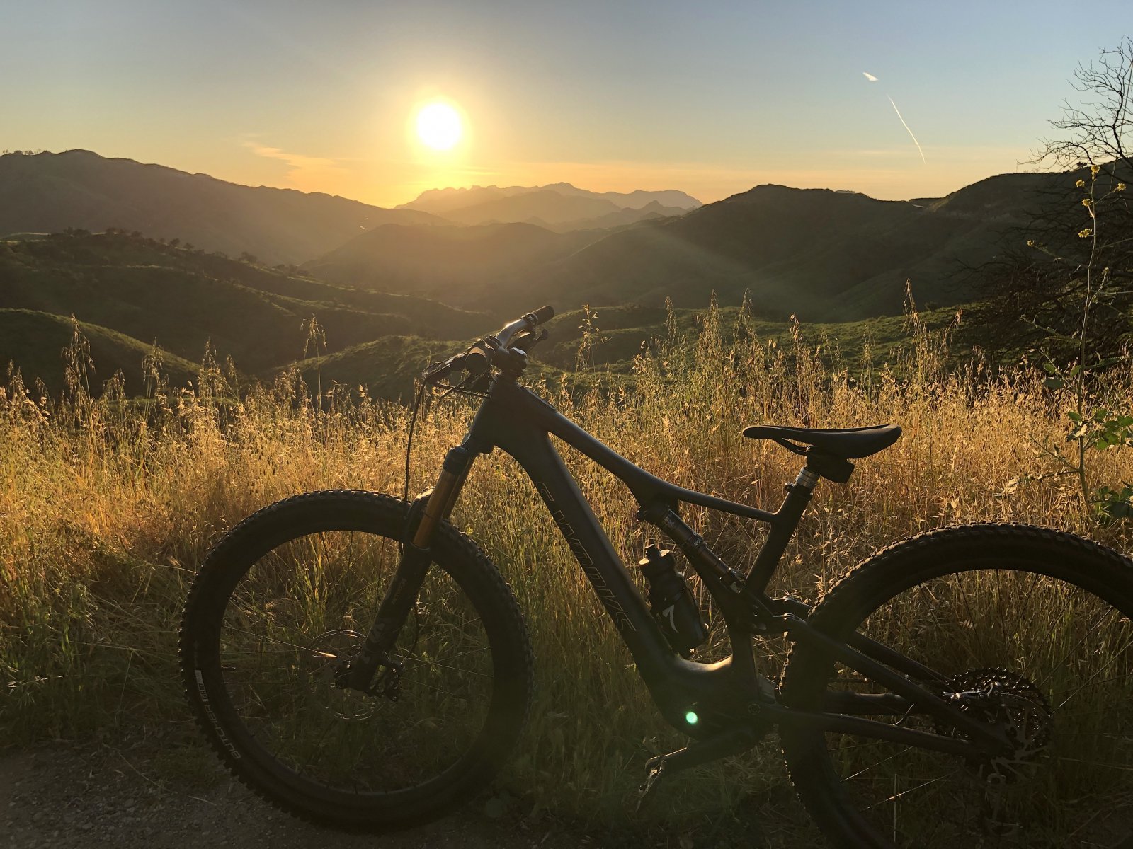

I bet! Hope you don't have an S-WORKS - as amazing as they may be!
Have you got an sworks? Have you got a picture, I love them!

Rockhopper, HT Levo, FSR Levo, $11,000,nearly an S-WORKS sitting there!
A little silhouette but it's in its natural habitat.
