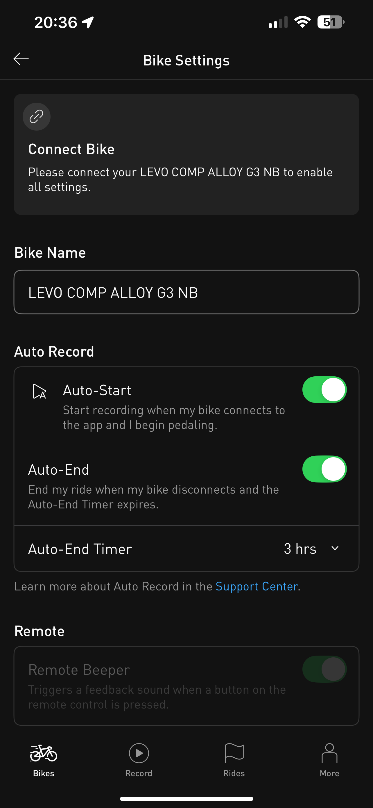

Update on the app has added an auto start function on the app
