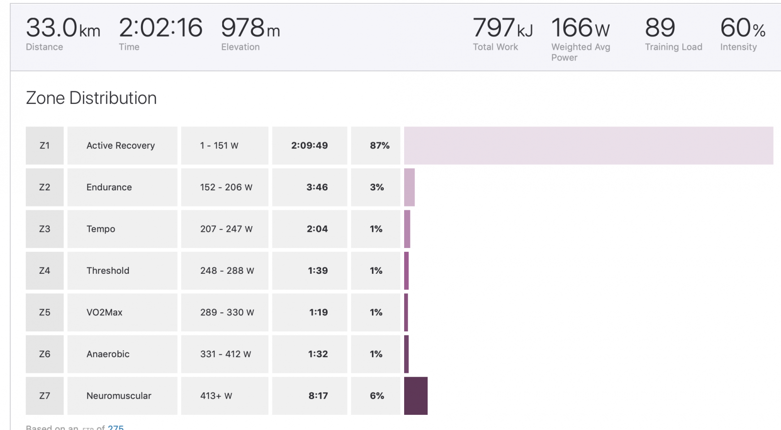

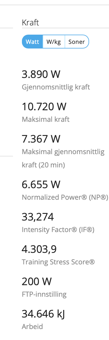

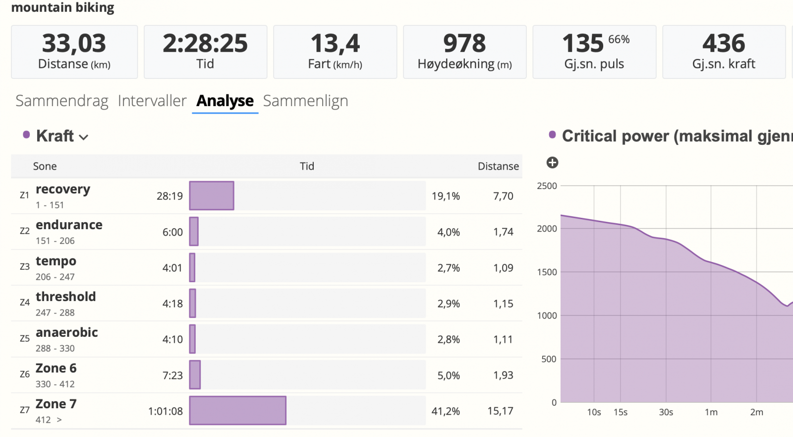

Here's some interesting pics. 1 ride - 3 services - 3 totall different results...
Strava
Sporttracks:
Garmin Connect:

I have currently worse problems with power peeks over 50000 ! Watts. Which screw up all stats. Average 673 Watts throughout 2 hours ride instead of apr. 170, FTP 7,2 W/kg? This happens with my Fenix 5xplus since the last Firmware update. My edge 520 works perfect recording in parallel.

BTW, it seems like strava uses itˋs own filter on the imported data which deletes incorrect data.
Yep, the strava files seems about normal to me. At least they make sense compared to my ftp and perceived effort on the specific ride.

Hi, @hbakken that power reading is really strange. It is commonly known that Levos create occasional non-sense peaks in power ANT+ reading, but these are really short and don't mess up the whole data, because average, FTP, etc. are still allright. But you have obviously whole data in mess. That is strange and it is question whether the problem is on bike side or Garmin device. How is your power reading if you record them by MC? Did you try to run calibration of power sensor in Garmin?
