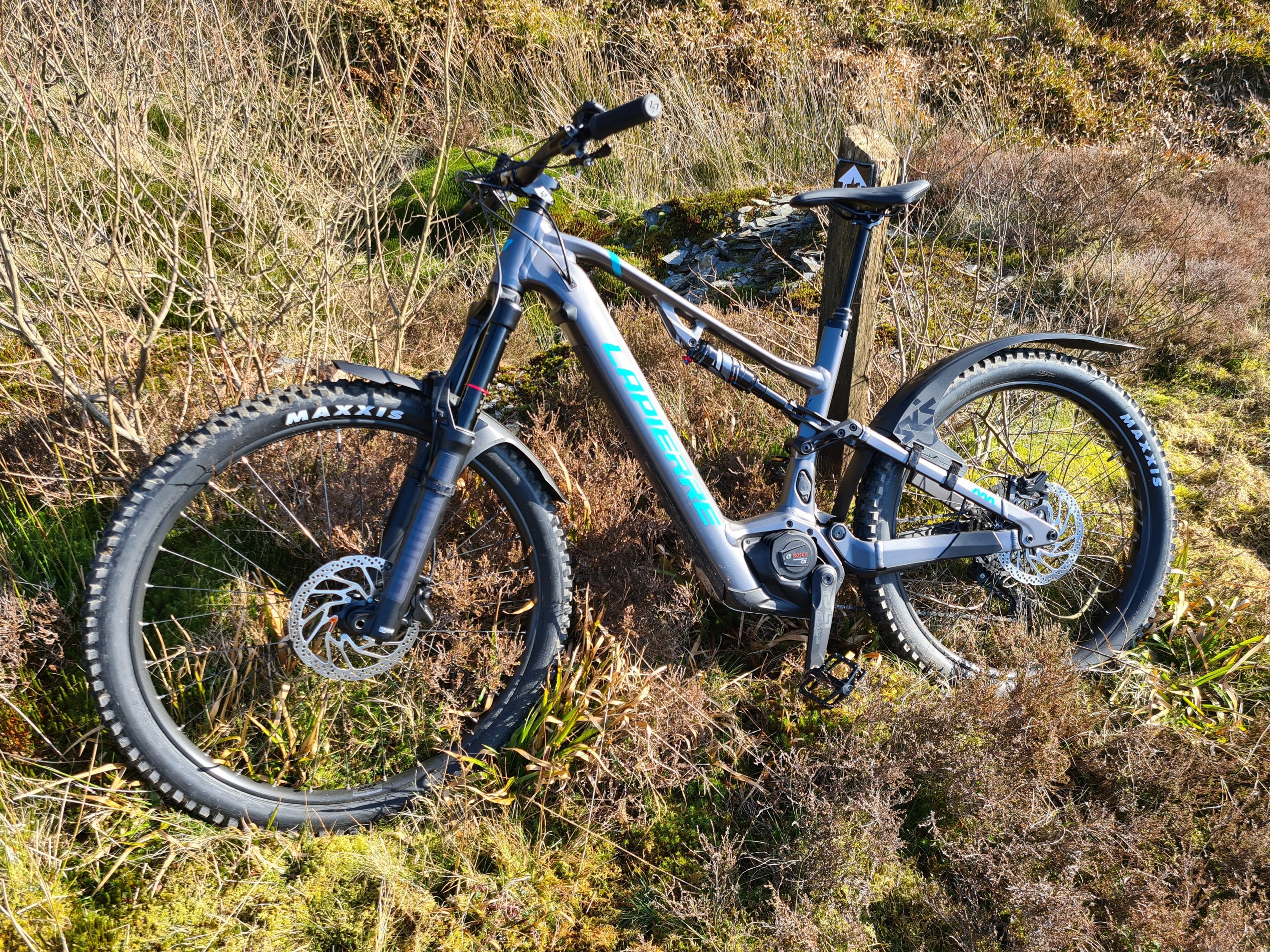

If anyone is interested in adding mudguards to this bike, I can highly recommend the SKS Mudrocker front and rear set, they for this bike perfectly!
I've ridden a few miles and no slippage or problems with these!

Funnily enough I was going to update this!
The bike arrived in a couple of days, fully built in a very large box!
It did come with some pedals (not mentioned online) but I had some DMR's ready and waiting.
It comes equipped with (new to me) shimano cues drivetrain. I realise from initial research that this is 'entry' level but I wouldn't have realised it. It all works very well. I am impressed with the Bosch Smart system, even down to the motor lock that only disengages when my phone is present !
I was also impressed with how quiet the bike was rolling along the trails. I have to shout out to people walking all the time.:ROFLMAO:
It comes with the Bosch LED controller. Just has led's for showing riding mode and battery charge. I missed the display of my old bike so I added a Purion 400 display. This is simple to install and integrates very nicely with loads of information as you ride.
After 80miles "testing" I do really like it.
However there is a slight glitch at the moment. The forks have started knocking. It took me a while to actually locate it. I sent an email (with a video) off to Pauls and to their credit they contacted me back really quickly (on a Sunday afternoon). I had the choice of removing them and sending them back (postage paid) for them to log it with Rockshox or take them to a local bike shop of my choice for them to contact Rockshox with £25 credit to go towards an inspection fee.
I sent them back and am waiting for an update at the moment.

I'm trying to upload a video that I sent to paulscycles but it wont let me!.
With the front brake on I was bouncing the forks and it was clonking.

One little niggle at the moment, i've noticed a light tapping sound over bumps, which sounds like it's coming from the shifter mech. Ive tried holding/pushing/pulling the levers while riding but it still persists. I removed it from the bars and tapped/shook it and cant make the noise. I'll have to try and disassemble it and have a proper look one day.
