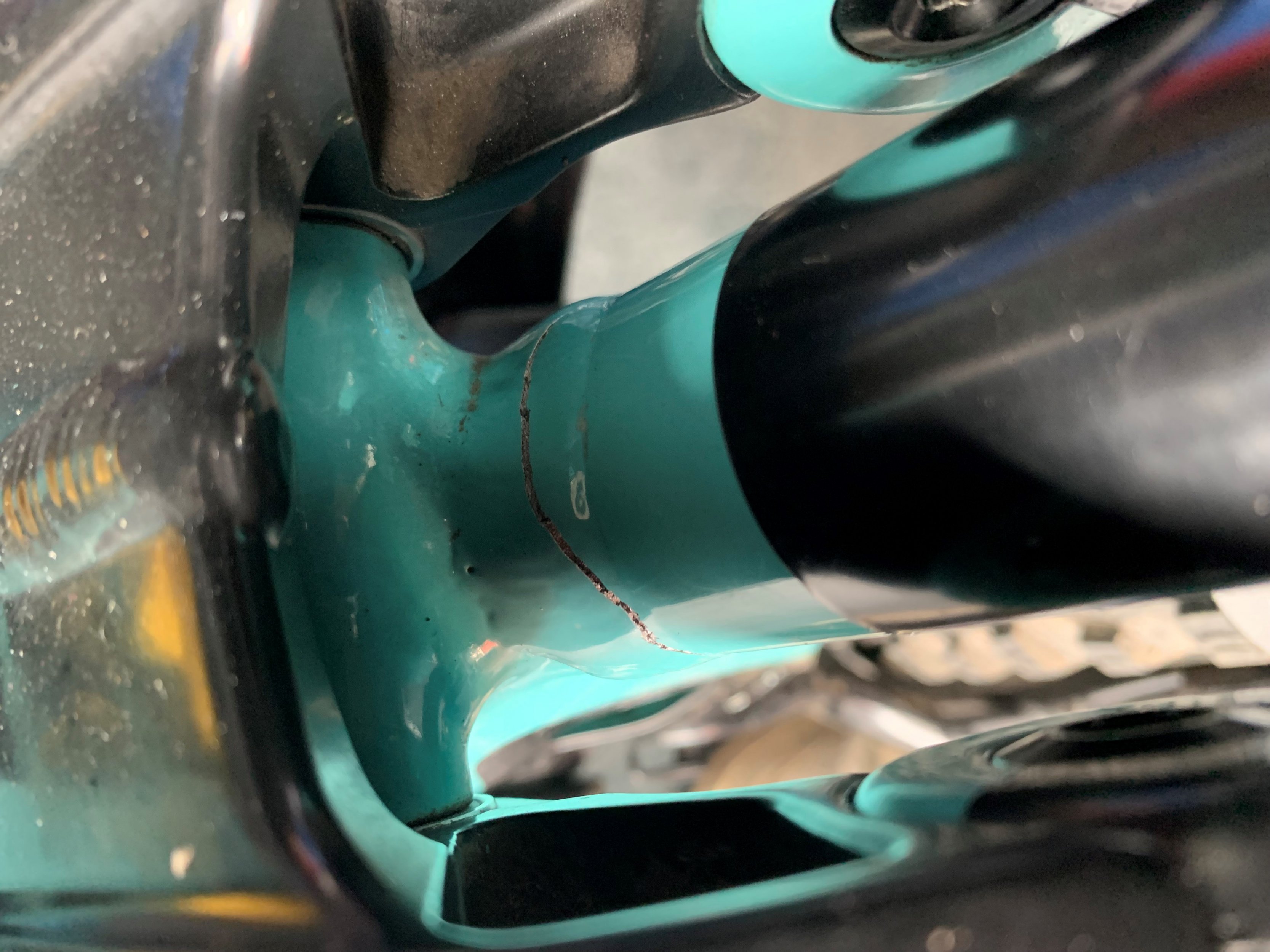

Hi, I would like to revive this thread.
I have now the same problem - crack at same position. My 727 is 4 years old with about 7500km.
The usual 2 years warranty is over but the frame warranty of 5 years still applies. Frames are not available anymore.
Accentry, the new owner of Lapierre offers current market value as refund if I return the bike.
But they did not mention a concrete amount yet.
Does somebody have experience on refunds within the frame warranty period for Lapierre Bikes? What did you get? What can I expect?
I am also thinking about getting it welded. There is a bike workshop close to me offering that service.
