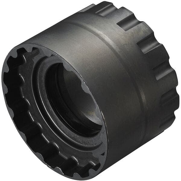

So, things to think about.
1. It's a fiddly job
2. Remove motor straight down, I tried tilting it and failed, it would've been so much easier
3. There's a few spacers behind the mounts, they're horrible to put back.
4. Chainring spacer/nut thing is reverse thread
5. Not all torque wrenches do reverse thread, I'd argue most don't.

Hey, that's top advice! Thank you. Never thought of the torque wrench thing. I have ordered one specifically for bikes so, fingers crossed it will be alright. Having said that, researching the Shimano "bit" I need to buy, they also sell a torque tool which looks perfect. Just a case of how much this all gonna cost!

Oh really?? I reckon I need to go to local Shimano dealer, buy a new chain ring and ask for the right tool..... Won't tell them about the PearTune... They seem to all get their knickers in a twist when you do!
Really really the LRT2 is for the earlier gen EP6 motor :)
