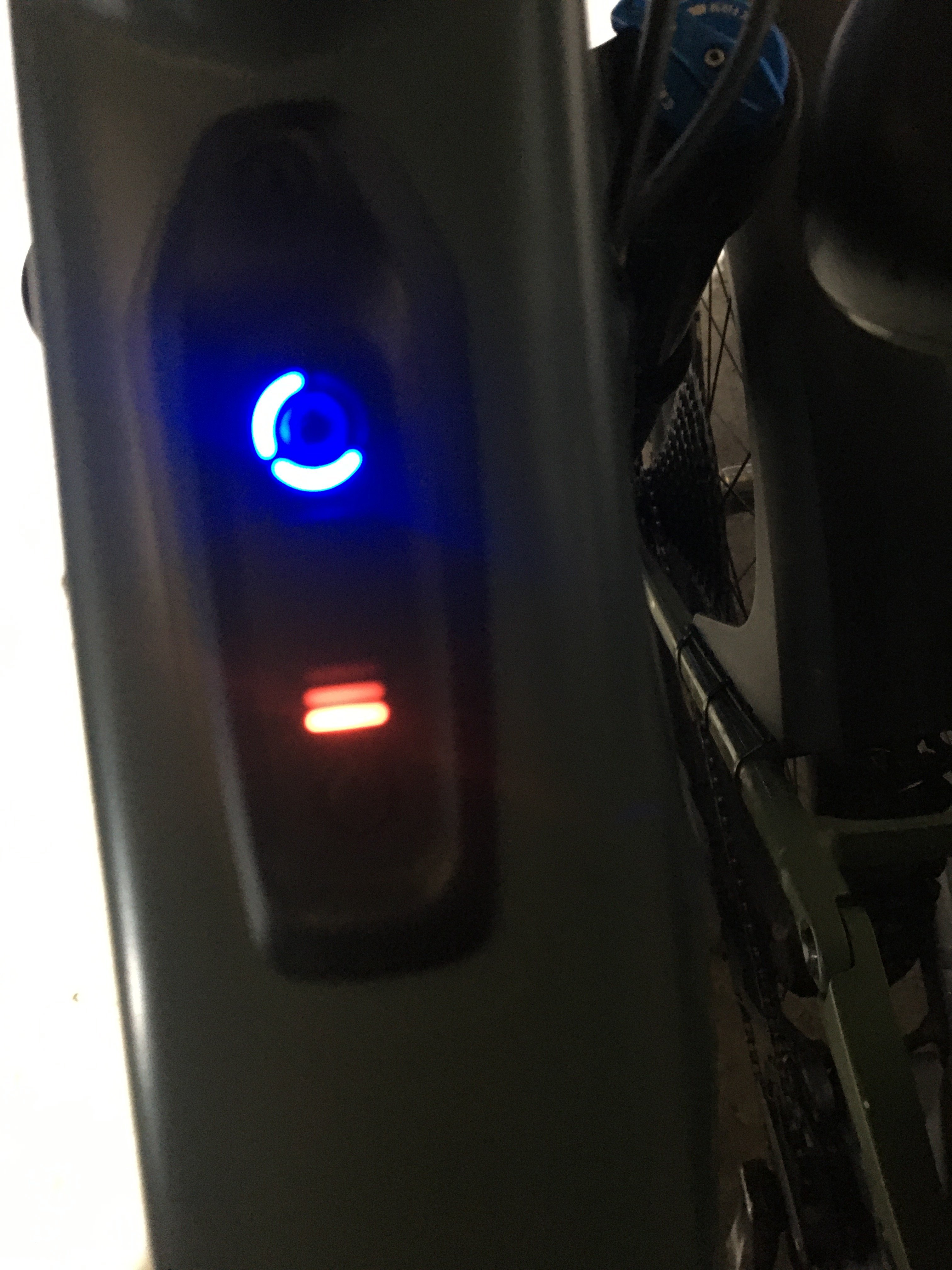

Hi,
my 2023 levo gen 3 died on the trail (in the wet)……now it won’t seem to charge and when I switch it on the old style tcu is flashing….i can’t relate the lights to the handbook and it seems vague to me, although the Spesh app has recorded the error l2-b-SS-8…..any ideas what this could be and how I rectify it please?
I did to no avail….went to dealer and they confirmed the battery was kaput…..luckily I was able to take,advantage of specialized customer support programme and got 50% off a new battery….still cost £450 though…but at least I sorted now(ontop of new motor foc in June …..even though I was well out of warranty. gold star to specialized !
