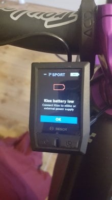

I fear you could be correct on your assumption here... as the kiox is now showing 'low battery' evan though its sitting in the cradle with a fully charged battery installed in the bike...20210822_194444.jpg
I fear you could be correct on your assumption here... as the kiox is now showing 'low battery' evan though its sitting in the cradle with a fully charged battery installed in the bike...View attachment 69567

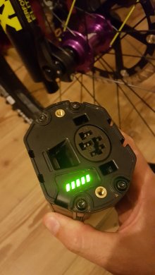

My bike has the old type power pack type external battery which could be switched on with a button on the side of the battery. I assume your bike will have a power tube battery, do these batteries have a button allowing them to be switched on ?

The Kiox can be charged with a USB cable, its a Micro A but Micro B cables do fit. [not that that's going to help much]

Yes i have the powertube 625w and it does have a button with light indicators which is showing the battery as fully charged. (See pic)

Thanks for that ill prob charge the kiox before i take it to the shop just so its gully charged incase tgere is something they can do straight away if its something simple... i am obviously expecting it ot to be an easy fix at this rate.

Ok, so i tried this and nothing turns on apart from the green led lights on the actual battery itself indiacting its charged. They go out after about 5 seconds.
But... with everything powered off and the battery cover removed i turn the kiox on and as soon as the kiox powers on the green led lights on the battery come on and off intermittently the whole time the kiox is display is powered on. As soon as i turn the kiox off the green led lights on the battery turn off. So there must be comms between the kiox and power tube battery?
