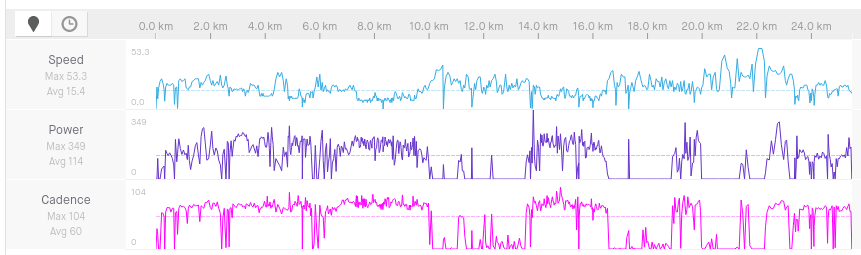

Works fine on my ebike with the Kiox :)
On the Bosch eBike connect website you can link your strava account, then export your rides with cadence and power to strava.
The only annoying thing is there is no automatical export of the ride: after each ride you need to go to the eBike connect website and export the ride. And it's also not possible to do the export from the smartphone app...
I hope it will soon possible to export it automatically, or at least from the smartphone app!

Strava analysis with bike speed (from the speed sensor, not GPS), power and cadence:
