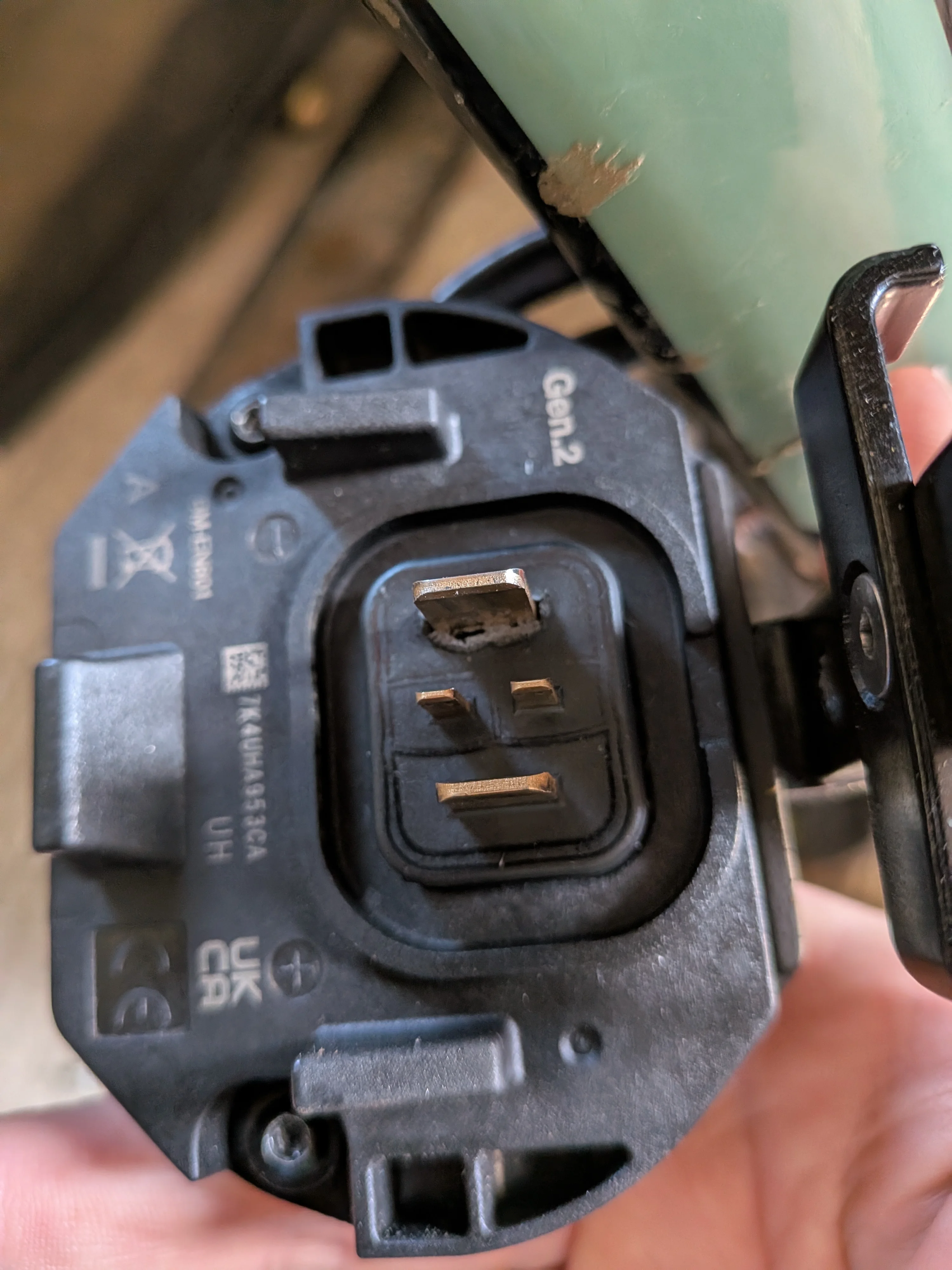

Checking back in and it's not great news.
Charged battery up and went for first ride.
First 15 miles were great then the motor cut out for no obvious reason but was able to start it straight away. Last ten miles of ride motor cut out 5 times but would start again.
Next day replaced new battery with original battery and did the same 25 mile ride and motor did not cut out.

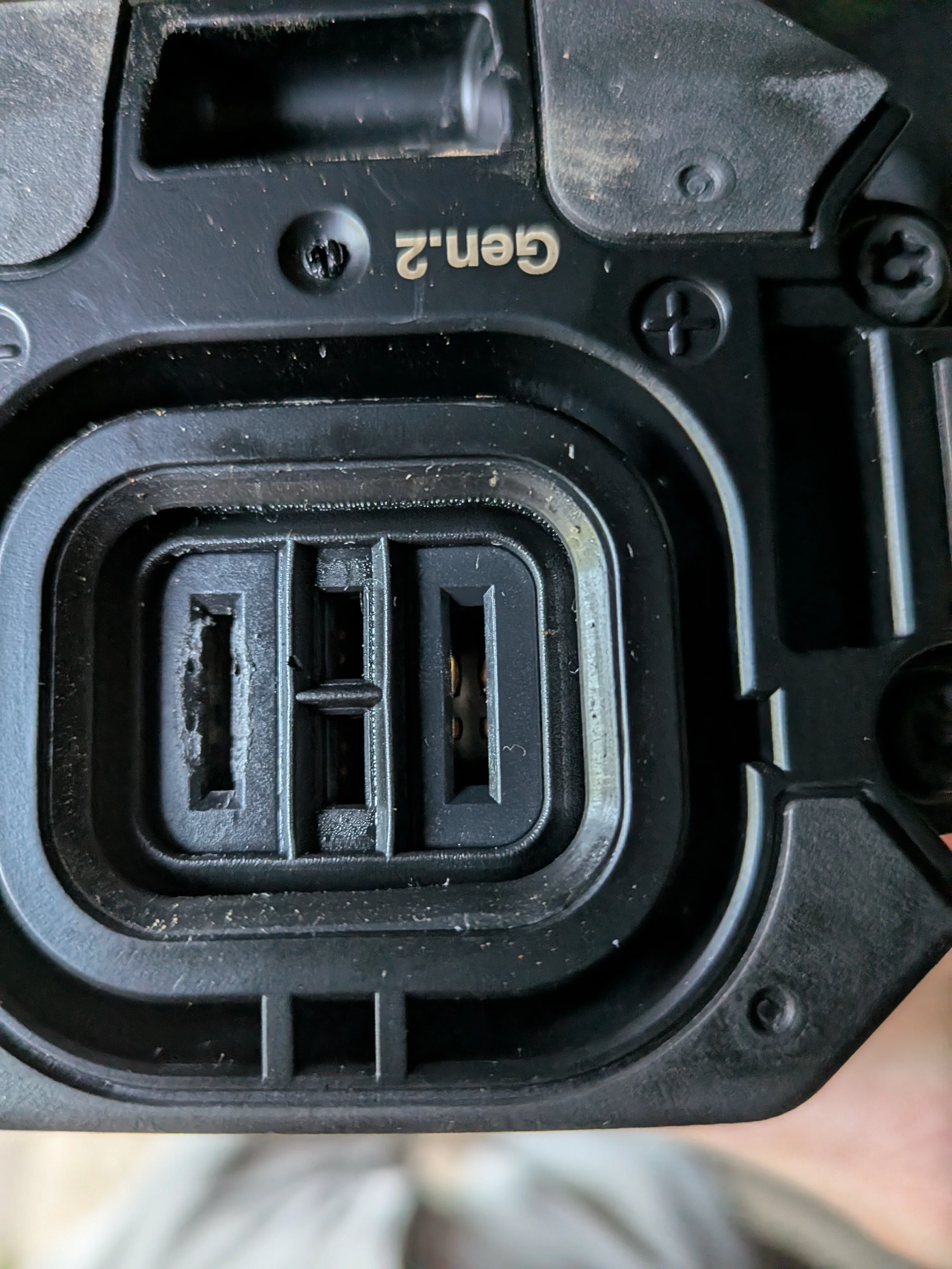

On examining the new battery it appears to has some scorch marks on the female and male terminals.
Any thoughts on this would be appreciated thanks.

@FJ1200a - that's a clear picture, and not a good one. Scorch marks on the terminals of a new battery tell you there's been arcing at the connection point - most likely a poor or intermittent contact between the battery and the bike. The symptom pattern fits: fine for the first 15 miles, then cutting out repeatedly as the connection degrades under heat and vibration, but recoverable on restart. Your original battery doing the same 25-mile ride without a single cut-out confirms the new battery is the variable.
A few things worth checking before assuming the battery itself is faulty: • The male connector on the bike - inspect it carefully for damage, debris, or slight deformation. If the new battery was slightly out of alignment or the latch didn't seat fully, that alone can cause arcing.
The terminal contact faces on both the bike and new battery - any pitting, carbon deposits, or burn discolouration.
@Plummet's post on a similar cutting-out issue makes the point well: poor battery connections typically present once there's heat and load on the battery, which is exactly what you saw.
The honest assessment: arcing on a new battery at the terminal is a warranty matter. Whether that's on the supplier or Shimano depends on your purchase arrangement, but either way - don't keep riding it in that condition. Further arcing can damage your bike-side connector too, and that's a more expensive fix.

In the meantime, a couple of practical points: • Document everything now - photograph the scorch marks clearly, note the dates and mileage, keep the original battery for comparison if needed. You've already done the controlled test (same ride, original battery, no issues) which is exactly the kind of evidence a warranty claim needs.
Don't use the new battery again until this is resolved. Further arcing risks damaging the bike-side connector on your Esommet, and that's a separate repair cost that muddies the liability picture.
Check your bike-side connector anyway - even one ride with arcing can leave carbon deposits. Clean it carefully and inspect for any pitting before your next ride with the original battery.
