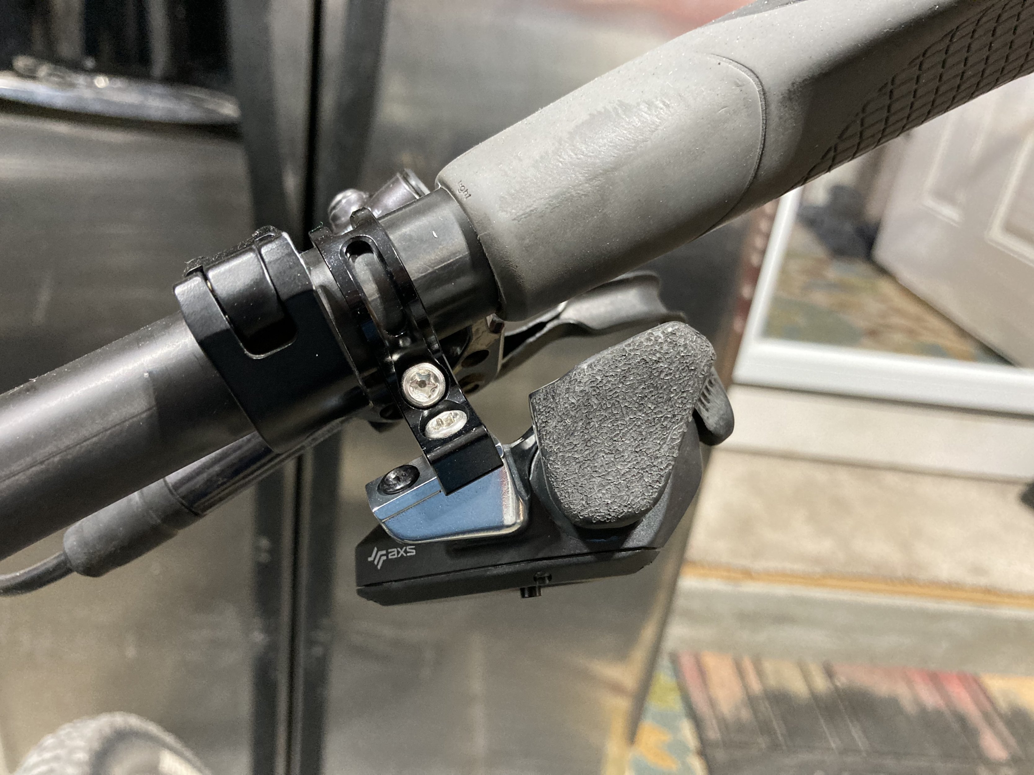

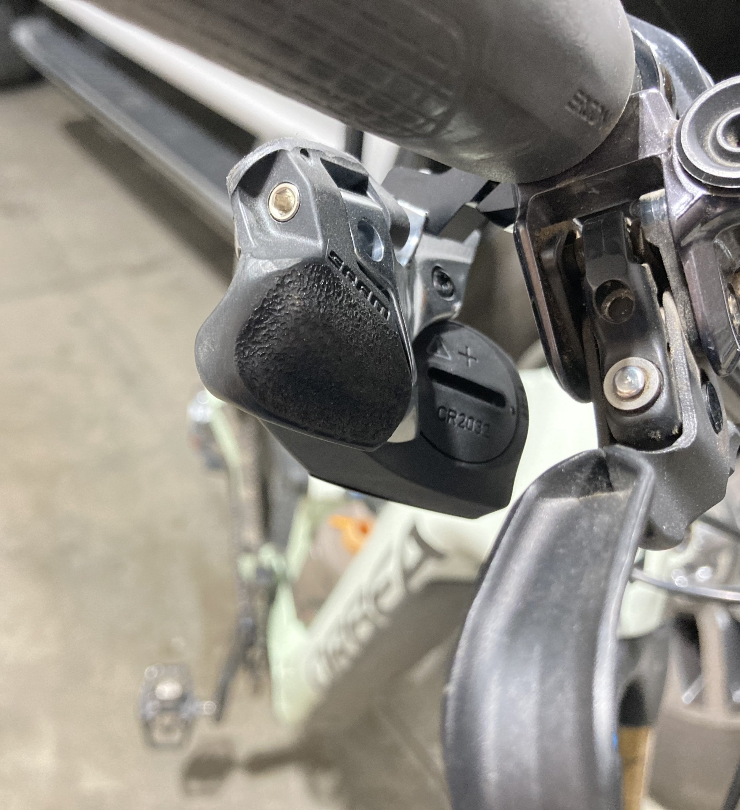

I too was having a hard time adapting to the AXS controller, because my other bikes are standard Shimano. I left mine configured, as from the factory. What I did do, is a lot of trimming down of the paddle, as you can see in the pictures. It now feels very close to the standard Shimano shifter. I have been training myself to not use my thumb to shift into higher gears, when riding my bikes with standard Shimano. Now I’m using just my thumb to downshift and my index finger to upshift. The AXS feels quite natural now, as I have been using Shimano forever. Another benefit of the trim down, is that I’m not finding myself, making unwanted shifts. Oh, I also did a little stippling, to provide a little traction. It’s also a Sramano setup and works perfectly with the Shimano SLX cassette.BBB9C3E2-463D-46BC-9995-278F10D23897.jpeg26CF66E8-51E6-4375-BD7F-447A7E935C06.jpeg
