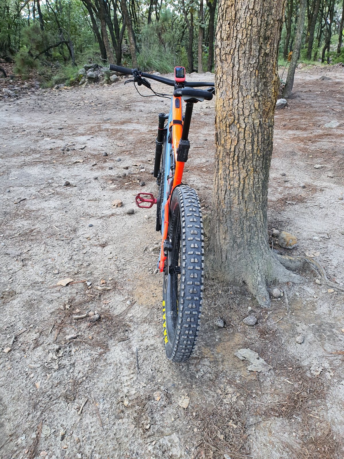

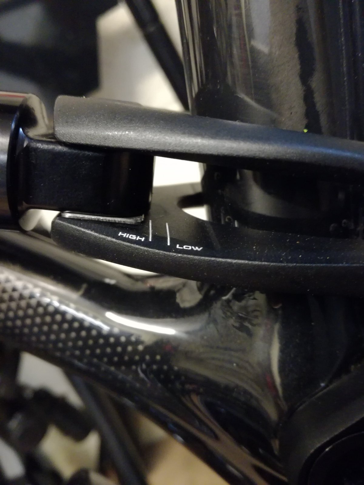

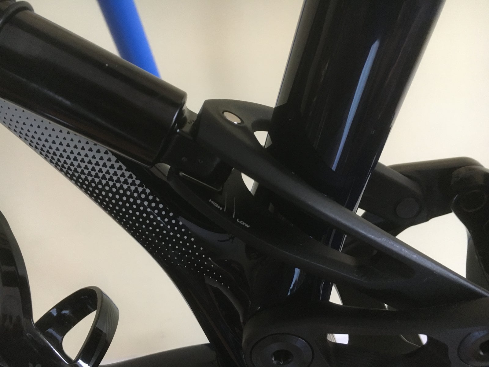

From the picture is it low or high? I just do not feel like disassembling to find out.
Dave91
Sep 30, 2019
21
52
Birmingham

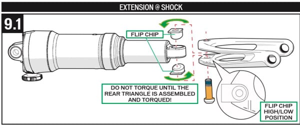

You're currently in the low setting. If you're wanting to move it into the high, undo that lower shock bolt and then just rotate the silver insert... This is the flip chip. Putting this in the high setting will raise your bb by 5mm and steepen the head angle by 0.5 degrees. Especially if you're changing the stock wheels for 27.5 and want to keep clearance ?

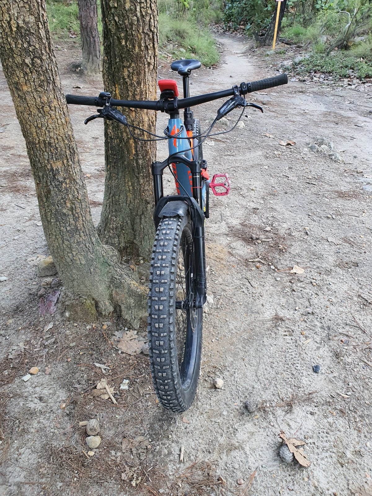

Thank to everybody for responding!

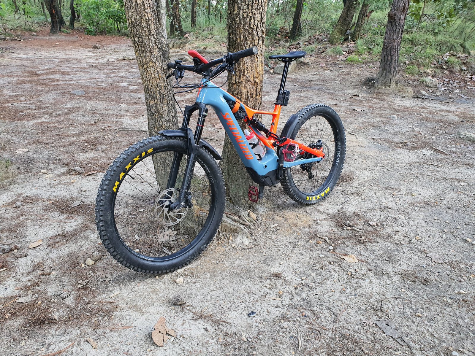

Yesterday I changed it to the high setting, it was very easy to do as stated here. The reason for changing is that I am trying a plus wheelset I have with High rollers in 27.5 x 3 and on the first ride I was getting more pedal strikes. I rode it again today and it is now a monster truck! but I need to do more testing to decide what I prefer.
Cheers!

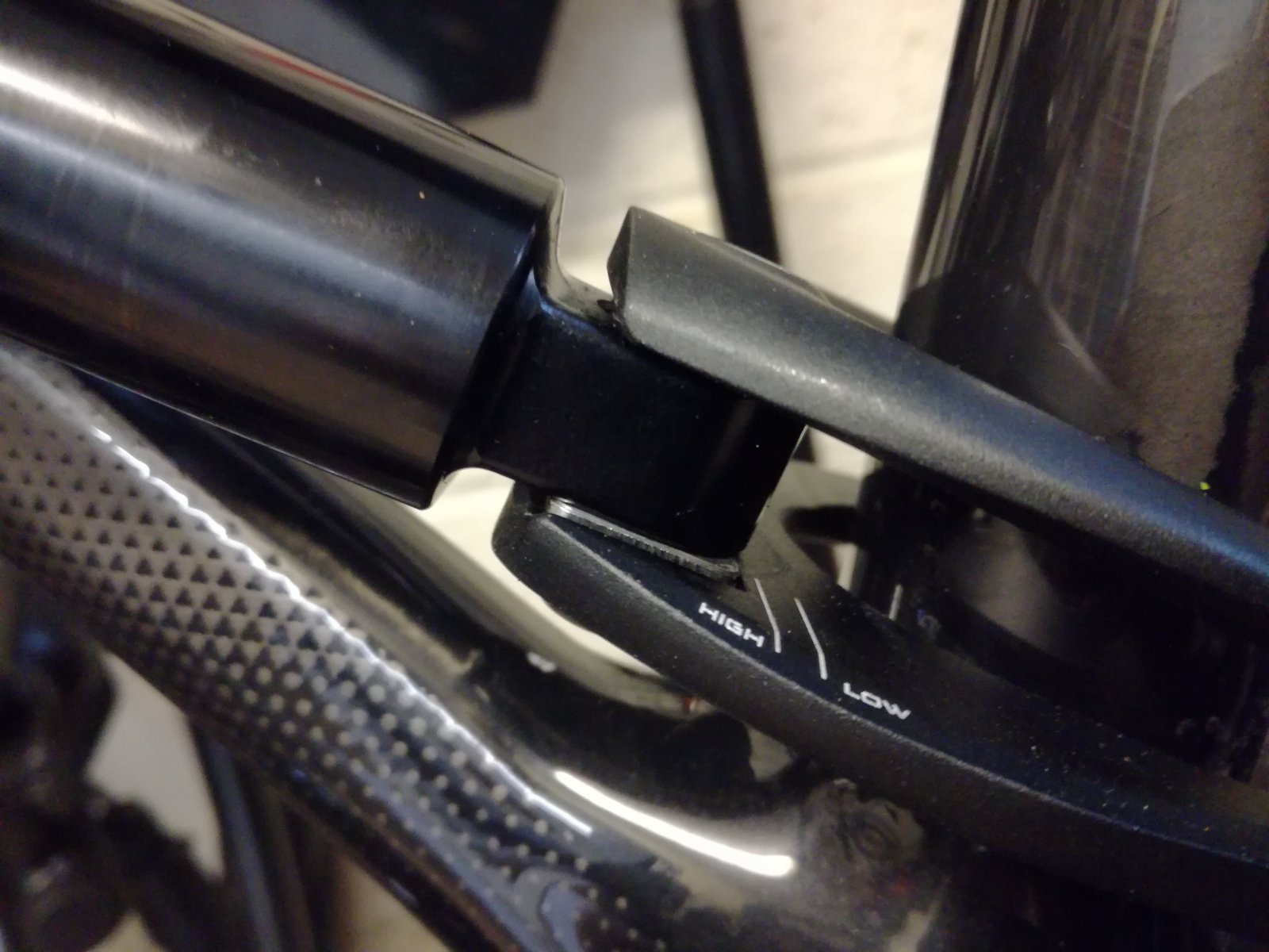

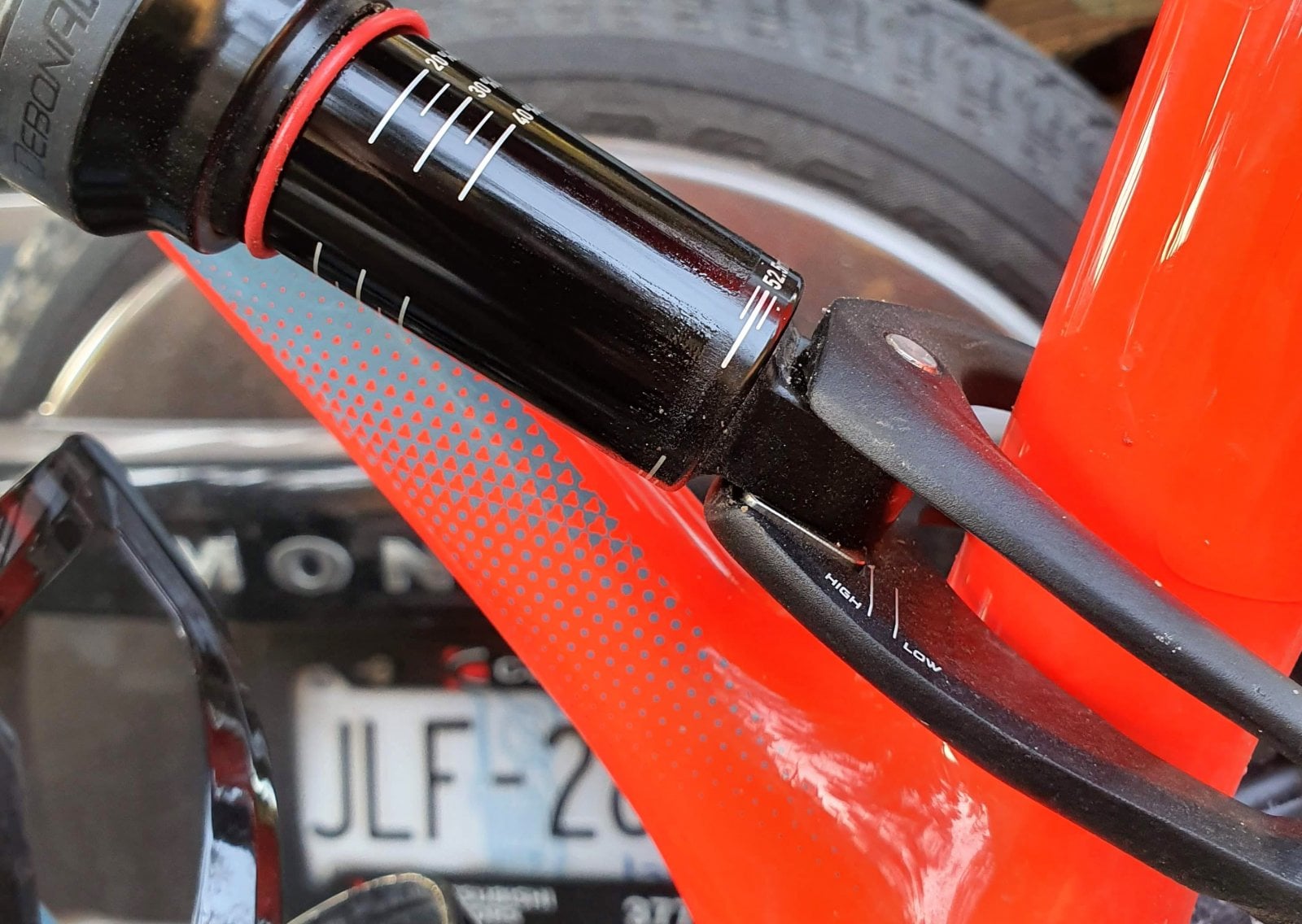

  • View attachment 19702
    So mines in LOW as well it appears?
    Brand new 2020 Turbo Levo base
    TIA
    (Sorry for the thread hijack)
    No, it is high, what indicates the position is the edge of the plate between the shock eye and the yoke. I just understood this yesterday...
That looks to be in the low position, in the high position your shock should look like this, the bottom of the eyelet should be inline with the high line, i measured the distance from my pedal to the floor (pedal arm dead straight to the ground) and it was 5mm higher than when the shock was in the low position
Well, my apoligy…
I was too quick to reply and did not notice the gap between the shock and the yoke. it is in the LOW position.
It seems I did not understood it as well as I thought :ROFLMAO:

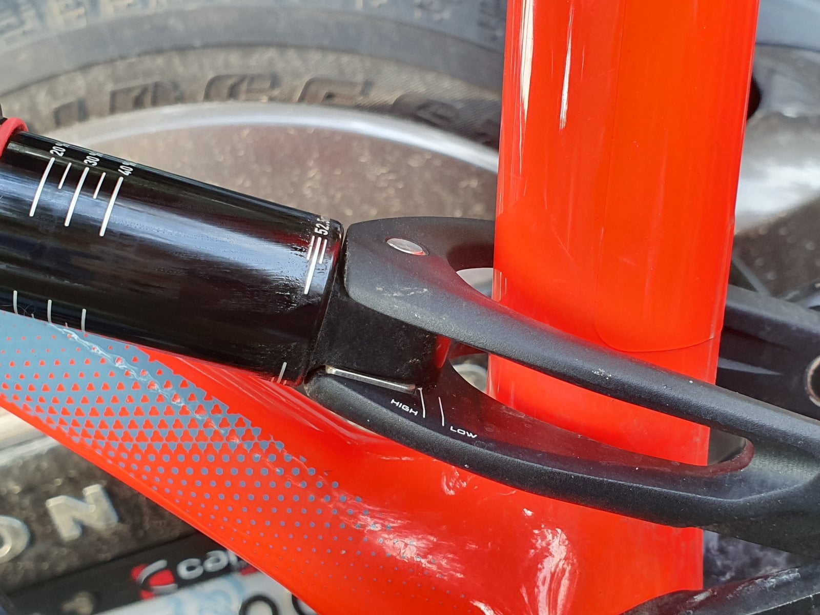

Just for reference this is how it looks in the high position so that other might be able to compare. And also how the bike looks with the plus tyres...

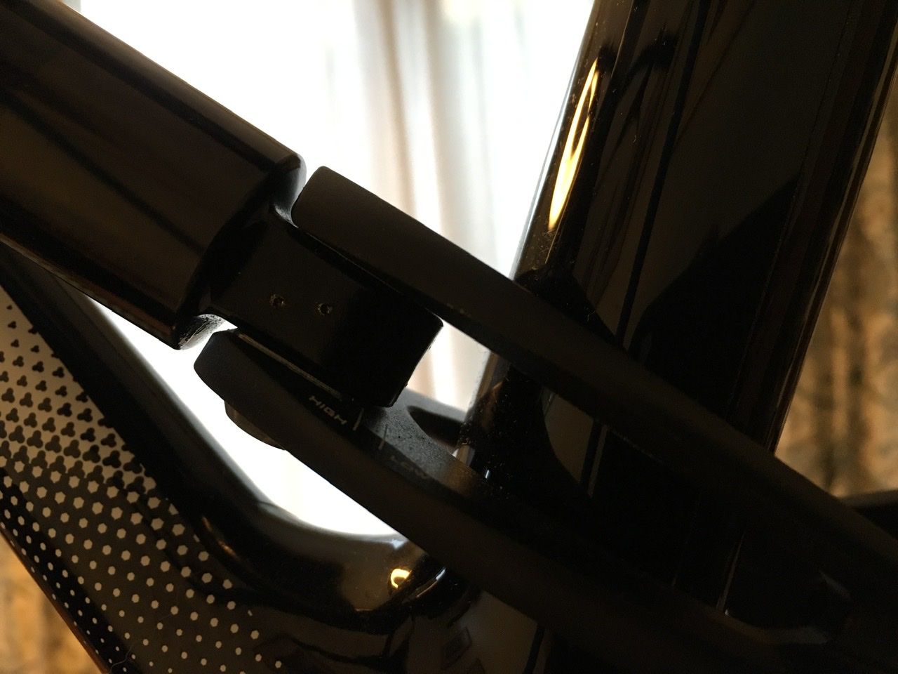

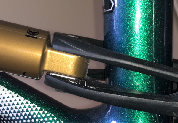

i can’t tell if mine is high or low,
This is not something I’ve thought about until seeing this thread, this is the sort of thing that makes this forum so great, thanks guys!
NULevo
Nov 7, 2019
539
341
Nottingham
If I understood correctly, yours appears to be in Low position, although it looks like there is a "big" gap in between the shock and the top yoke.
Thanks for the reply Grichka, I’m thinking its high because of the gap, my Turbo is on a Fox shock too which might make it look different to earlier picturges.

Mmh I see, then I won't know for sure. The only thing you could easily do is to measure the distance between the end of the crank and the floor, when completely straight to the floor, and change the setting, as it seems fairly easy to do. Then you'll know in which setting you are.
NULevo
Nov 7, 2019
539
341
Nottingham

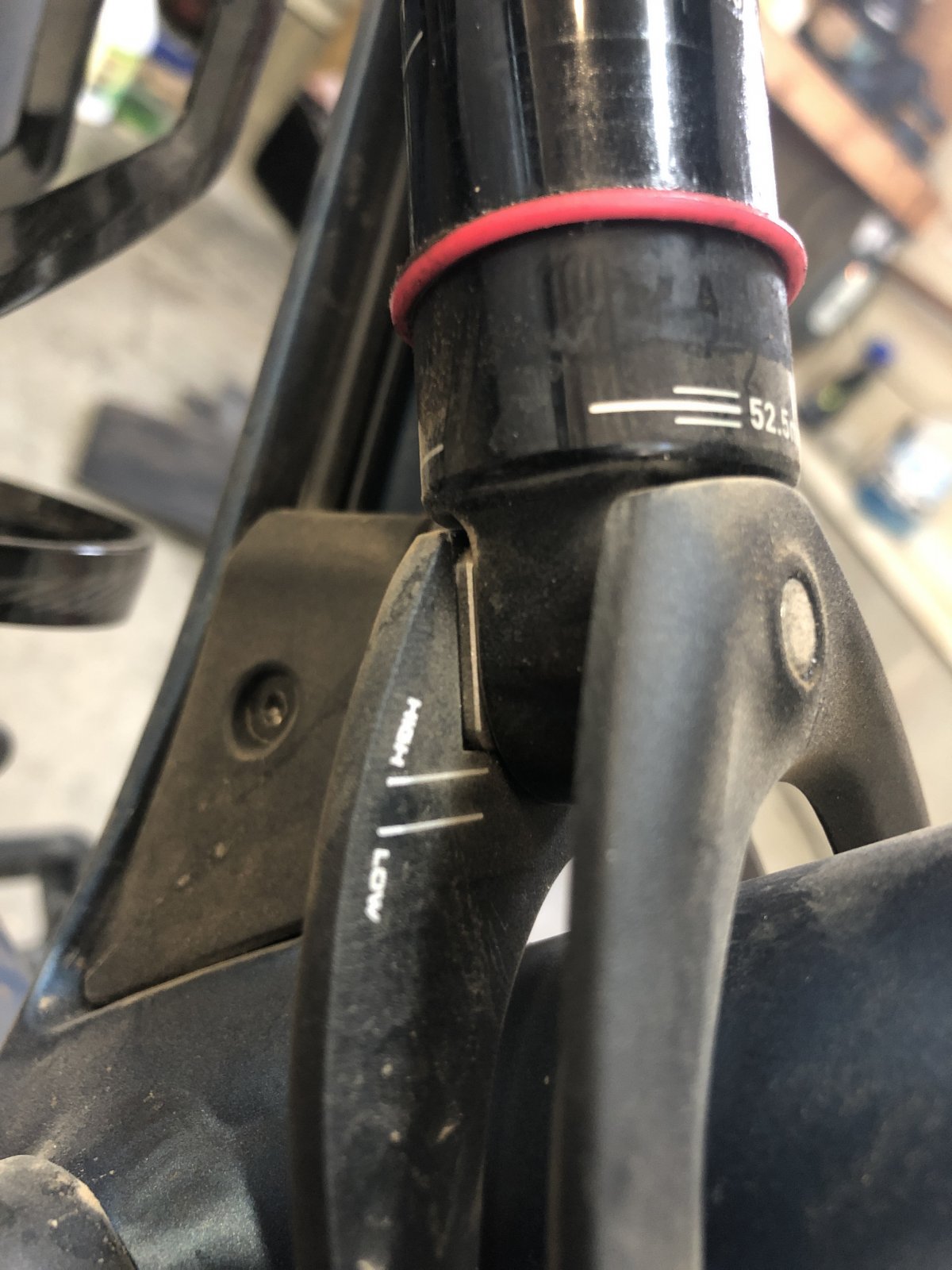

Thanks Grichka, I added another picture, just tried to loosen it, but it’s so tight it won’t budge. Like yourself, I’m interested to know what difference it makes.

Raising the rear speeds up the steering, down side is the bike will be a little bit more twitchy..
High setting for XC and more sensible rides.
Lower for fast steep decent..and stability.
I have mine set high as I live in a flatter area.
I prefer fast steering and twitchy too, bike feels better to me.
But it's a personal choice so try both..

my '19 shipped in high I prefer it in low. @Levo-Lon is right about the difference, but Levo is a pretty planted bike anyway.

Thanks Levo-Lon, Iooks like mine should be in high, like your area, it's fairly flat here too.
Is there any way of checking what setting it is in? it's a bit confusing at the moment.

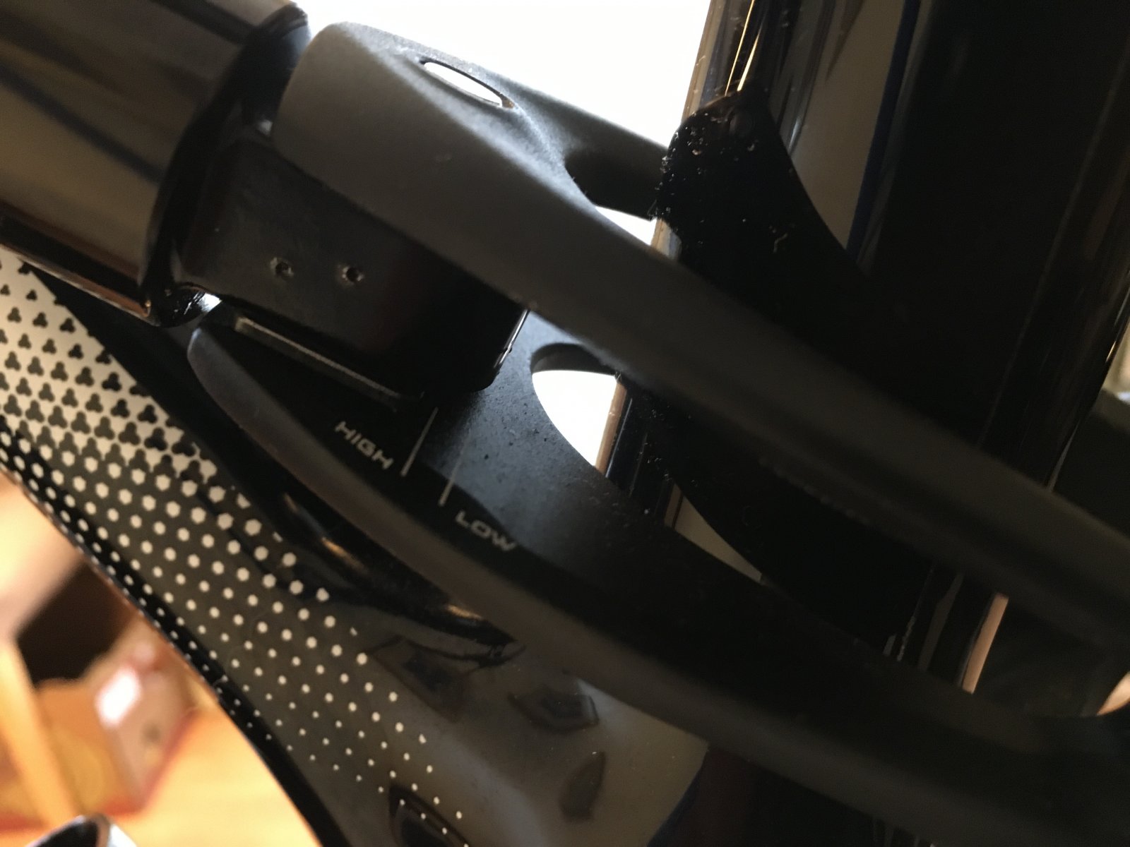

Well I've flipped! At the service yesterday I was told you don't need to let the air out of the shock to flip the chip, and to give it a go as it's easy to do.
I gave it a go this morning, only took a couple of minutes, not sure I'm experienced enough to notice much difference. Hopefully I'll notice the difference when I can get out for longer rides. Glad I did it though!
Before - Low
After - High
