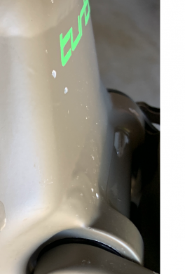

I installed my kit today on my 2019 Comp. I learned about invisiframe a bit too late as I have already accumulated quite a few chips in my chain stay bridge and my upper chain stay bridge. (See photo)
The sad thing is the kit did NOT come with protection in the two places I wanted it most. Directly in front of the rear tire there the (turbo) decal is on the bike and the upper chain stay bridge.

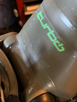

Everything else fit well, and I ended up improvising with the small square spare pieces of film to cover those areas. ( you can see the poorly fitted square film on the 2nd photo) unnamed.pngunnamed.jpg
