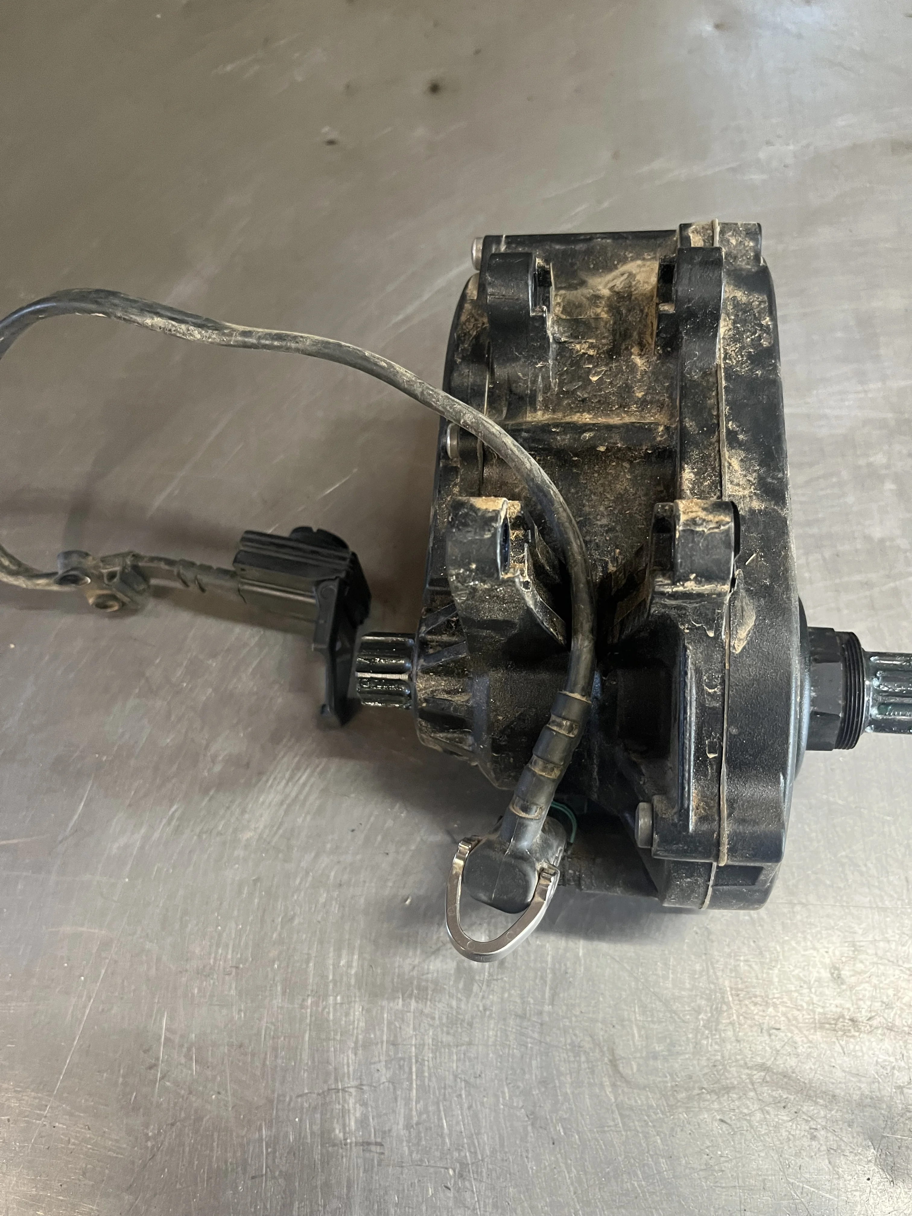

I destroyed my motor by attempting an out of warranty service at home. I know.
andybobbill
Aug 9, 2023
30
20
I know, I know. Let me stop you right there. In my defence I know about electric motors and the repair of, but sometimes life doesn't go to plan.
Once we're past that bit, my motor is f-ed. Magnet rotor damaged and casing cracked. I know what I did and I know not to do it again. However I do need spare parts. Where on earth can I find these things, in the shady underworld of eBay or some backroom forum here??
For reference it's a Bosch Gen 4 Smart System BDU3741 model. I could do without ponying up for a brand new one.
Any advice gladly and sheepishly taken...

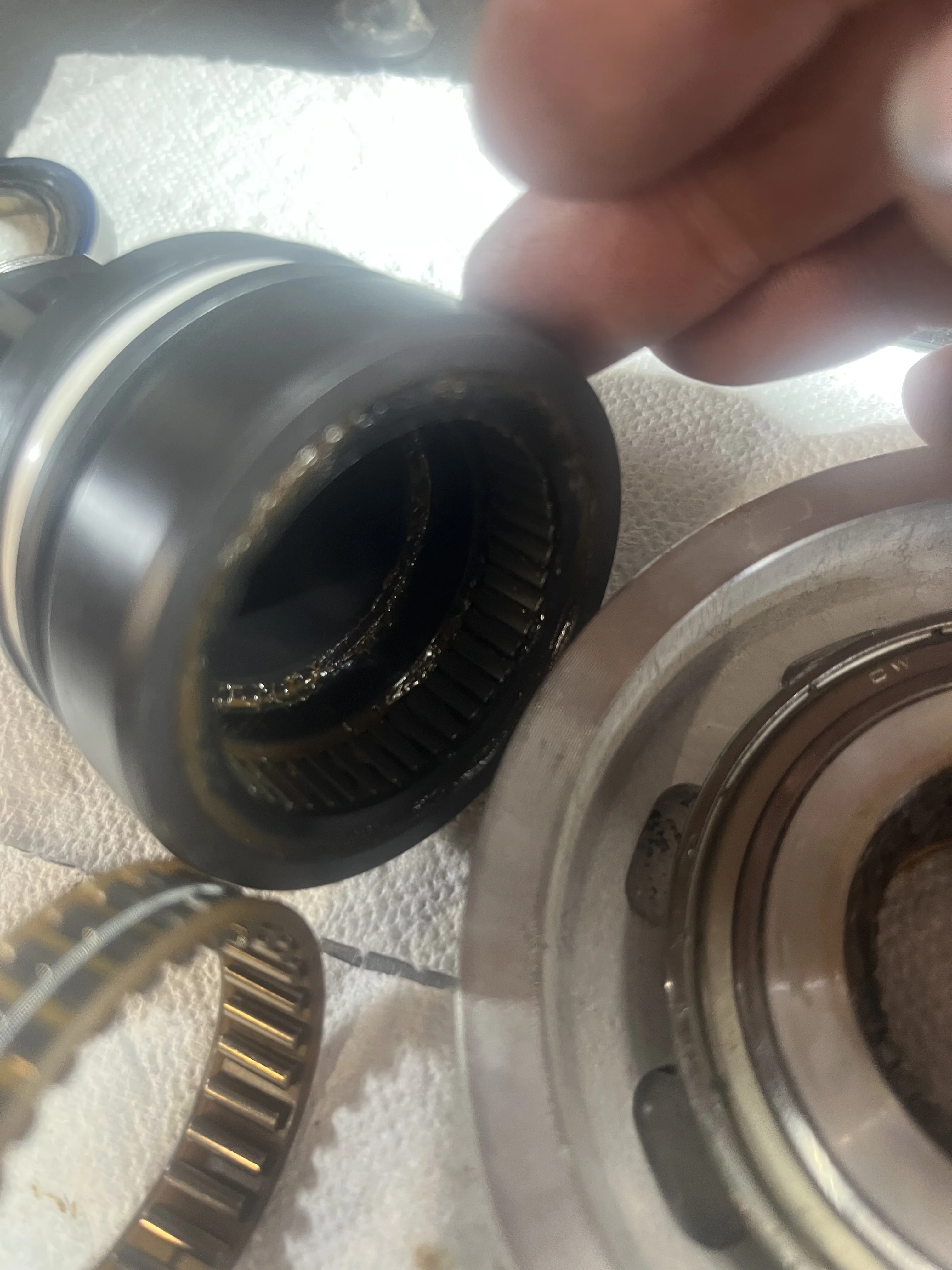

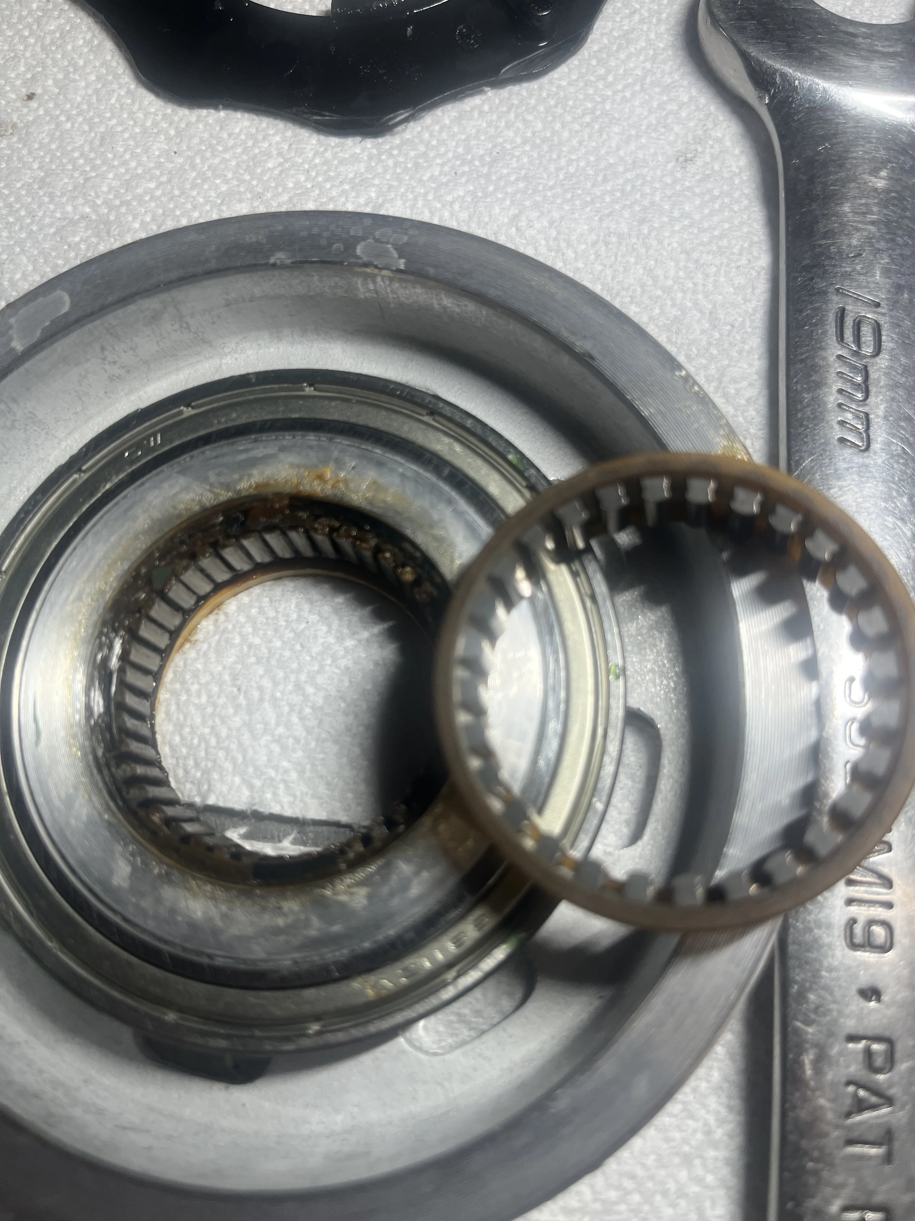

Thanks @Bearing Man. At this point I'm quite happy to hand it to somebody that doesn't have my cack-handedness. It's currently almost completely disassembled as I was chasing some rusty looking grease, which I believe I found the source of in the two reducer-gear bearings I've removed. I assume there's no point re-assembling before sending it to you?
