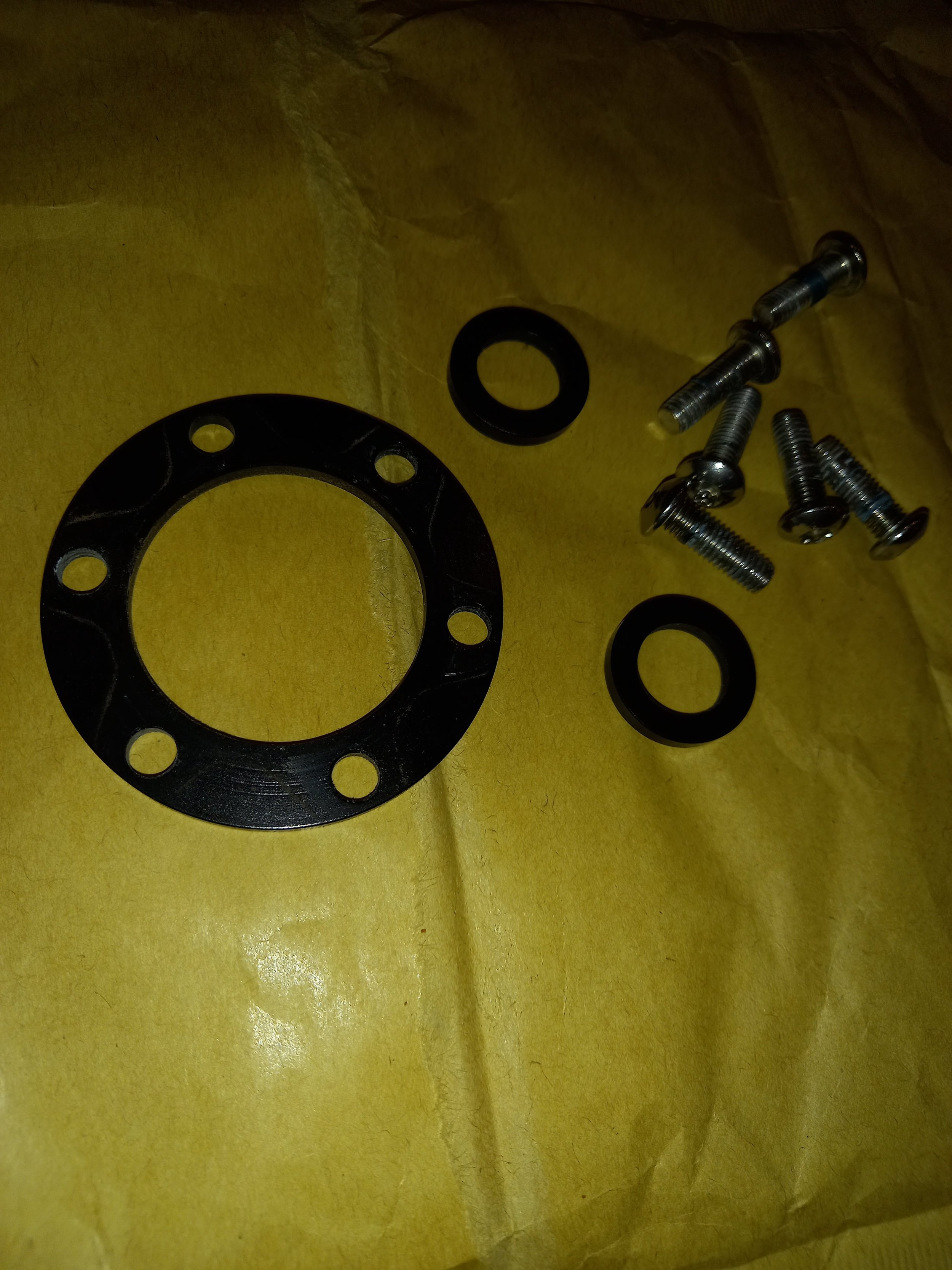

What you have done is to confirm that I can use a couple of 3mm thick spacers, which I assume are the two little ones in your pic above. But that big disc with the bolt holes (in which the bolts go I assume). What is that for?
PS: What is the search term that you used to find your kit?
Edit: That big disc with the holes is to go behind the brake disc, which needs offsetting by 3mm to line up with the calliper (now it's 3mm further away from the centreline of the bike). (y)

Yes. Mike I'd right. You have to move the rotor out 3mm.
Try something like MTB hub boost conversion kit 142-148 in ebay

@Mister cube The hub adapter kit arrived via Amazon yesterday for about £8. (see pic)
@WantAnEMTB You have identified a good point. I am assuming (hoping) that the limit screws on the mech are sufficient for the task. Because I am insisting that my grandson does all the work, it only gets done on Sundays, when he's not either working or playing rugby. So I have yet to discover whether the limit screws actually do have sufficient adjustment.
It worked OK with my mech. I guess the alignment to the chainring wasn't optimal, but I didn't notice anything
