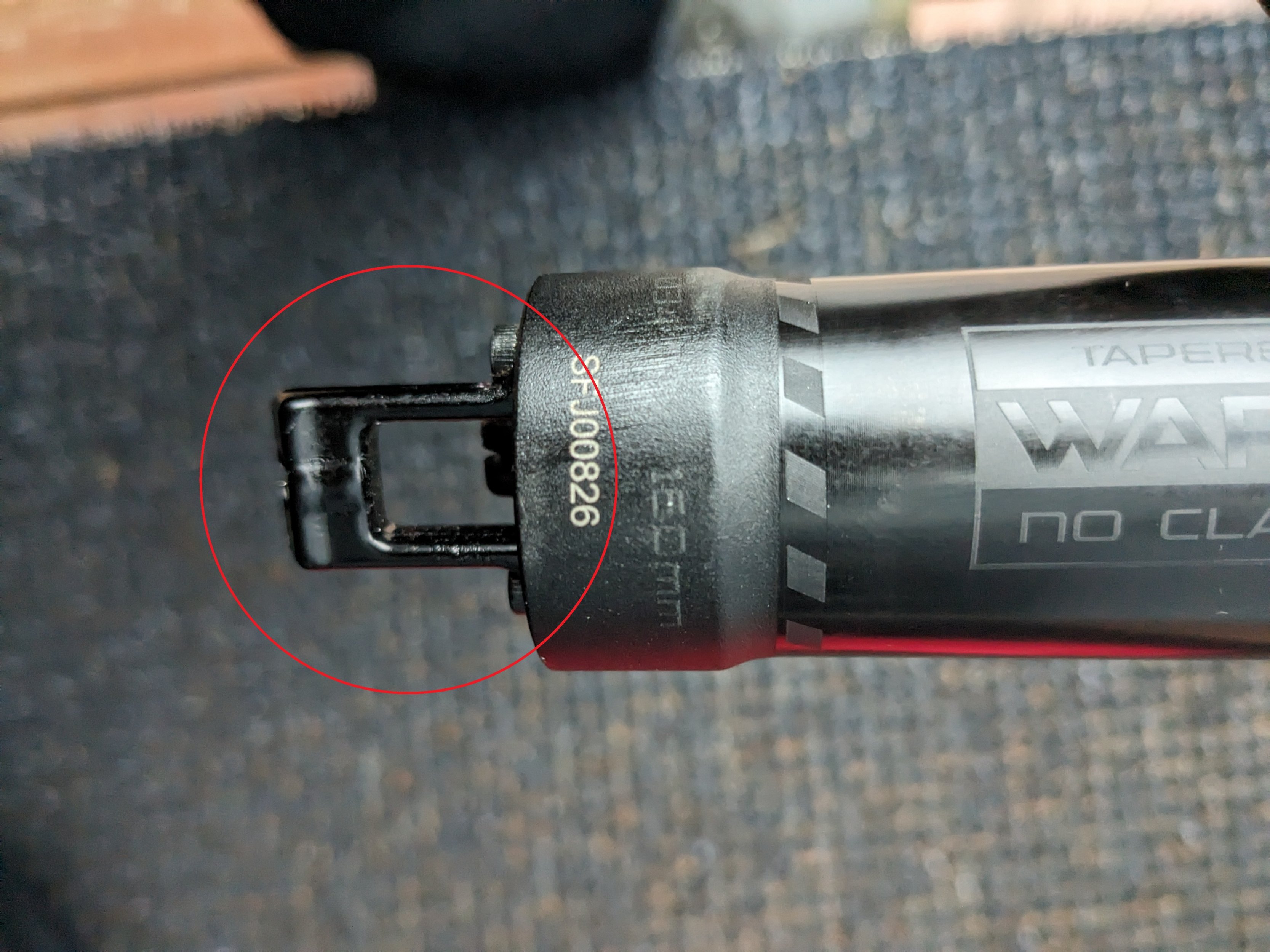

Ignore the first pic, I tried to post in order.
It shows some damage to the inside of the collar from the brass keys. I turned this upside down on reassembly.
