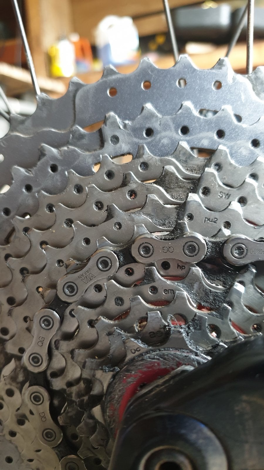

Lots of burs on cassette, I usually file them off on my commuter ebike and skipping stops. But it's an 8 speed and 1000 watt beast with ridiculous amounts of torque. New chain and cassette every couple of months, hence the cheap 8 speed.
Funny you should say that. As a little experiment I took the cassette apart and reconditioned it with a file and dremel.. Put a new chain on and away I went. perfect. Before the puritans burn me alive.
1. I've ordered a new set of gears and chains (3)
2. gears are filed to better profile but still the same number of gears on the same pcd.
3. I ride on sandy trails which are hard on the gear so not too worried.
It's all working smooth and reliably.
it will be interesting to see how long this works. new cassette will be here soon I hope.

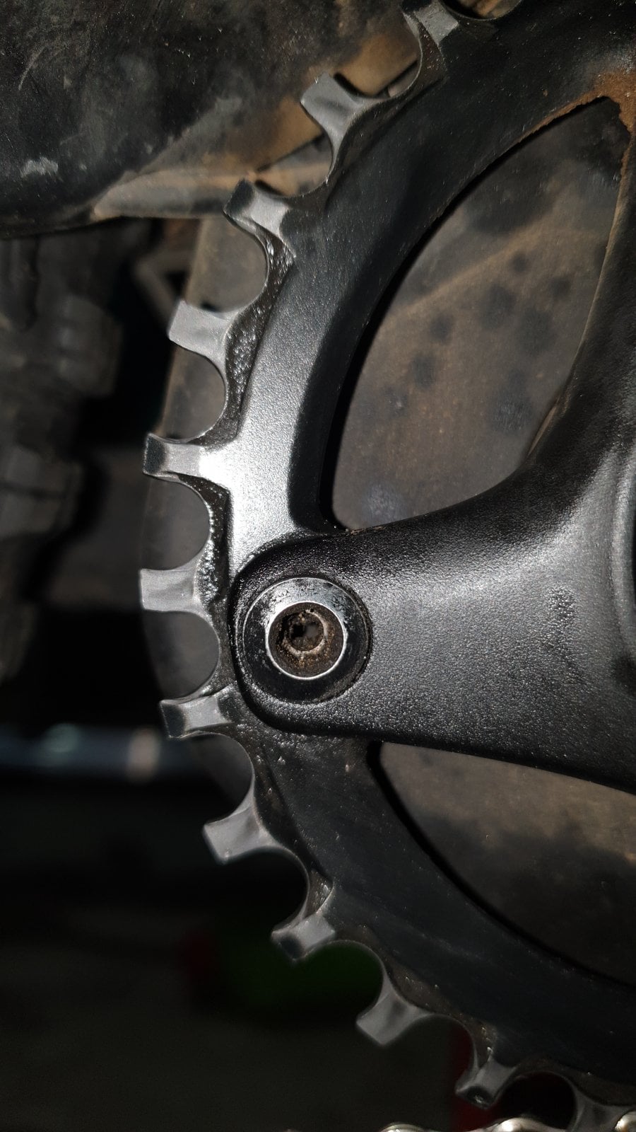

brizi2003
Nov 20, 2018
235
144
Whickham, Newcastle upon Tyne
Was out 2 days ago 25 miles thought noise was mud on chain. Out today planned long ride noise worse , chain not slipping but shuddering coming of front chainring . Put back on old chain and see what happens. Tempted to try 27 inch wheel off my Nicolai and see what happens.
When I had this problem it was the front chain ring. Old chain worked fine. New chain 'stuck', shuddering as you say, as it left the front ring travelling back to the rear mech. Changed the chain ring and that sorted it.
