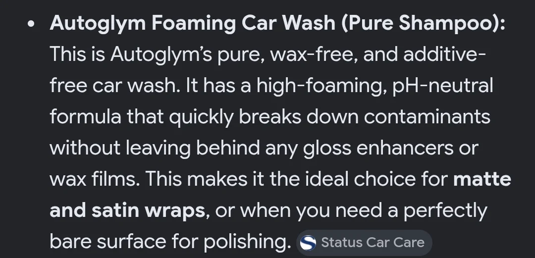

I don't wash my bike much but when I do I spray the whole bike with Peaty's Loam Foam or heavily diluted wax-free car shampoo (Auto Glym), degreaser on the drivetrain if required, scrub it with a brush, rinse it off. Never had an issue with contaminated pads.

Wow I'm surprised that car shampoo doesn't cause contamination, and also that you're able to spray degreaser on the drivetrain without getting it on the brakes. I've not tried the Loam Foam yet, maybe I'll try that next then 👍🏻
