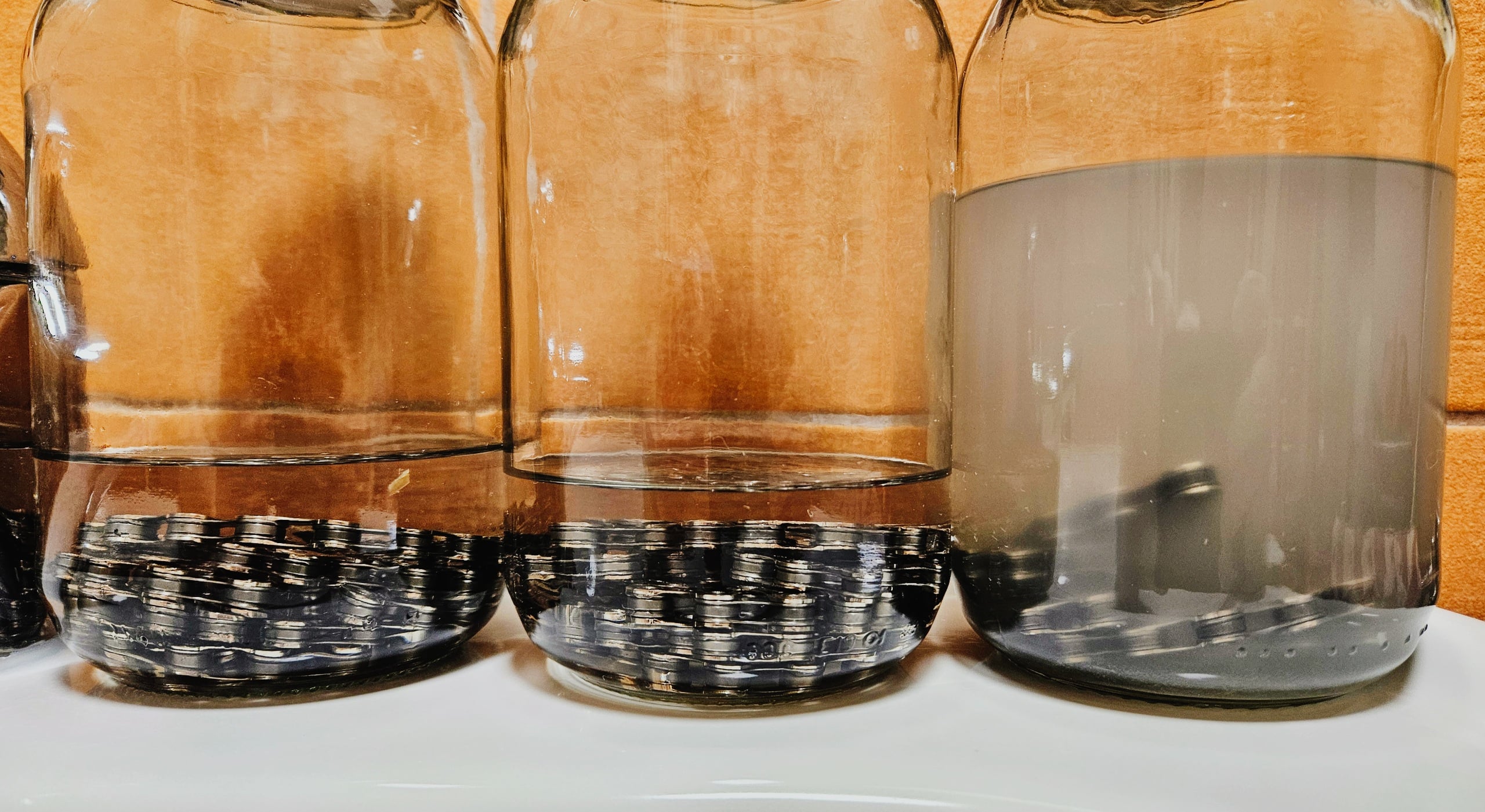

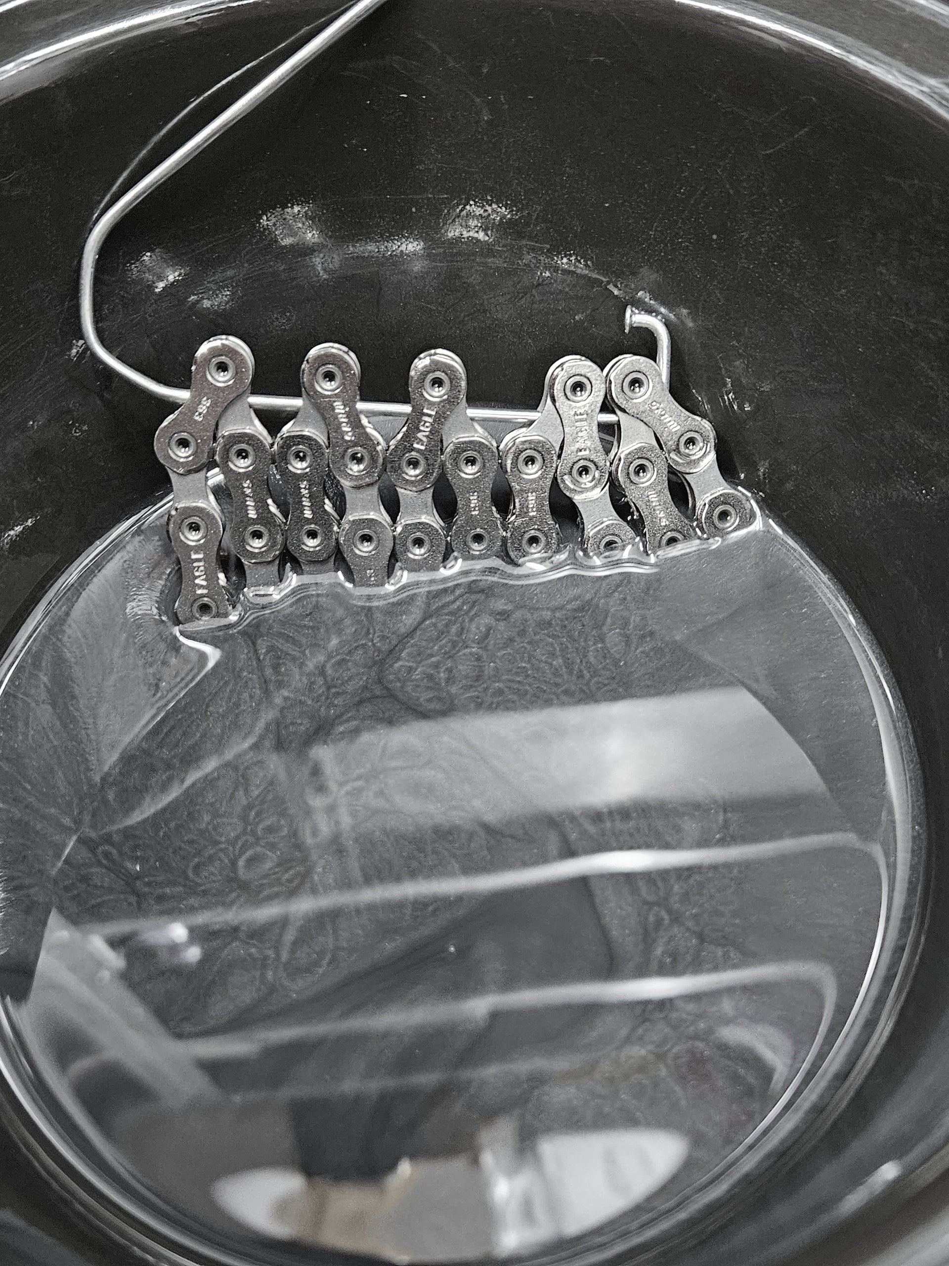

In my 25-year "bike career," I've tried many different chain lubes: wet, dry, graphene infused, drip wax, etc. However, in the end, all of them, more or less, led to a dirty and gunky drivetrain. So, I finally decided to join the Hot Wax gang. At the same time I upgraded the cassette and chain(s) to SRAM X01, as my SRAM GX chain disintegrated after 500 km (see below).
Preparation of the new chain (stripping the factory grease) is a royal pain in the neck. Five baths in white/mineral spirit, followed by two baths in denatured alcohol, did the job. It's crucial the chain is as clean as possible for the wax to properly bond with bare metal and do its job.
(4th bath on the left, 1st bath on the right)

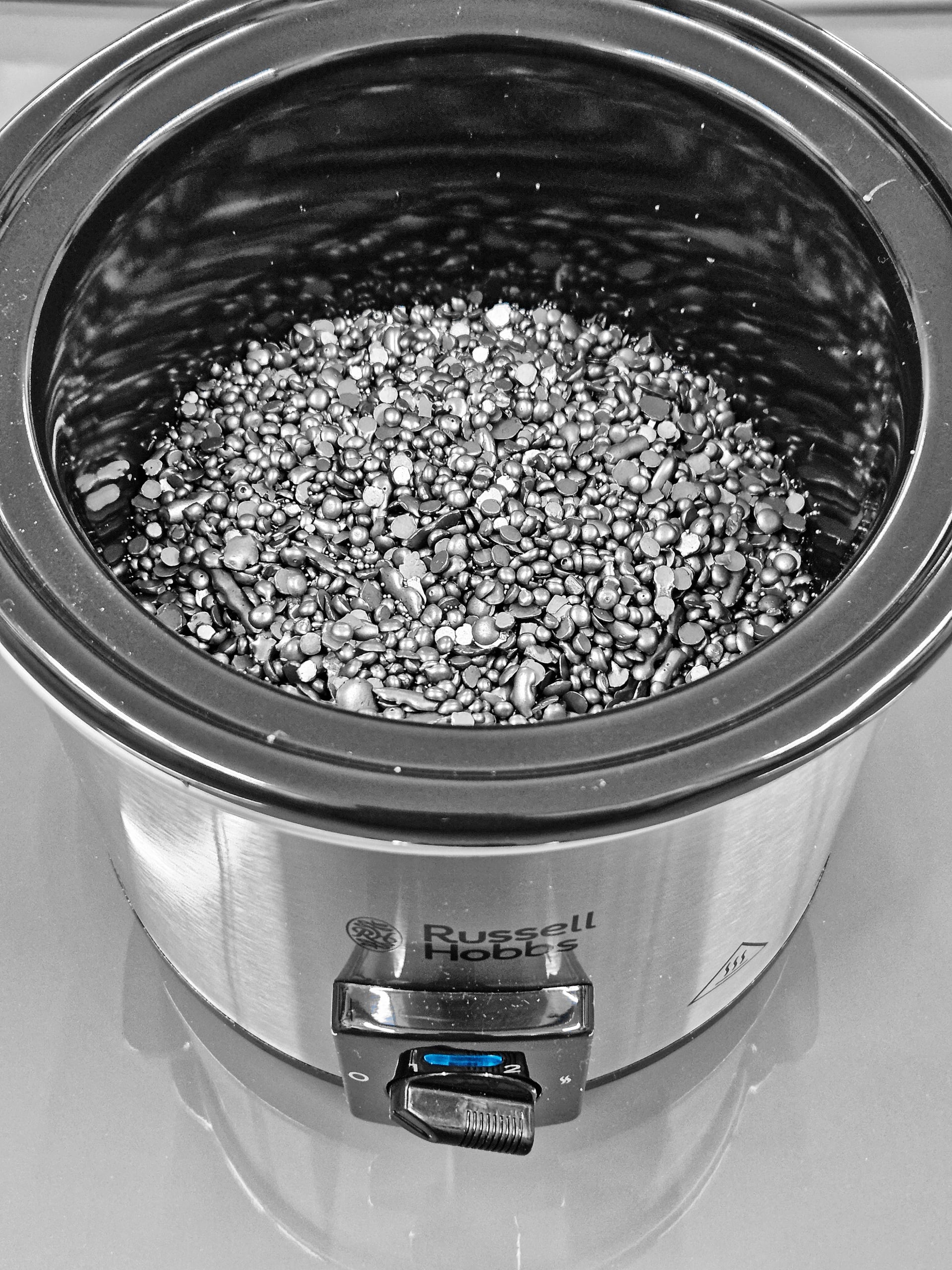

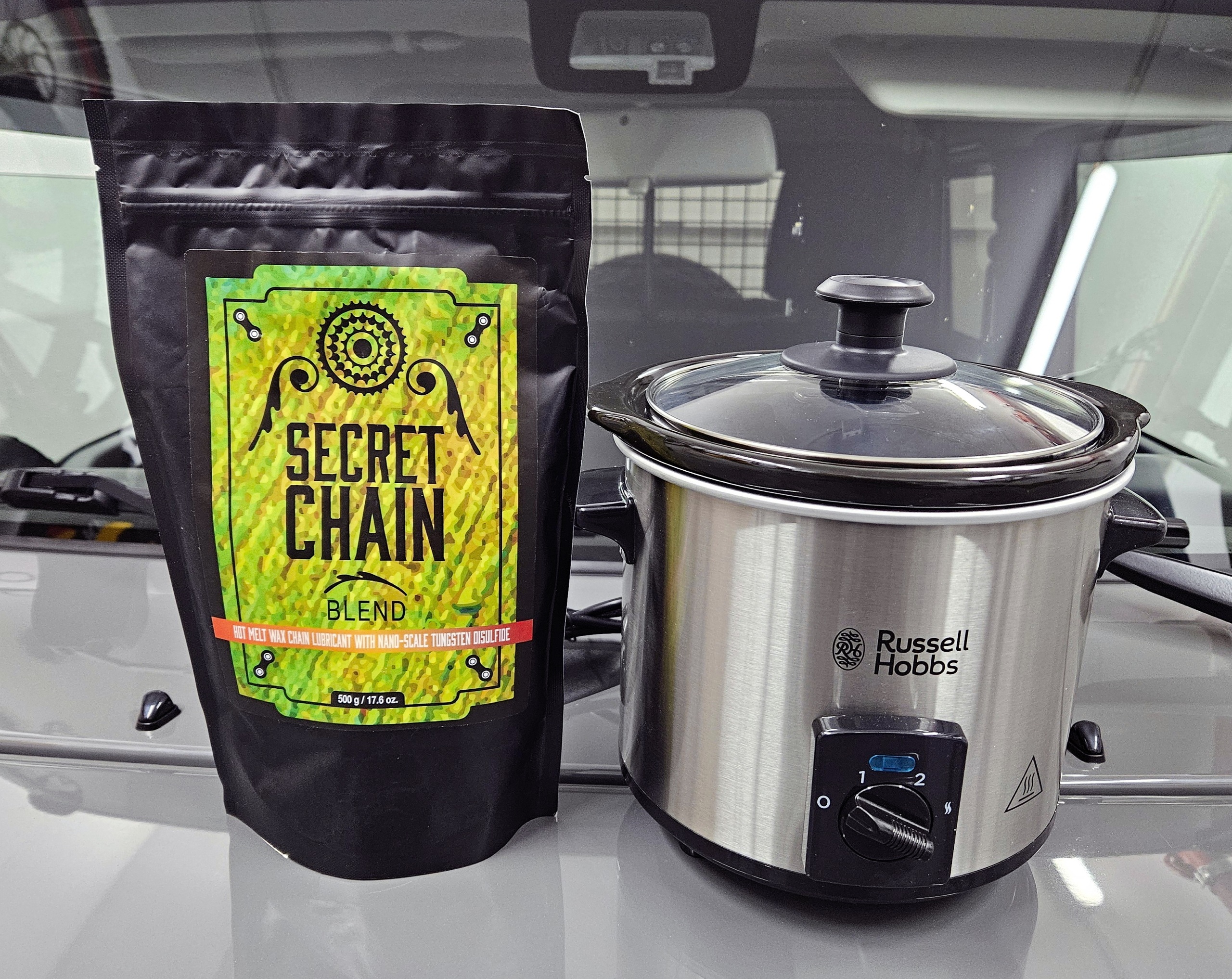

After extensive research, I have decided to opt for the Silca Secret Chain blend, which utilizes highly refined paraffin and a high concentration of three specific sizes of nano-scale Tungsten Disulfide to provide chain protection and coating.

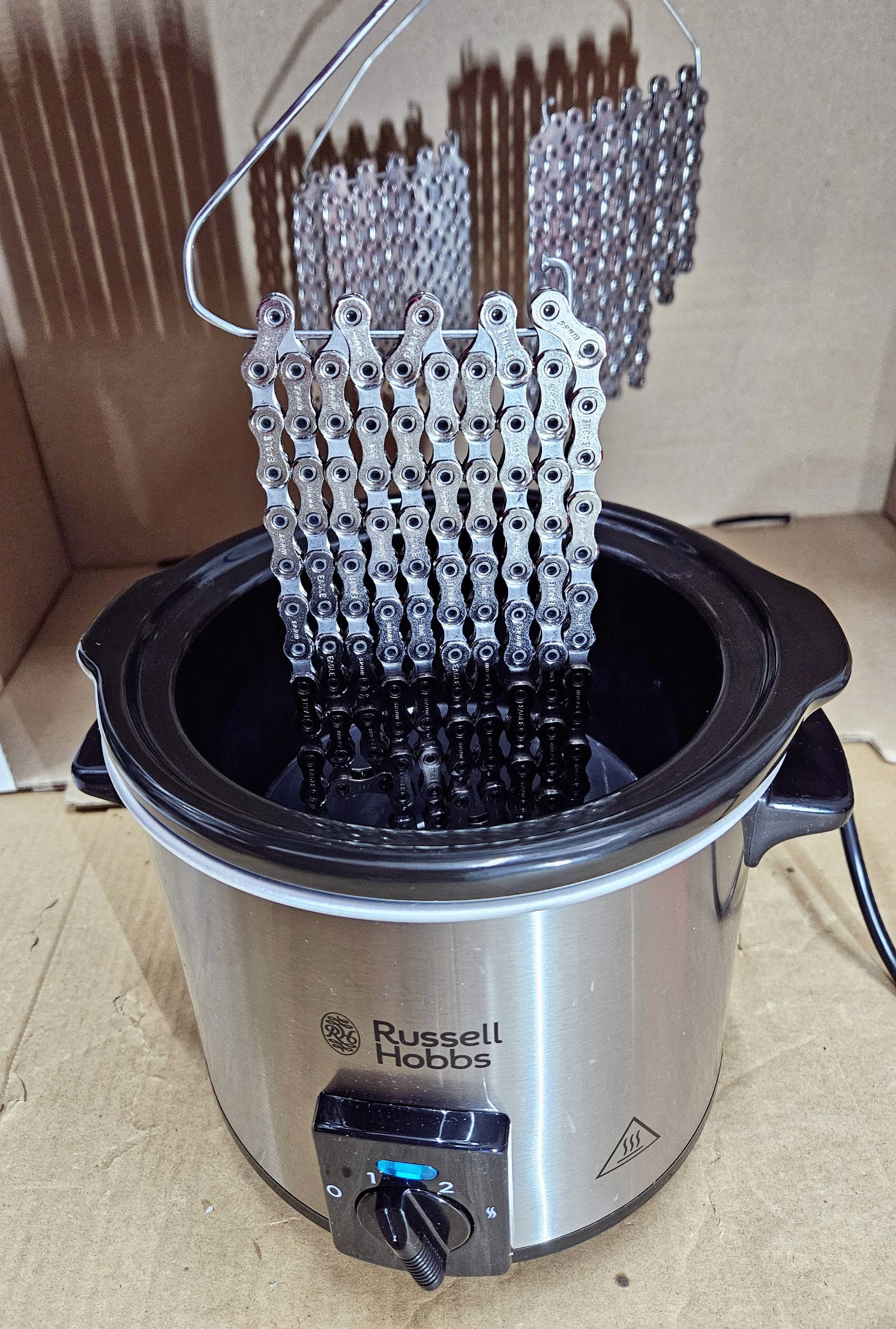

The Immersive waxing process is straightforward: put your wax of choice in a slow cooker, throw in the chain, wait until the wax melts, swish the chain a couple of times, remove, and hang to dry. Done.
I'm looking forward to the first ride and the durability of the hot melt wax. I will try to keep a log and share my experience after a few rides and in the long term.
