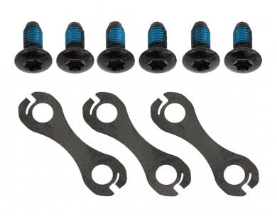

I used the old shims of my old Shimano Rotors, these raised up the magnet by a mill or two. The shims are the ones that sit under t bolts on Shimano rotors on old wheels. 1598342190158.jpeg

My magnet evens sticks out a little further than usual due to the Hope V4 rotor have slightly recessed bolt holes which means when you tighten the magnet down it bends the rotor slightly as the magnet puts pressure on the section of rotor between the two bolt holes and caues the rotor to rub on the pads in one spot
To fix this i found two washers that were slightly bigger than the recessed hole, i ground them down slightly so they fitted in to the recessed hole but they are thick enough that when you attach the magnet with the two washers behind it the magnet tightens down evenly without putting pressure on the section of the rotor between the two bolt holes and that stops the rotor bending slightly and rubbing on the pads
