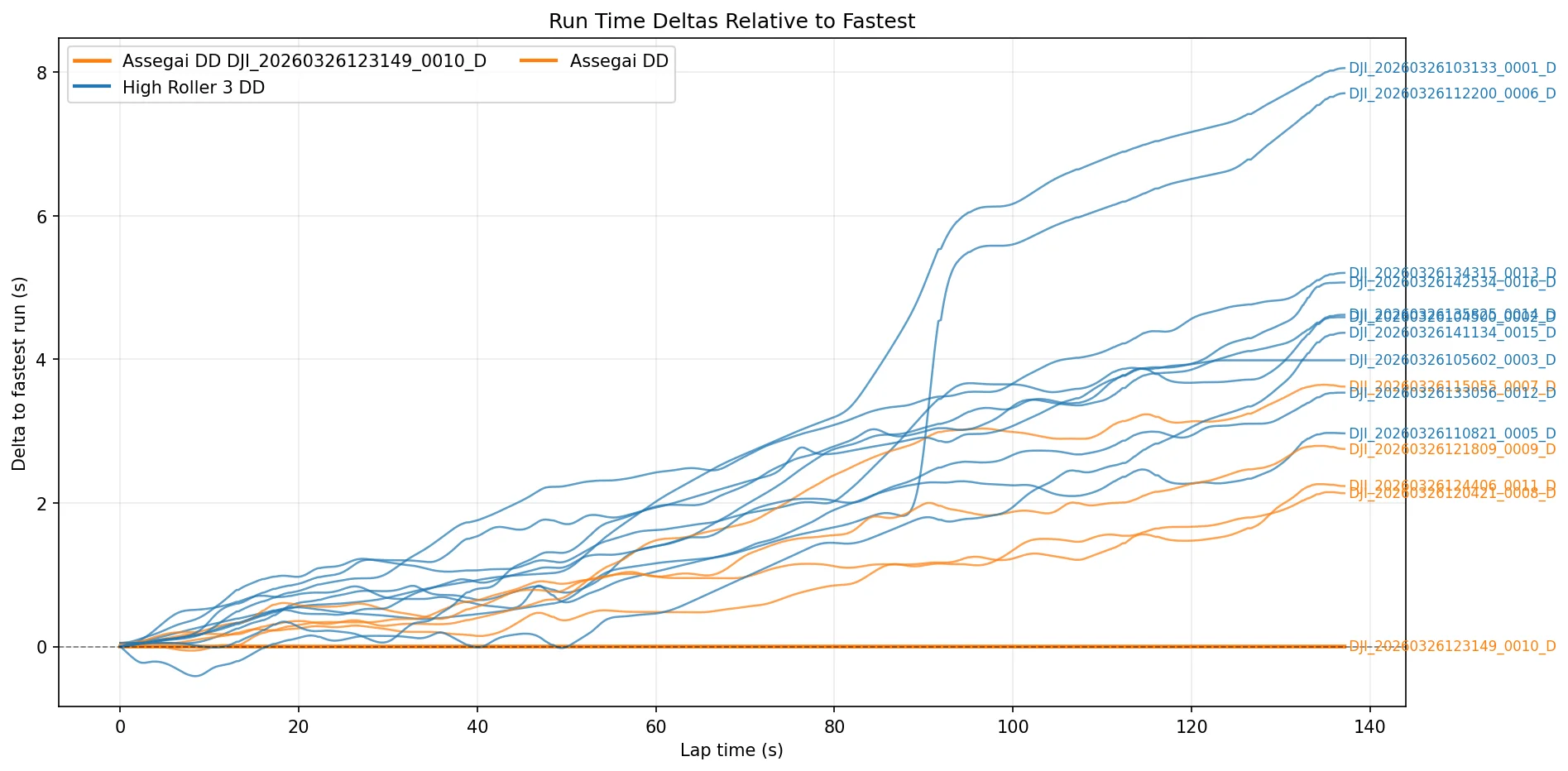

Penultimate test in this series. Very surprising difference between the High Roller 3 and the Assegai even when run with the same MaxxGrip compound and similar DD casing!
Let me know your thoughts?

Please post the summary here. What is your conclusion?
Sure, here's the TLDR:
This video presents a detailed performance comparison between the Maxxis High Roller 3 and the Maxxis Assegai as front mountain bike tires (0:18). Using 15 timed runs at BikePark Wales split into eight specific sectors, the creator, RoJo DH, evaluates how each tire handles varying trail conditions.
Key Findings:
Smooth Sections: On flowy, less technical parts of the trail, the two tires performed almost identically, with only a marginal 0.06-second difference (0:51-1:05).
Technical/Rough Sections: As the trail became more demanding, the High Roller 3 struggled, feeling less damped and more prone to being deflected offline compared to the Assegai (1:12-1:40).
Cornering & Confidence: The Assegai consistently provided more confidence and grip. The High Roller 3 caused stability issues when pushing the bike aggressively, leading to a significant time loss (1:56-2:28).
Final Result: The High Roller 3 finished 2.11 seconds slower than the Assegai (2:28-2:32).
Potential Explanations for the Performance Gap:
Tread Pattern: The High Roller 3 features a distinct channel between center and side knobs, lacking an intermediate transition zone, which may not suit the rider's style (3:45-4:01).
Tire Width: The High Roller 3 is a 2.4-inch tire, whereas the Assegai is a 2.5-inch model; the creator suggests wider treads may be performing better on this terrain (4:12-4:22).
Pressure: The test was conducted at 23.5 PSI, and the creator speculates that the High Roller 3 might perform better at lower pressures, though notes that the Assegai would likely benefit as well (4:22-4:38).
Skip to the end of the video for leaderboard of relative timings (I have always compared one tyre versus another, to make it easier to compare across days, rather than reporting absolute laptimes which will be weather dependent).
